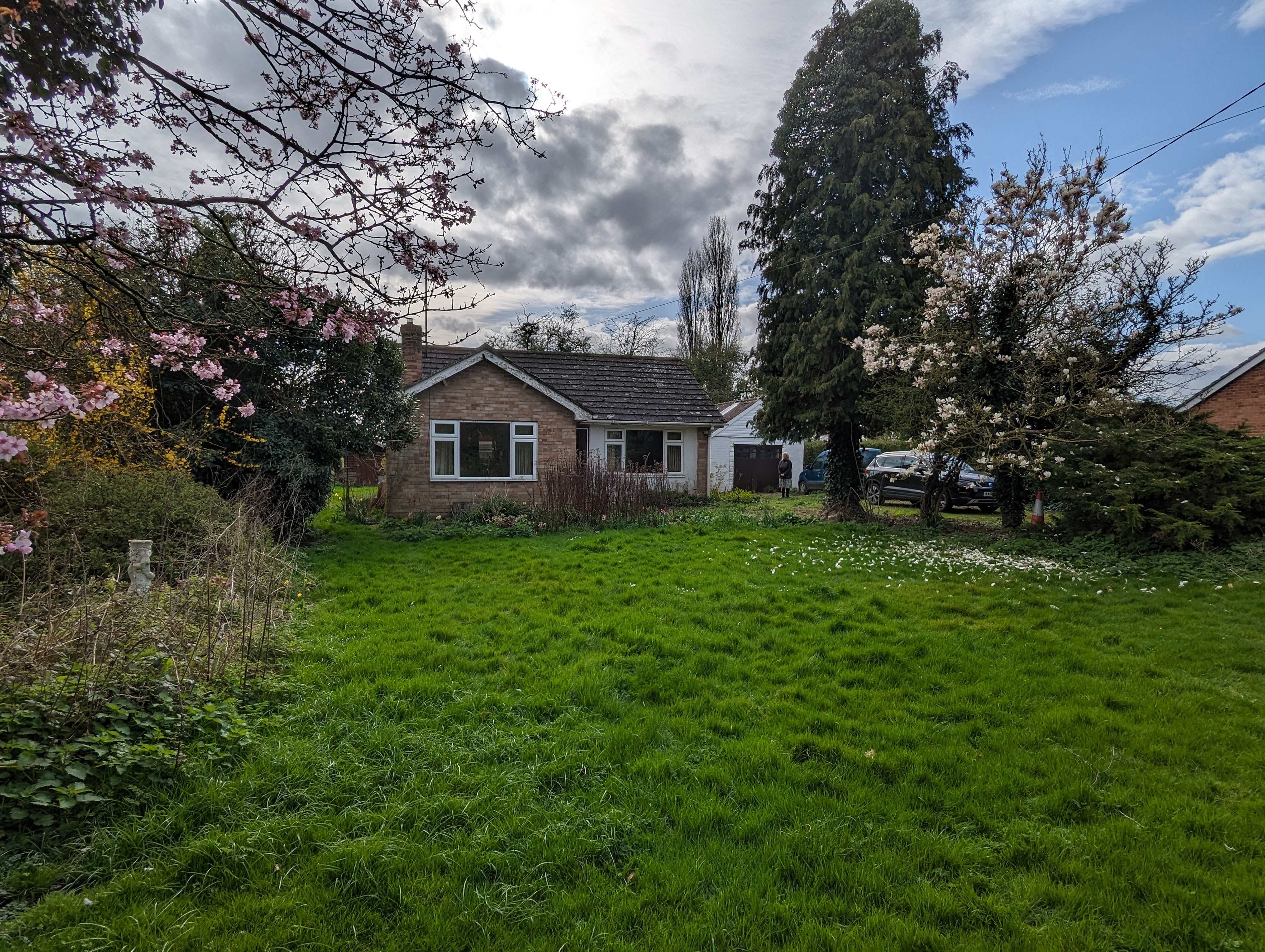

  5. A septic tank would be tempting as that is what's there now. I'm on one at my present house and the problem is that the water table gets very high over a wet winter and I think would be problematic.

  11. It's described as 1.5 floors but just over 8m high so lots of room upstairs. Lovely big plot so much better house for the location.

  13. No it's not Stones field but a lot of these bungalows are very similar. No time to lose!
