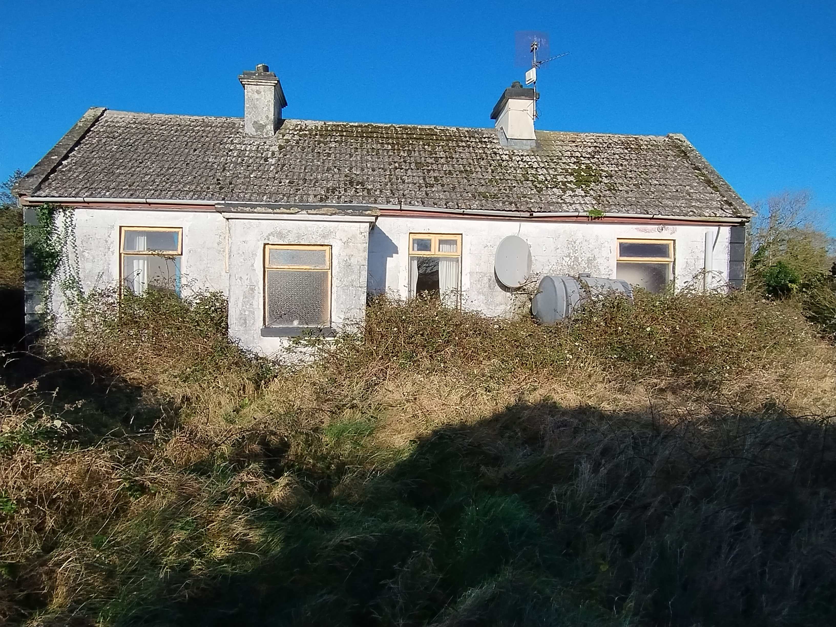

  14. Hi Everyone, I am just about to start on a renovation and extension project in Co Clare hoping to bring a 1920s land commission up to EnerPhit/Passive standard. The project is currently awaiting planning permission decision due next week and then its all systems go. Looking forward to learning from this great community best jason the pic is ground zero.....
