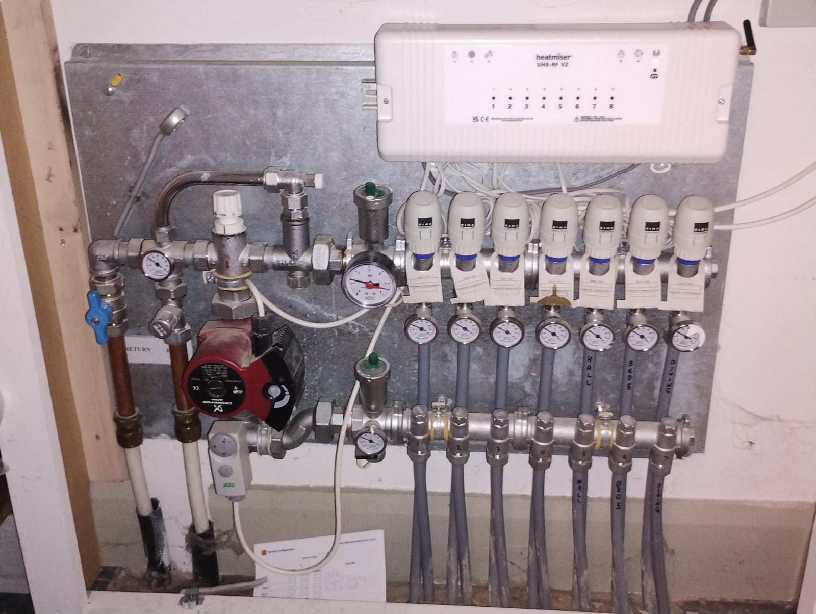

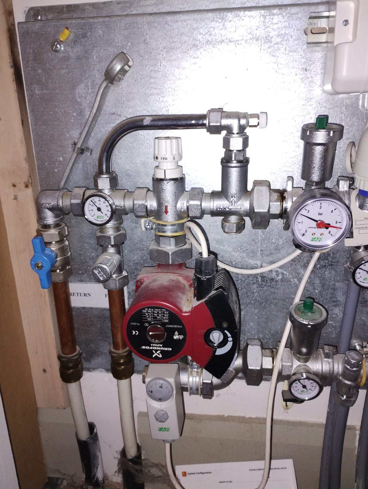

  2. Good morning all I have a UFH system, which was inherited when house was purchased. It was originally designed to run on oil but I now have an ASHP, which provides the hot water to the system. The system is run with Weather Compensation at the ASHP controller and although the system originally had multiple zones wired via Heatmiser UFH8 and neoAir room thermostats, the thermostats are all set way over target temperature so that they are always calling for heat and only the external air temperature is determining the flow temperature through the system, meaning a completely open system. There are 2 manifolds, one is around 2-3m of pipe run from the ASHP piping and the other is around 25m from the ASHP piping. My question is based on the difference in temperatures seen at the manifold compared to the flow temperatures at the ASHP controller. The photos I attach show the controller where the target flow temperature is 38C and the actual flow and return are 38/33 which looks fine. However, at the manifold with an open system, I would have expected to see higher flow temperatures and certainly no differential in the return temperatures between loops. What could be happening and how can I alter this? How with the flow temps at the manifold, is the ASHP controller showing 33C when the temps at the manifold are lower than this? It seems like the ASHP is doing what it is supposed to but something is not right with the UFH. Help appreciated

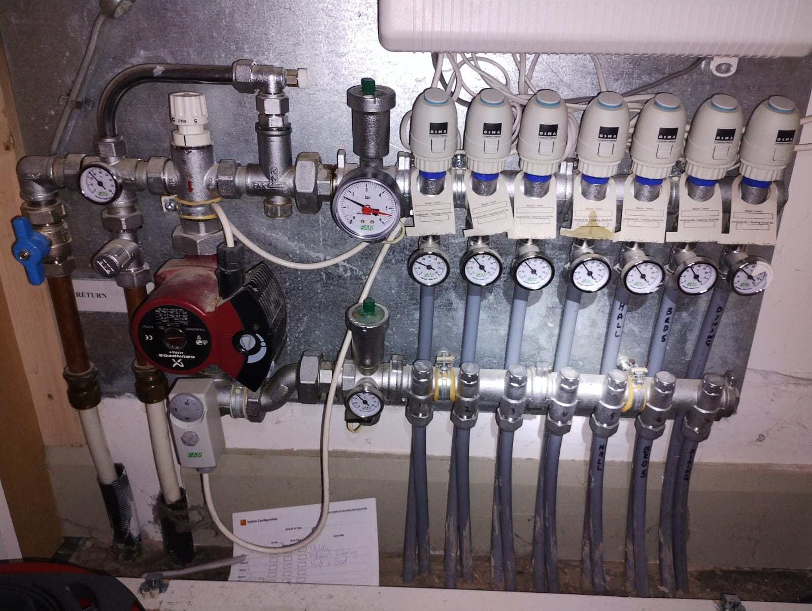

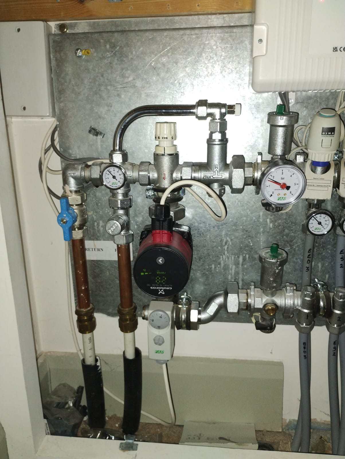

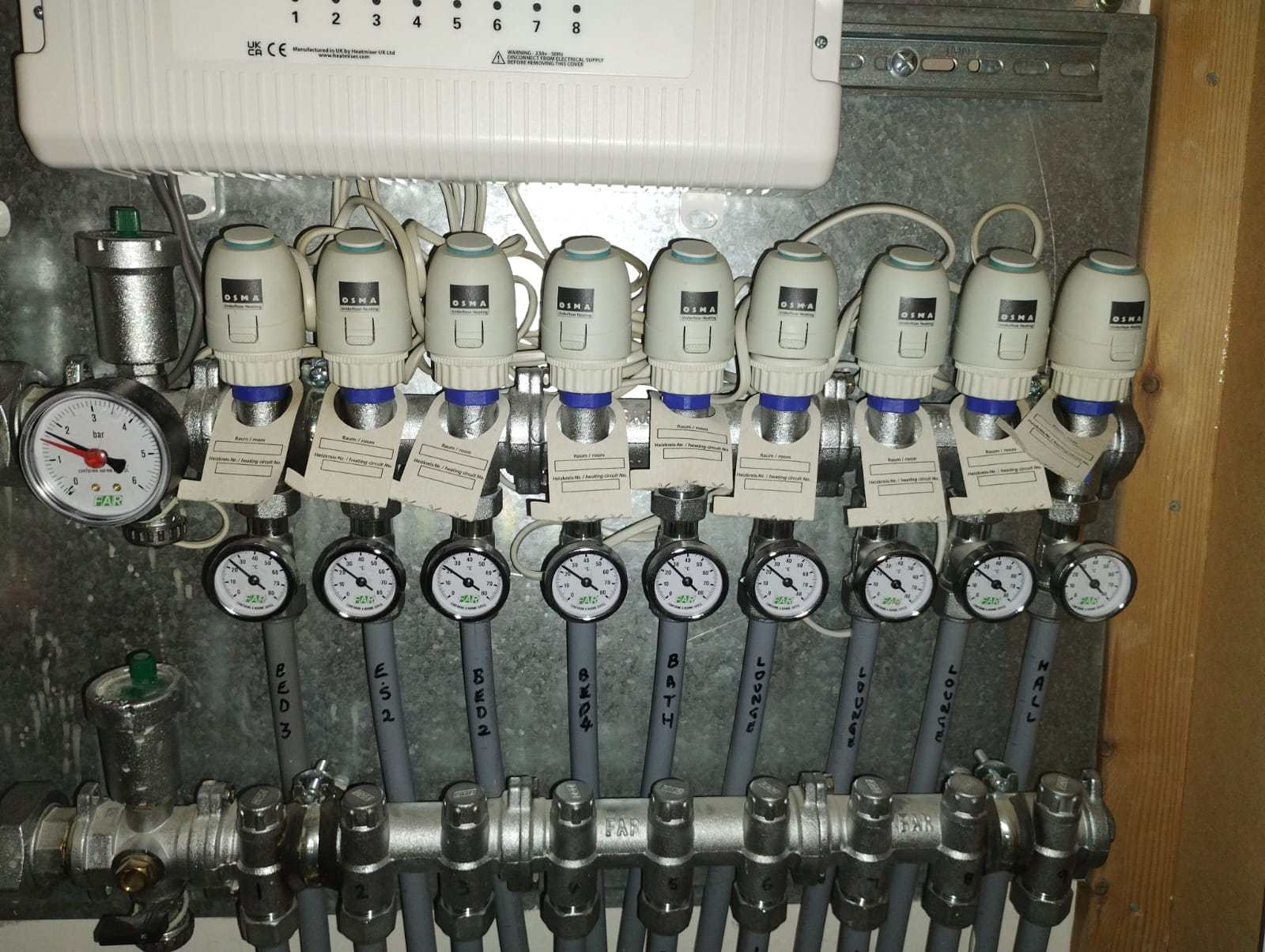

  4. Good morning I have UFH downstairs, rads upstairs and everything driven by an Midea 12 KW ASHP with 8.8 KW PV and 10KW battery. Following advice, the system is now on and fully open using Weather Compensation not individaul room thermostats, which is what I was using before. Internal Air Temperatures are slightly higher than desired (1-1.5C) in most of the house so I will do some tweaking to the WC curve in order to get that right. However, there are a few rooms where the IAT is higher than we want it by 3C and one room where it's at least 1.5C too low. It has been suggested to me that I can make adjustments to the flow rates at the UFH manifolds in order to correct this. I am looking for advice on how to do this (if it is indeed possible on my manifolds - see pic attached). I have seen videos online for how to do this but they are all manifolds with adjustable flow meters. Is it possible to do this with my setup and if so how? If not, would it be possible to add flow meters or are we talking about an expense that's probably not worth it. Many thanks in advance Pash
