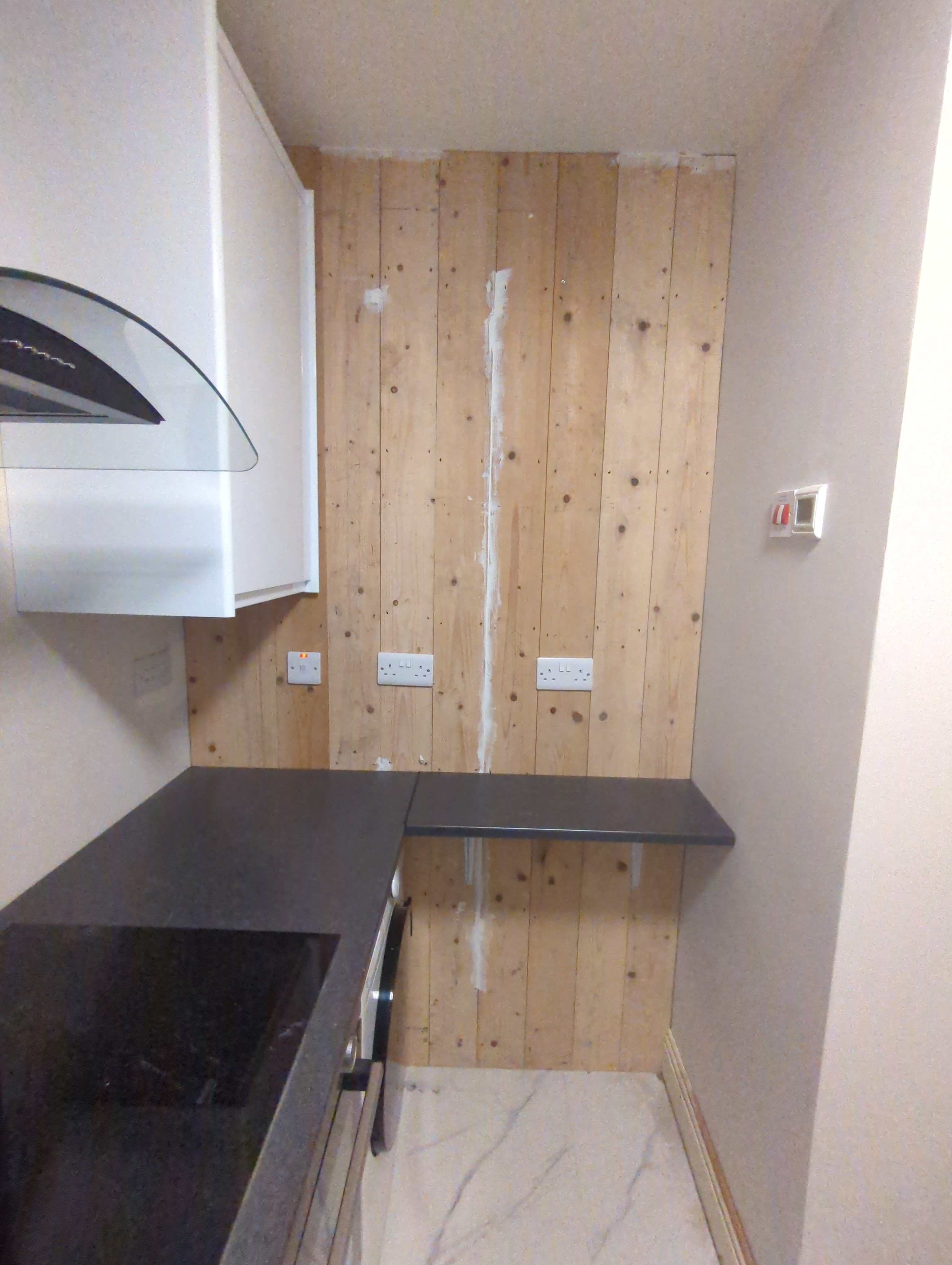

  1. What would you do to decorate this T and G partition. Just paint it? Would you match the colour of wall or go for something different? Would it need an undercoat first or just two coats of standard wood paint? thanks for any advice!

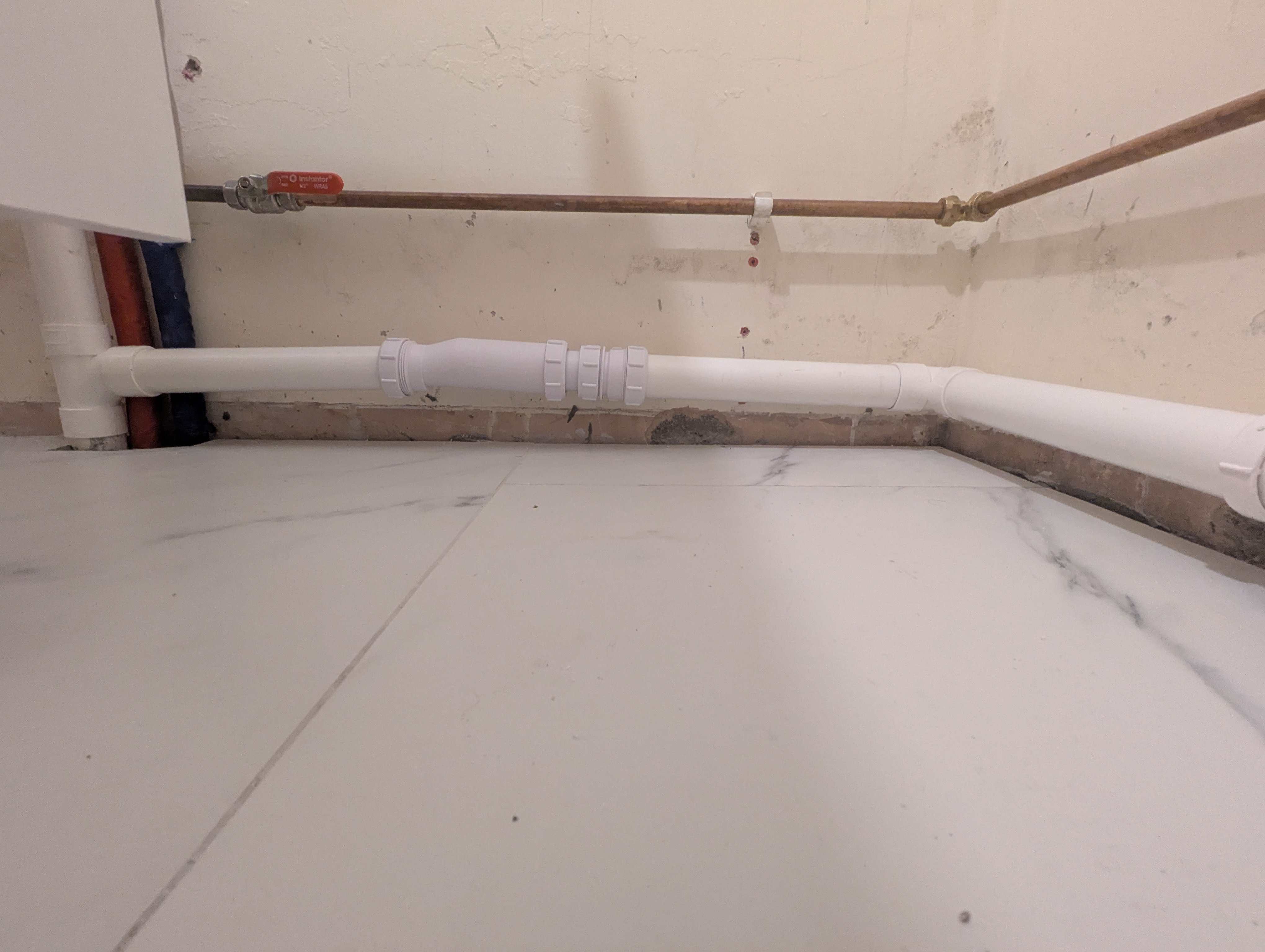

  3. I have to run a waste pipe from 2 washing machines low down to allow for kitchen units. See the pic. there is no room for a P trap so the plumber put a horizontal trap as in pic. To me it looks like there is a big hump where the trap is. Will that not create an issue? There is no fall into the trap from the pipe that comes from the machines. Or maybe horizontal traps need to be like this? It's the first time I've seen a horizontal trap. Does anyone know? He's an experienced plumber so would be surprised if he made an error.
