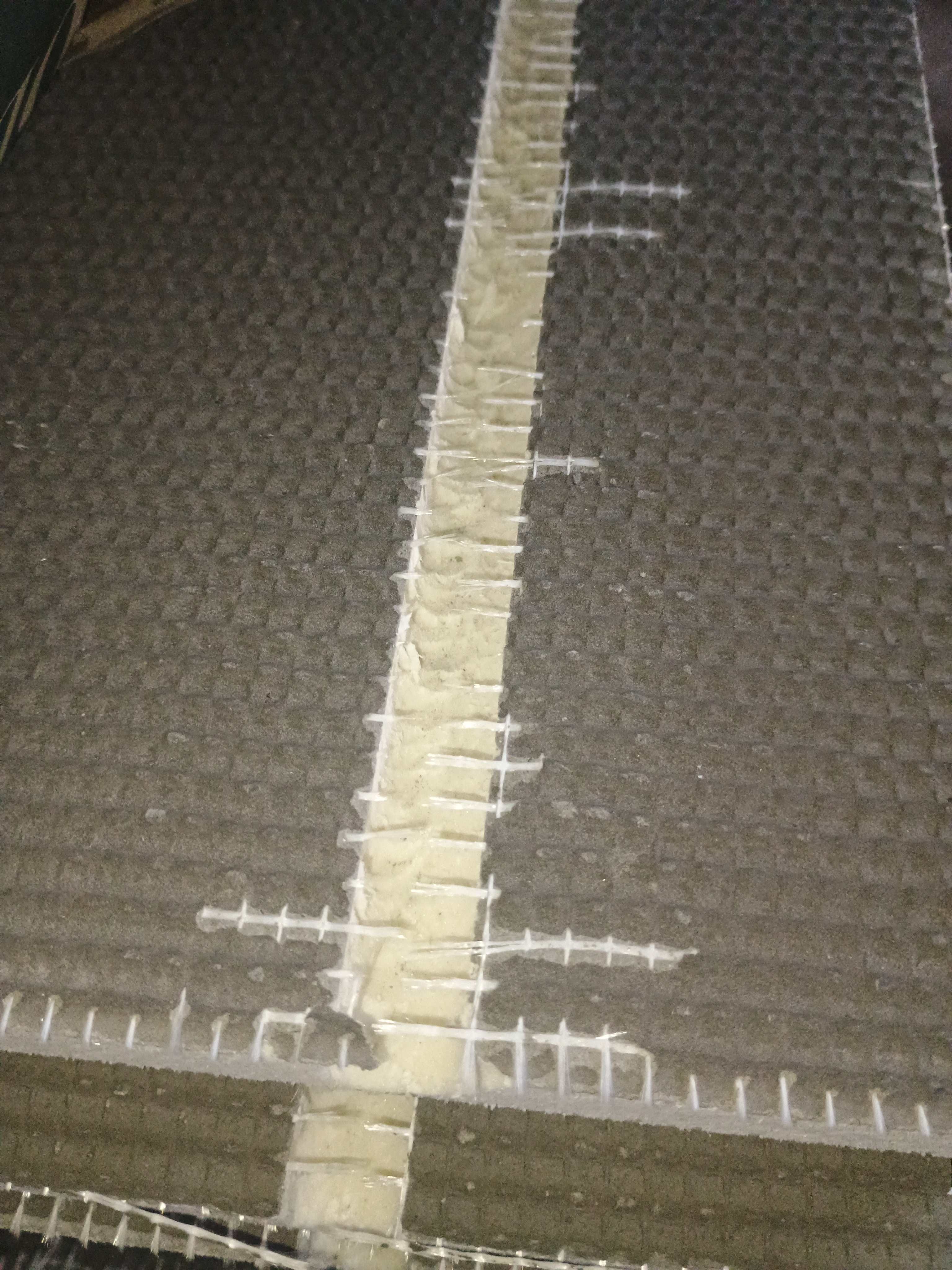

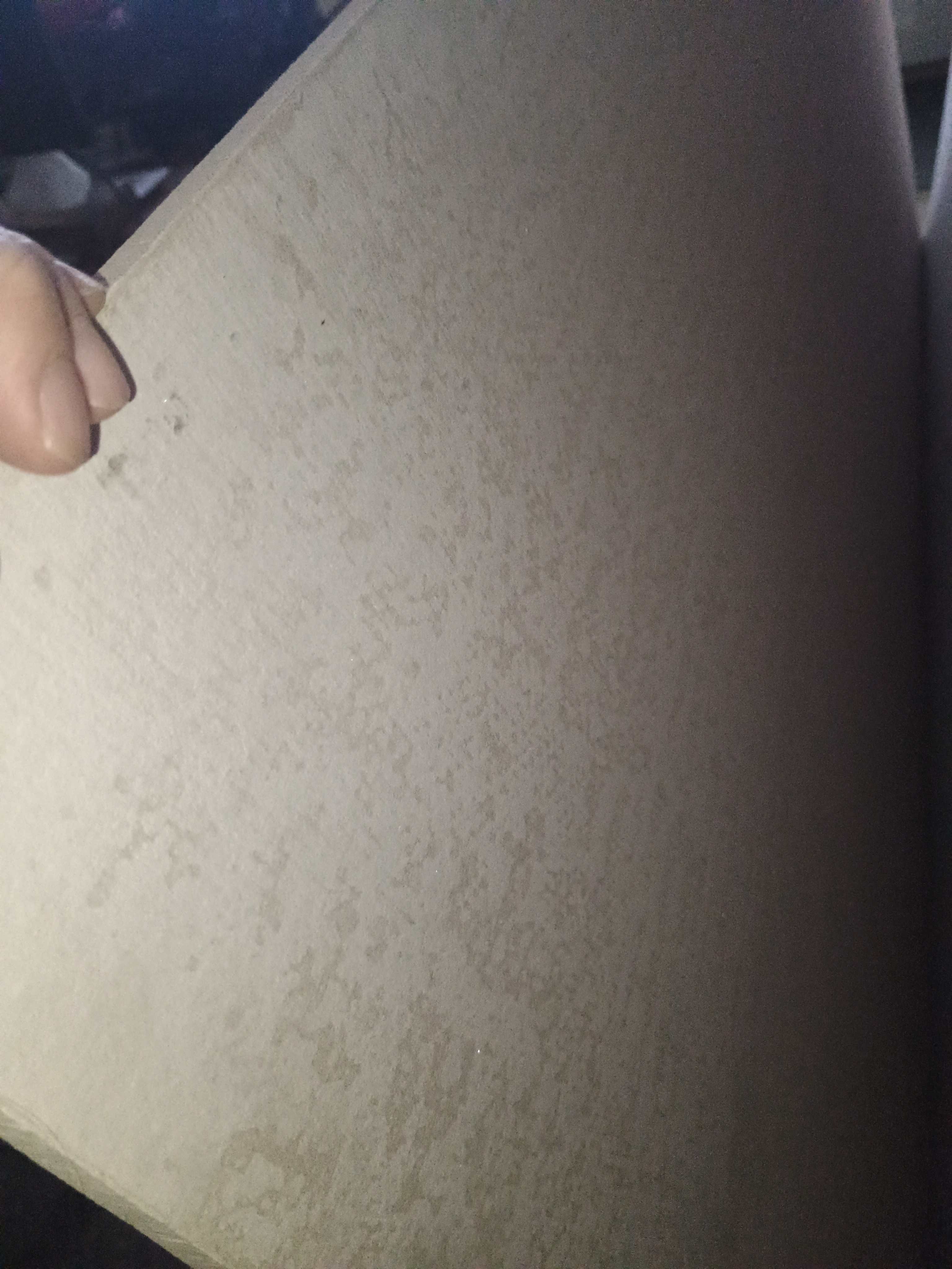

Can anyone recommend a product for bonding cementuious coated UFH overlay boards to cement board. The UFH boards are a raised square net reinforced light grey surface and the cement board is like a "no more ply" smooth finish one side and a slightly more rougher porous looking finish on the other. Might be wrong but I feel like a primer might be needed aswel? Which side of the cement board is best used? Looking for something that will bond them together exceptionally strong Many thanks for your recommendations
