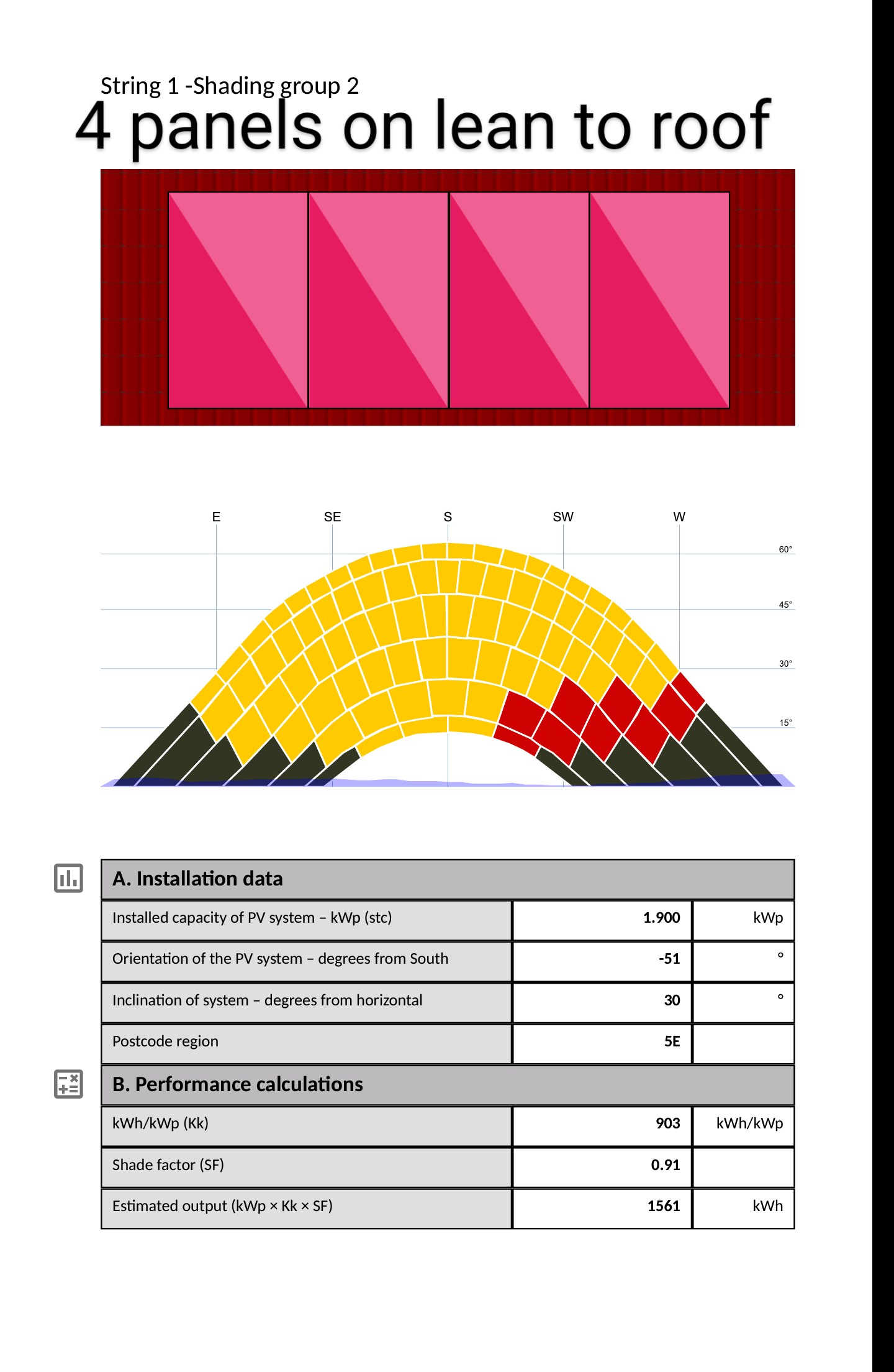

  5. Thanks all for your replies. I agree with many, three phase just seems to complicate the solar setup + the hosue, unnecessarily. Currently do not have any crazy electrical loads. However since it's a "forever" home, I am trying to future proof it. ASHP in the future + 3 phase EV charger etc. Installer has suggested putting all 14 panels on one string all with optimisers as the 4 panels that will get heavy shading in the late afternoon won't have enough start up voltage for the inverter so essentially become useless. The 4 panels are on a single storey roof facing SE and the double storey roof is immediately above it so when the sun is in SW/W it will be very shaded on the single storey area. If this isn't a good idea, please let me know, your opinions are welcome.
  6. Thank you for your reply. If ALL the panels were on the same string fitted with optimisers for each panel then it "should" negate the issue with the start up voltage right? This is what my installer is suggesting

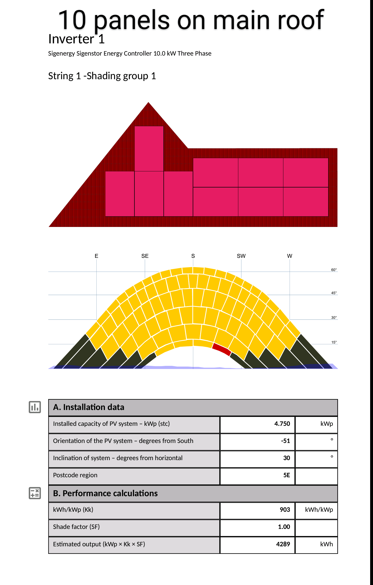

  8. Hey folks Looking for some advice on proposals I've received for my solar setup particularly inverter sizing. Proposal: 14 X Aiko Neostar 3S 475W N-Type, Mono Glass All Black, Gen 3 Panels (good panels?) - 4 of the panels are on a separate roof to the other 10 and are heavily shaded in the late afternoon/evening. Sigenergy battery - thinking either 8kWh to 10kWh for now. Not sure if going bigger makes financial sense based on my estimated usage really? We have 3-phase supply and plan to have it well balanced (new electrics going in as part of renovation). Estimated use is 4-5,000 units (not moved in yet, we are still renovating) for a family of 2 adults and three young kids, not including future EV charging for a car doing 10k miles a year, plan to charge overnight via the Grid. For 3 phase Sig energy inverter sizing; I've had conflicting advice with some installers recommending a 6kw, 8 kw, 10 kw, and even a 15 kw. Based on my basic research 8 kw seems sensible? Questions: What inverter size would you recommend for this kind of setup considering it's 3 phase? Would 8kW be sufficient, or is it worth stretching to 10kW? For the 4 panels that are shaded, some have recommended optimisers whilst others have said not to as they go "wrong" over time - thoughts? Roof is SE facing pitched at 36 degrees. Appreciate your insights!

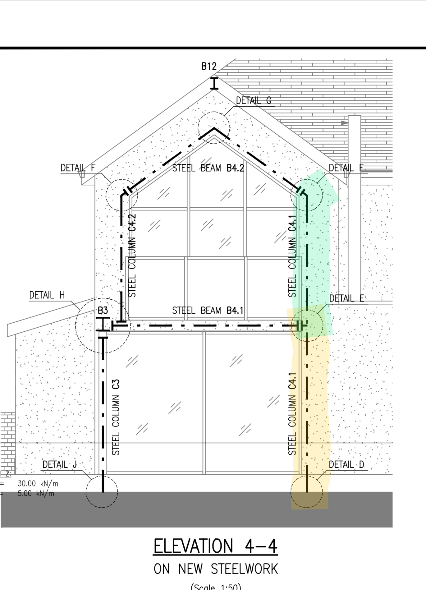

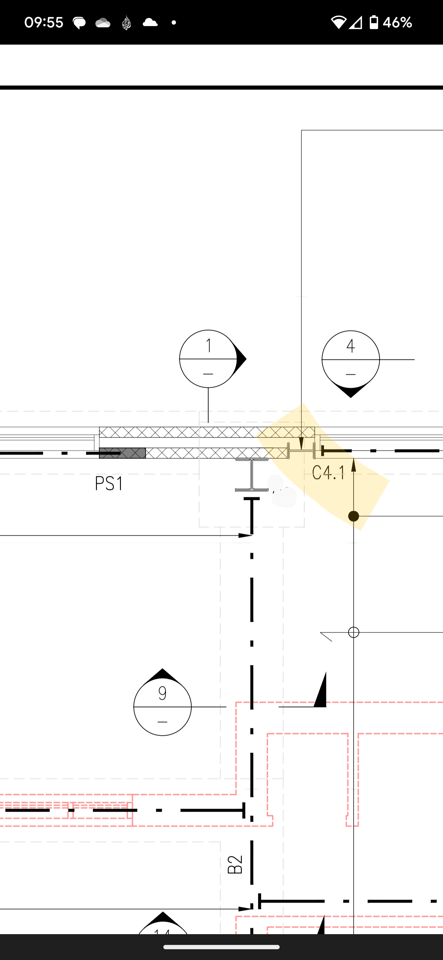

  12. Hi guys, My engineer has specified wall ties for a steel column (C4.1) in his drawings attached. He has specified wall ties from this column to the inner skin (which we've done) and from this column to the outer skin also (which we haven't done by mistake). So there are no ties from the external skin block work to the steel in this section only. There are wall ties in the rest of the cavity wall (inner/outer leaf) as specified. C4.1 is about 300mm wide and 100mm deep. We haven't built the next storey up (highlighted green) and will make sure correct ties are used when we do. Is this a major structural issue? Have messaged my engineer and am awaiting a response. Anyone with more experience care to share their thoughts to hopefully ease my nerves. Glazing not currently fitted - so can access the cavity from the side. Could I get some sort of straps to ties to fix from the side? Thanks! P.s posted this in another section but thought this section might be more relevant.
  13. Hi guys, My engineer has specified wall ties for a steel column (C4.1) in his drawings attached. He has specified wall ties from this column to the inner skin (which we've done) and from this column to the outer skin also (which we haven't done by mistake). So there are no ties from the external skin block work to the steel in this section only. There are wall ties in the rest of the cavity wall (inner/outer leaf) as specified. We haven't built the next storey up (highlighted green) and will make sure correct ties are used when we do. Is this a major structural issue? Have messaged my engineer and am awaiting a response. Anyone with more experience care to share their thoughts to hopefully ease my nerves. Thanks!
