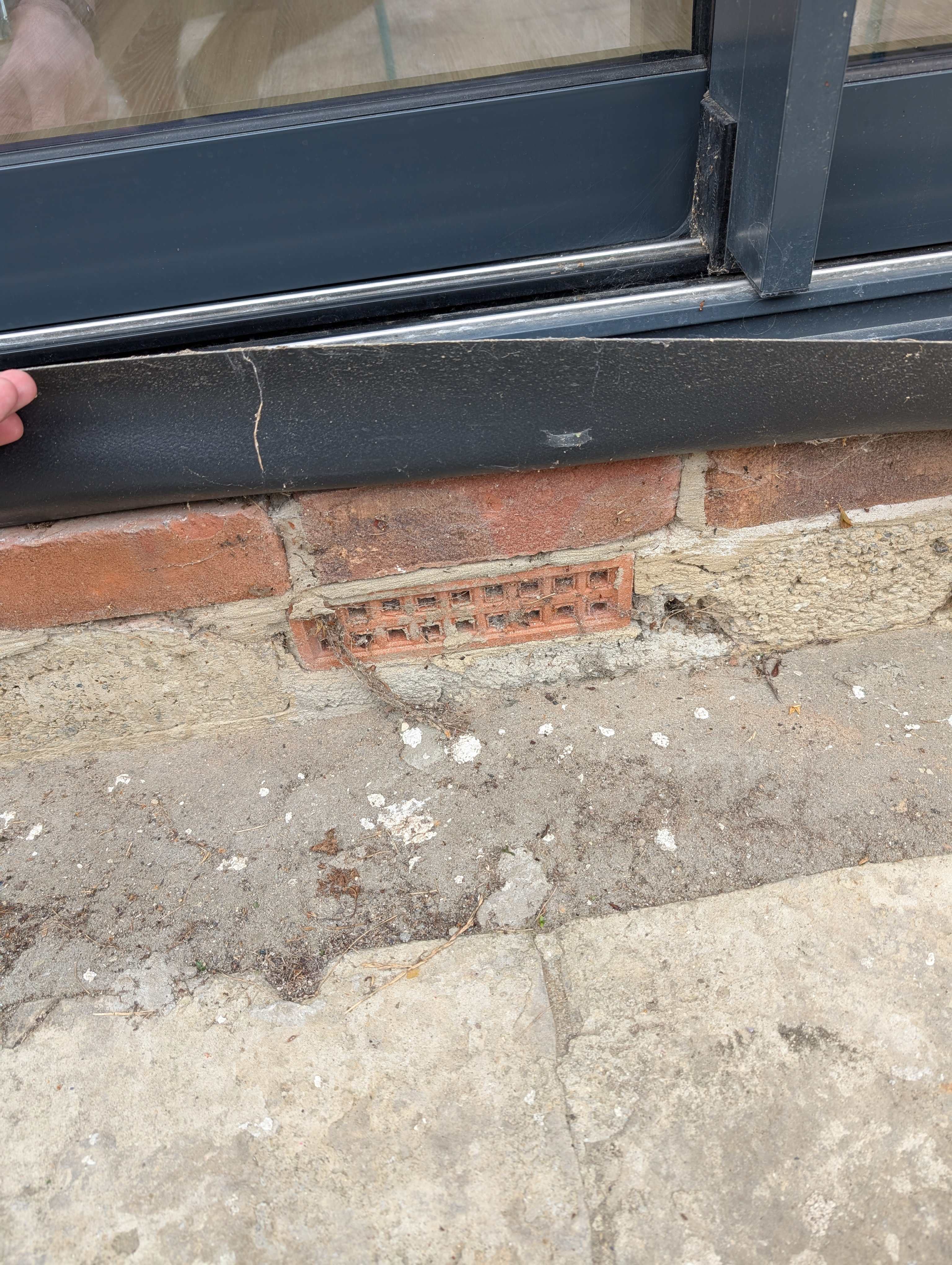

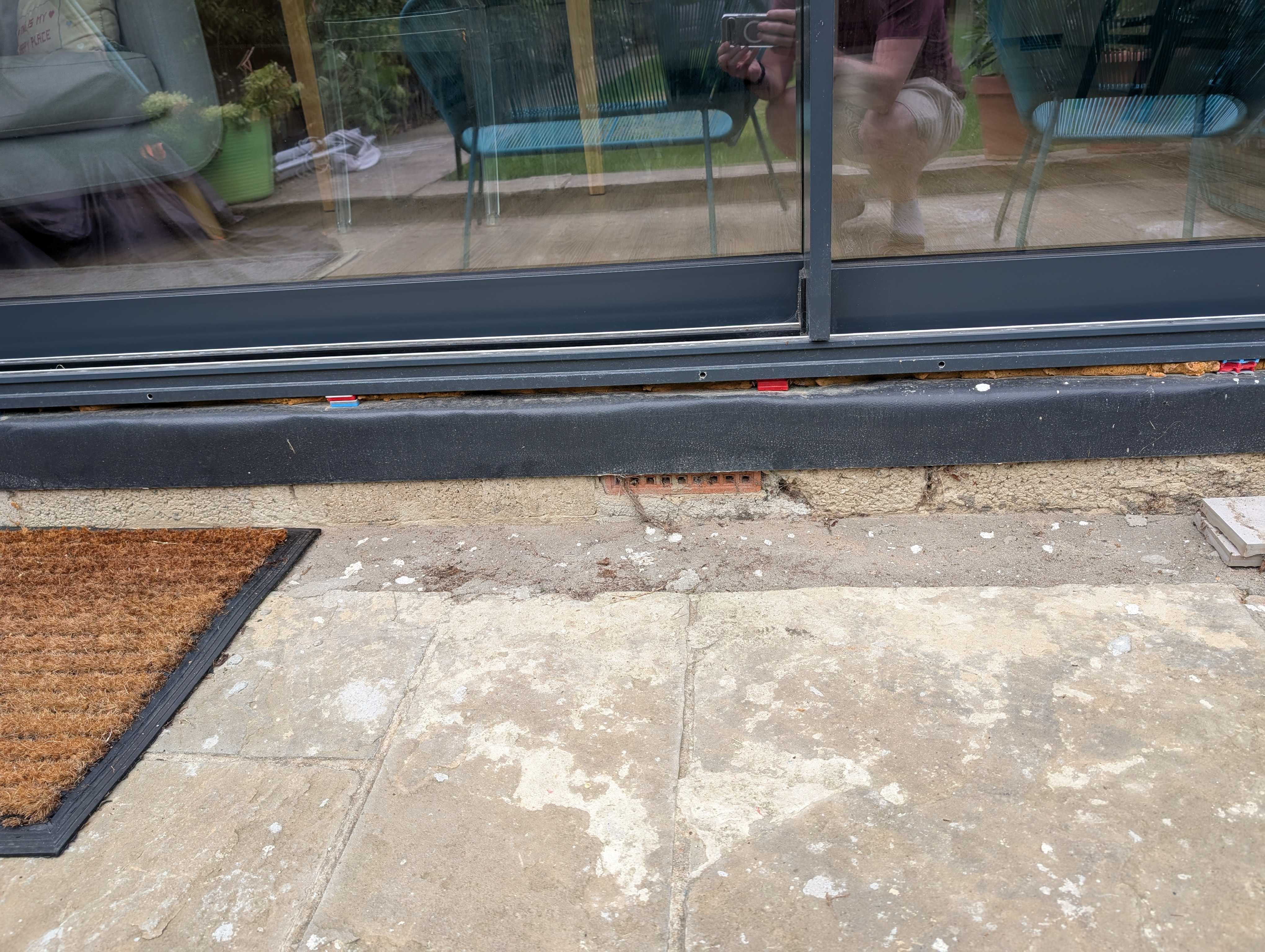

  3. We have had a new extension and would now like to put a new patio that is level with the threshold of our sliding doors. There are air bricks fitted underneath the new sliding doors - These go through ducting in the extension to the front of the house (There are additional air bricks at the front of the house). Is there a solution that would allow me to fit a patio whilst not blocking these air bricks? I would need to install a drainage channel along the front of these doors as well. My simple solution would be to use a hi-slot drain channel then cut a slot to allow ventilation - Obviously the biggest risk here is water from the drain flooding the air brick, but the slot would need to be so high that this wouldn't happen. I'd appreciate any other ideas that you might have
