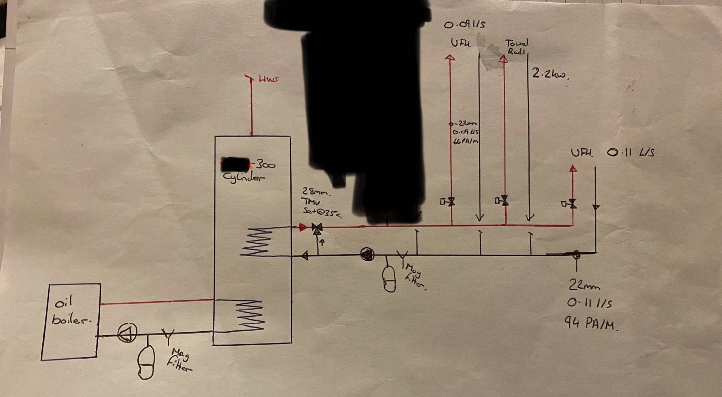

New Member (2/5)

  1. The buffering would be in an unvented cylinder. i looked at the maxipod but all open vent and I have no option for this in the house
  2. Weather compensation on an oil boiler?
  3. So a thermal store means I need to heat water to 70deg to get hot water plus I would have no storage. i also struggled to find an unvented thermal store. If my calcs are right at max demand the flow rate will be 14.45 litres/min. with a return temperature of 25deg and flow temp out of the coil at 55deg and a mixed flow of 40deg I would need the cylinder to heat 7.2 litres/min from 25 deg to 55 deg. at a 35deg mixed temp I would need 45deg from the coil at 7.2 litres/min
  4. Total ufh load 8kw across 20 loops ufh flow 35 return 25 if the top coil was rated at 40kw based on a 80deg how would I work this back to know if it would work with a 60deg storage temp
  5. Hi John, I believe on initial start up the ufh will strip all domestic hot water though when up to temperature though I expect this to be ok when running. The boiler will be controlled through the cylinder stat to keep the domestic hot water up to temperature 24/7 As for coil placement I was thinking boiler coil at the bottom of the cylinder to help with de stratification and then a high gain could towards the top. with blending on the flow only the heat required to bring return up 10deg will be extracted from the cylinder. I know someday I may have to go heat pump but I don’t believe they are the answer just yet. oil boilers are simple and work compared to heat pumps. Thanks
