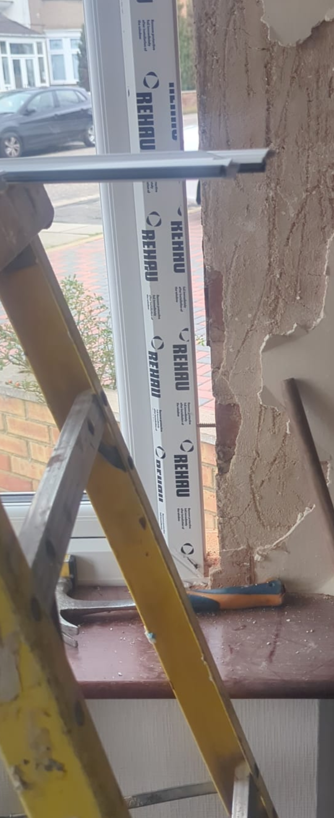

  1. Hi people so he came over the owner. He said one inch gap is acceptable . He said for him to change the end frame he will have to take the entire window out. I thought he could just remove the end frame which is screwed in to the metal support pole and wall ?????
  2. I know it's a Mick take . They did foam it all properly but should have added pvc extenders
  3. I will send pics as requested !
  4. Nick from Wales should there be packers?
  5. people I need some advice so I had new upvc windows fitted in my entire house. I have large curved bay window downstairs living room and upstairs bedroom . My old windows were aluminium and had a wooden frame on the edges . So I had my windows fitted and I noticed on both bay windows on the ends there was a gap of a inch between window and brick I have attached an image . When I question the company the owner said this is normal as when measuring he would have not know how much brick behind the wooden frame on the old windows on the edges . Is this correct ? Since having these windows installed alot of noise issues and cold !
