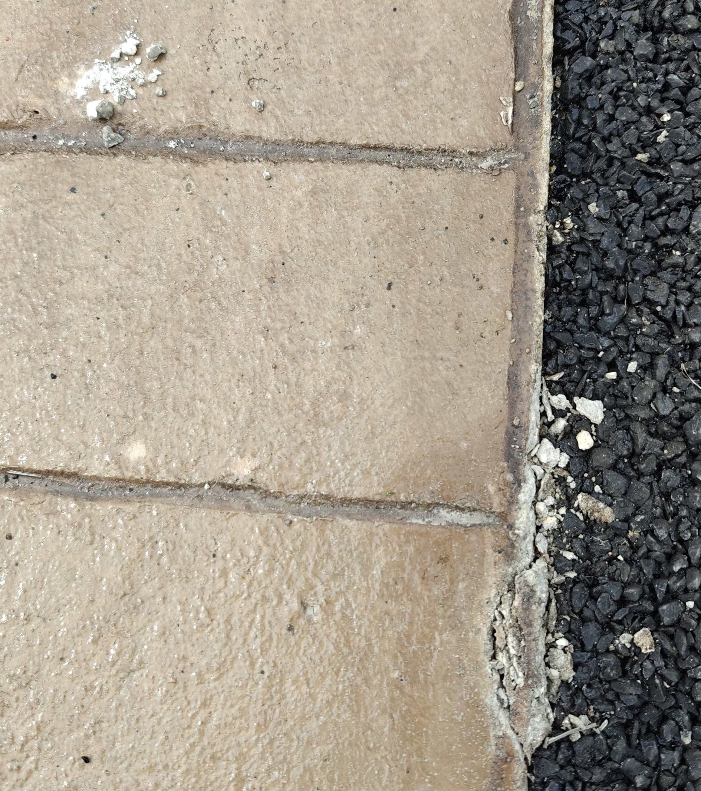

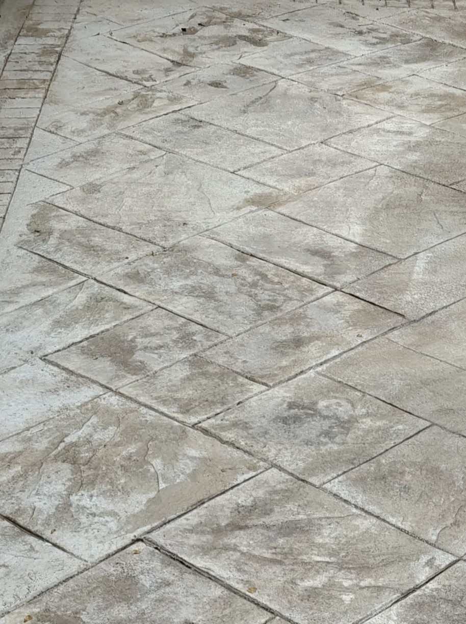

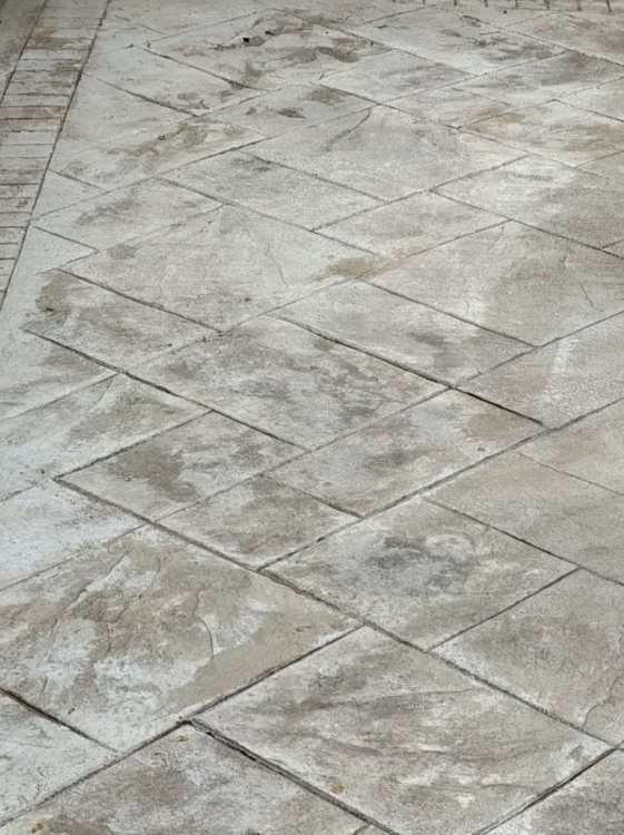

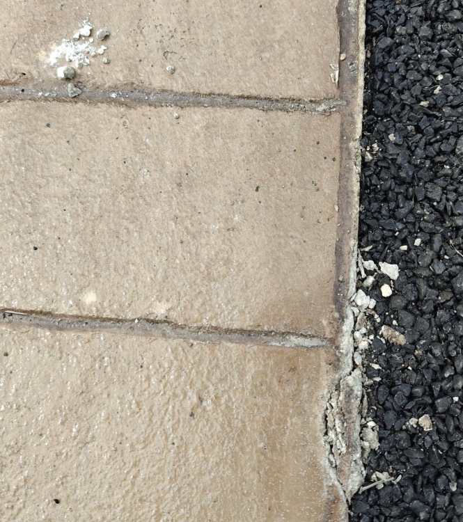

Thanks for your help guys. So below is what it looks like right now. The first photo shows the colour being washed out and you'll notice the tile pattern missing from some locations. The second photo show the concrete has broken at the edge after a vehicle was driven onto it, -

Hi everyone. I'm hoping someone can help me. Due to work I've been abroad for 6 months. I returned to find that my grandad has very recently had our home driveway done with imprinted concrete by some so-called driveway experts whom knocked on his door to offer their services. But within a week of the driveway being laid, the most of the colour has washed away. I've tried to contact the guys that laid the concrete, but they've turned their phones off. Grandad had got it done with his hard earned savings and paid thousands for the job. He thought it would be a nice surprise for me when I get back we've got a number of vehicles that we use. He's in bits as he knows he's been scammed. We've been in touch with the law and that's being dealt with separately to see if we can get anything back. But I want to specifically focus on what I can do to get the driveway to look better without costing the earth. Currently it looks like absolute crap (sorry for my language). The attached photos were taken by a family member about 5 days after the concrete was laid. The shiny part is where they used the sealer. I tried use some sealer which the cowboys had left behind on small patch of the concrete to see if the colours would come back, but sadly this has not made any difference. As of today (around 2.5-3 weeks later), a considerable amount of colour has washed out and the bare concrete can be seen. I would be most grateful if any kind soul can help advise if there is anyway of fixing this. Thank you for your help.
