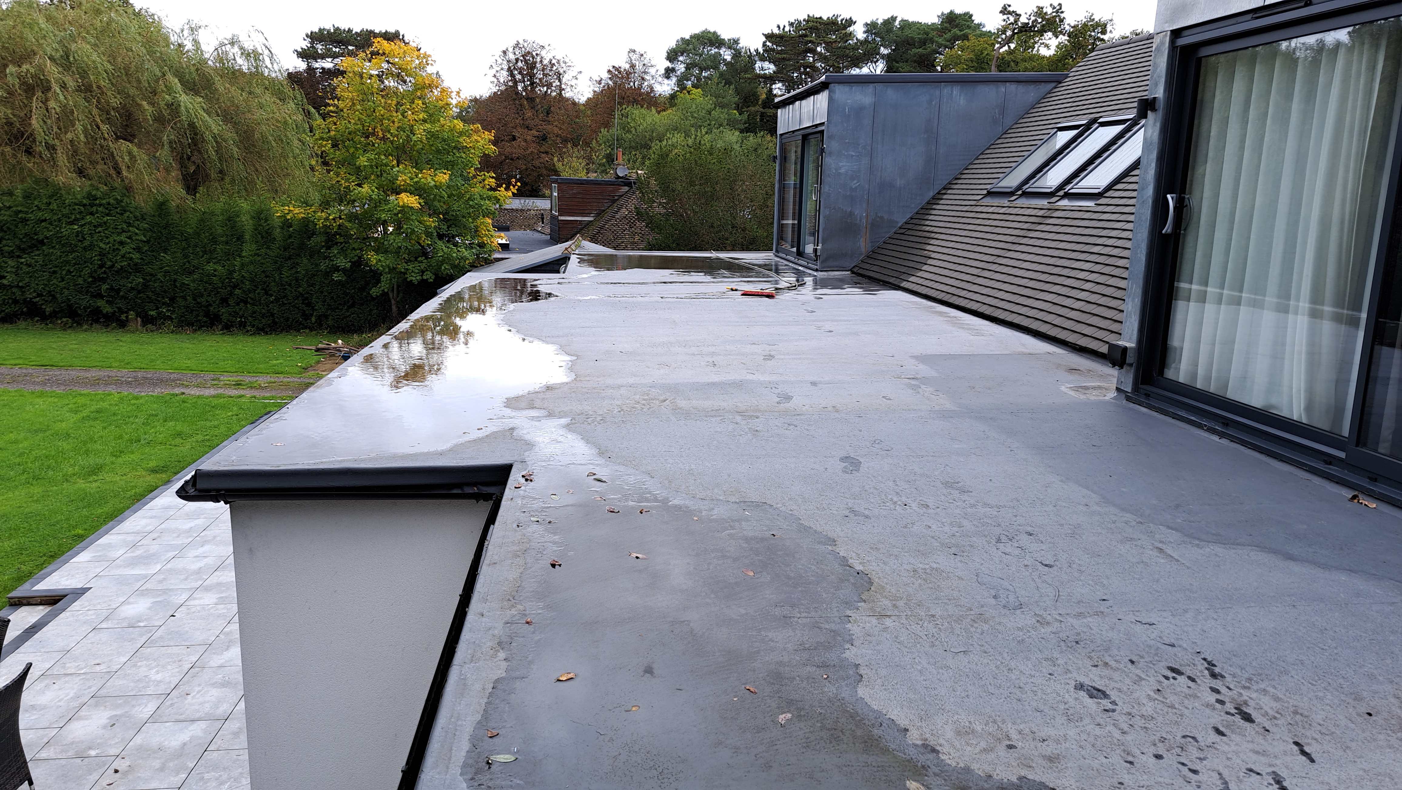

  2. Hi, still looking into the finer points of it for install later this year. ATM we are looking at a balustrade with posts every 1.2m and the fixings being integrated into the deck renovation. The balustrade company we are working with does what they call 'waterproof fixings' which are an extra bracket fixed onto the deck that the posts then fix onto (rather than the bottom of the post fixing directly the deck). My roofer then thinks if he paints a rubber or GRP solution over the top of it all and laps it up the posts for a couple of inches it might be good for a few years but he said its unlikely they will be able to give me warrantee for that part of the roof install. In the event of a leak im trying to get the decking part of the terrace modular so if a leak is seen we can remove part of the deck hopefully reseal it with more rubber. This seems to be the most robust way of doing it but im still very much open to ideas?
  3. Thanks for the responses. A parapet wall has been briefly discussed but I think got dismissed because of the nature of the drainage from such a large roof. All of the water would have to go under or along the inside of the wall in a gully and out of the sides of the house. Seem to remember the guy I spoke about it with thought it would be to much of a re-design? Has anybody successfully installed a balustrade (of any kind, we arent just looking at frameless glass) directly onto a flat roof? THanks

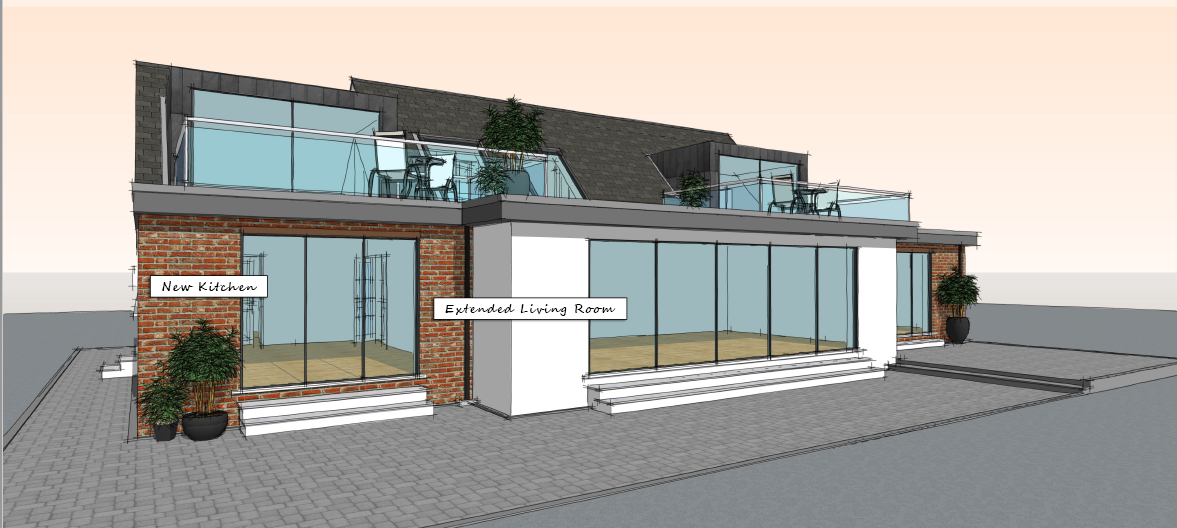

  4. Hi all, After some advice/ideas. We have a large flat roof section at our house with 2 large full height dormers able to directly access it. Please see photo. We renovated the whole property a few years back which included the dormers and flat roof and it was always the intention (planning permission was approved) to fit a balustrade and decking to turn the space into a terrace. Time and money got away from us and we are only now getting round to the project. We also have the issue of a poorly installed GRP flat roof which will be renovated and likely relaid with GRP again, this time with the appropriate fall on it and GRP which doesnt flake off (cheers original contractor). Issue is - everyone im talking to (Roofers and Balustrade suppliers) seems to have very different ideas about what the best solution is and now im totally confused. We had originally planned for a frameless glass 'U' shape balustrade to feed back to the dormer sides with a floating composite deck. Seems to be 2 camps of flat roof Balustrade installer. The 'never penetrate your deck' ones and the 'its fine if done properly' ones. Have been told recently that frameless glass is probably not appropriate as the run along the edge of the roof is 16 meters and the wind could do its work over a shortish spell to 'loosen' the fixings underneath the glass channel by buffeting the long glass section (and eventually causing a leak through the loose fixings). The chap said he would advise only doing frameless if you could fix directly to steel (which we do have but they are about 20cm down under the deck. Have also been told that side of house fixings probably not an option due to that area being where the guttering is. Another contractor has told me that he will do the frameless but it needs to be fitted 'flat' on the deck ie not following the fall of the deck and propped up blocks. The blocks would be approx 4 inches high to maintain the flatness across the deck! Have seen pictures of a previous install and it doesnt look good. Surely you can install a Balustrade flush to the deck angle?! What do you think? At the moment the favourite is still to penetrate the deck with posts that are 'done properly'. Any advice or ideas would be well appreciated! Cheers G
