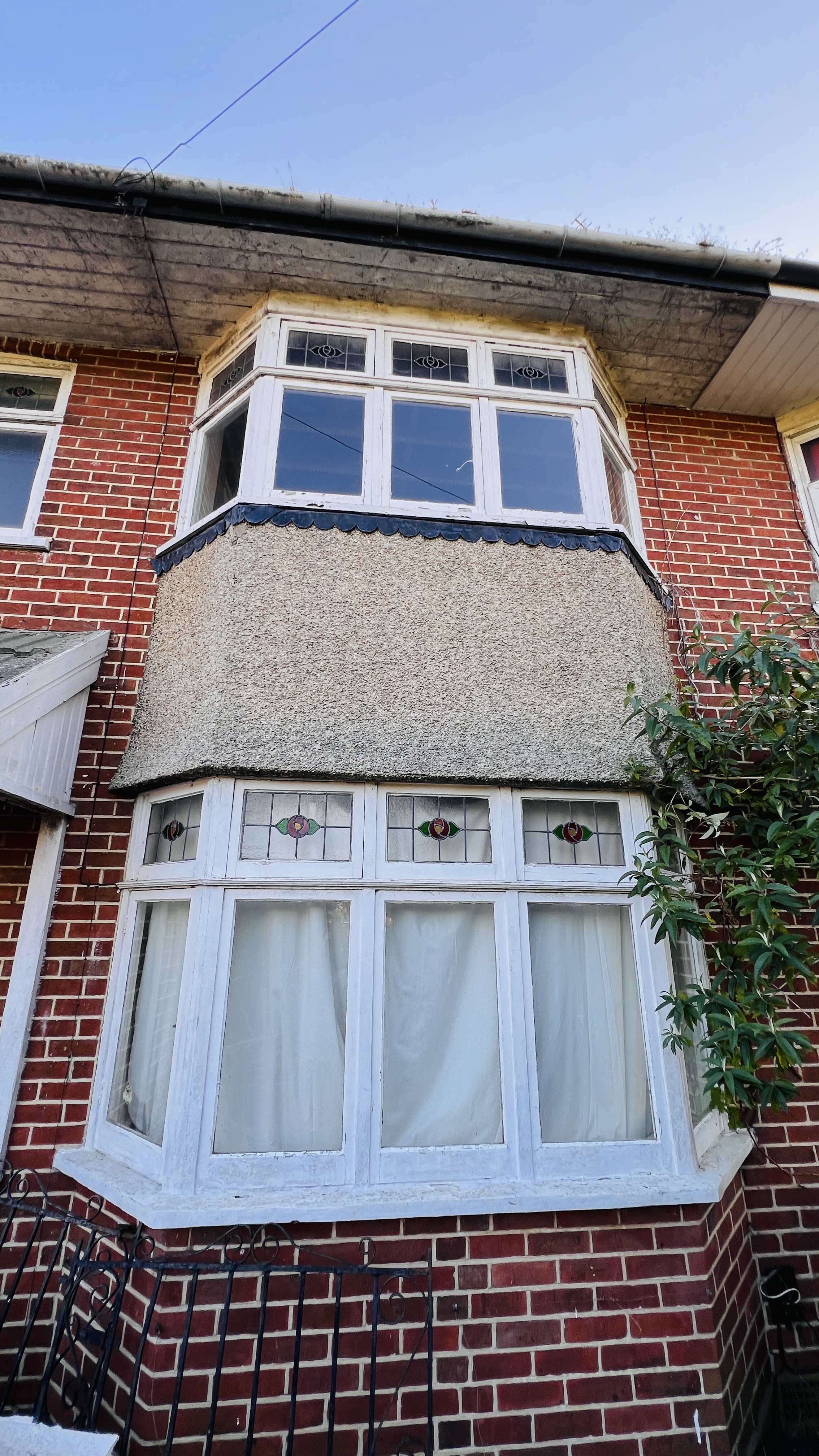

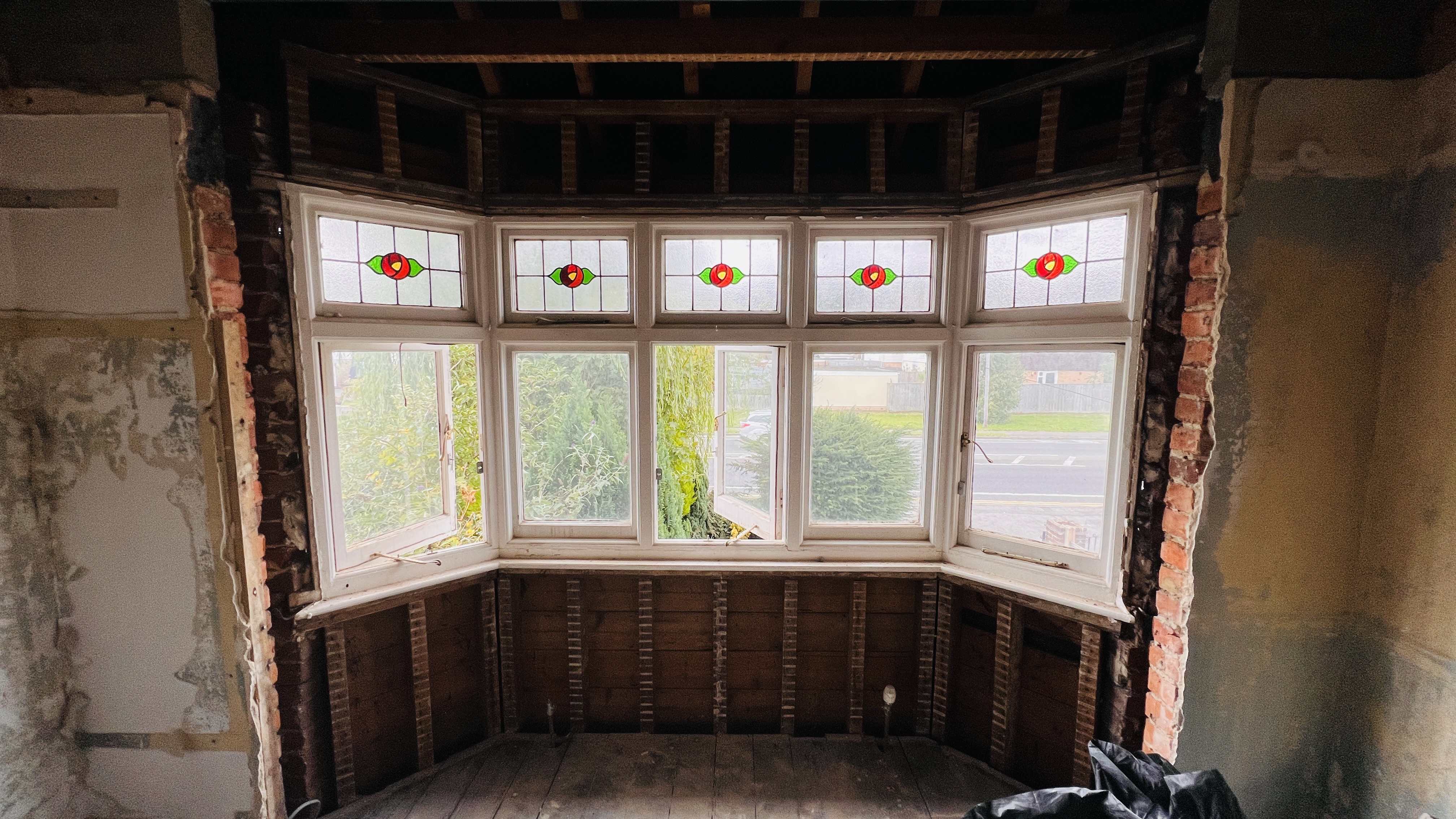

So I’m currently renovation a 1930’s semi. The bay window was not insulated and constructed of lathe and lime plaster internally on 4x2 studs with timber boards wrapped in some sort of plastic and pebbledashed over externally. I wanted to improve the thermal insulation in the bay wall and also improve the acoustic performance due to the noisy road while I was at it. (I know the large window is the main cause of the acoustic transmission but we are having new windows installed and I wanted to try to improve all parts of the bay). So I stripped the plaster off and was planning to fill between the studs with rockwool rwa45 for acoustics and then overboard the studs with a PAR board for thermal insulation. This was before I actually done a lot more research and found out that lime plaster was far better than gypsum products for acoustics even with the rockwool batts. But hey ho we live and learn. So now the problem is that upon doing more research it appears I may now also have a problem with interstitial condensation as if I insulate the bay, even with a vapour barrier some vapour may still get through and then it has nowhere to go as it’s my understanding that pebbledash is not breathable. So I’m worried if I do this I could end up causing the studs to rot. Does anyone have a solution or advice for this situation? The only thing I could think of was replacing the pebbledashing for hung tiles which in my opinion would look better but I’m a bit reluctant to do that as the pebbledash appears to be performing well in terms of keeping the damp out currently, the studs are bone dry, and I feel that tiles would be an even bigger downgrade in terms of acoustics with all of the little gaps everywhere. Anyway anyone’s thoughts would be much appreciated. Thanks in advance.

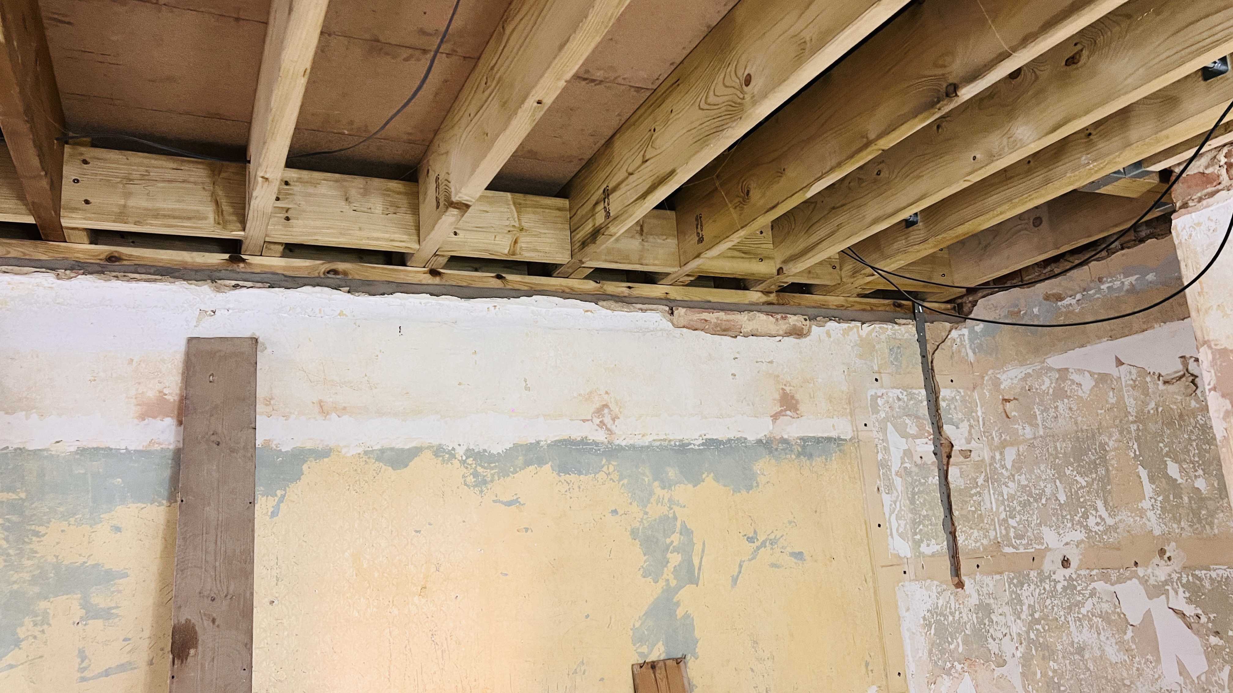

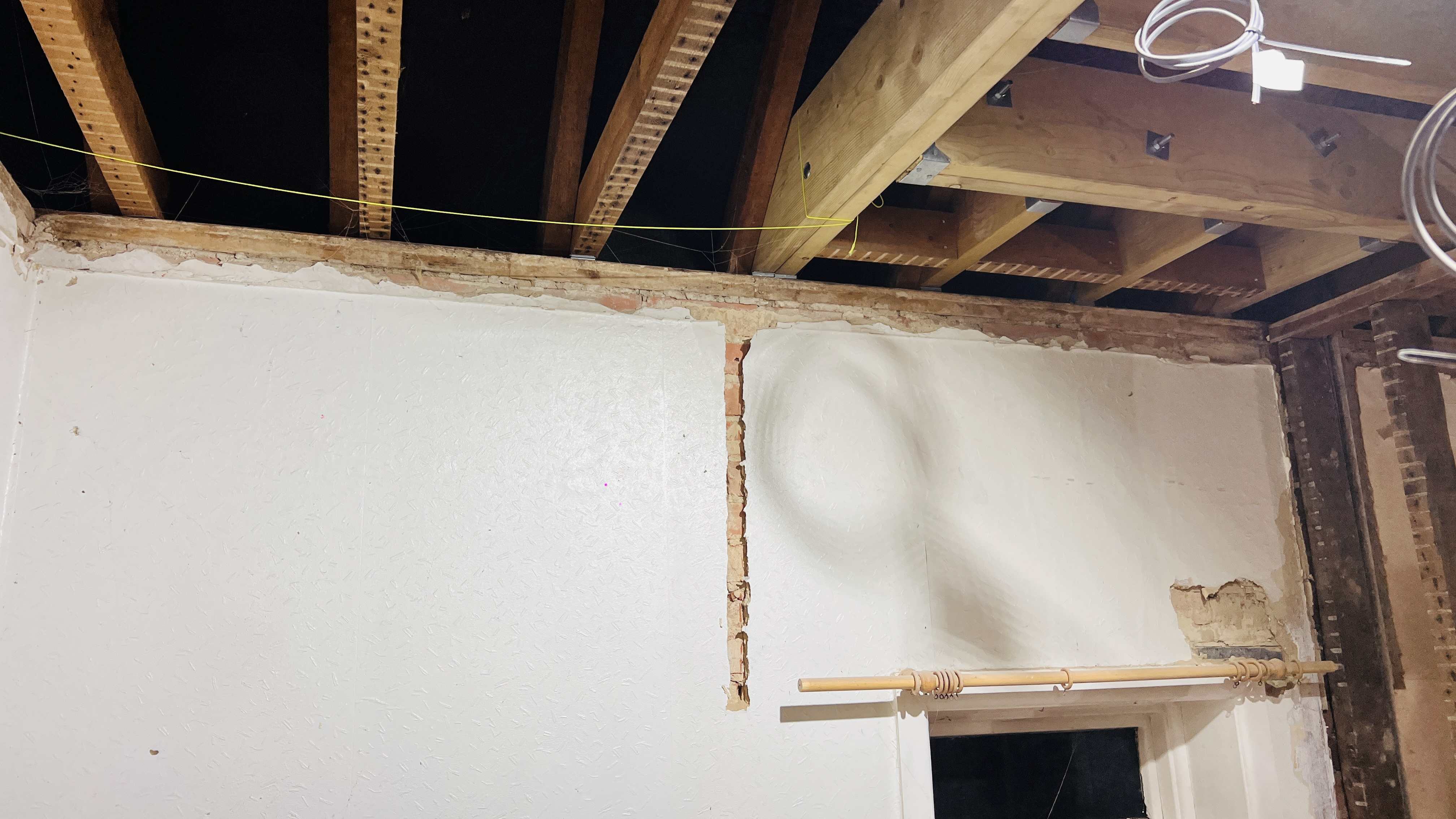

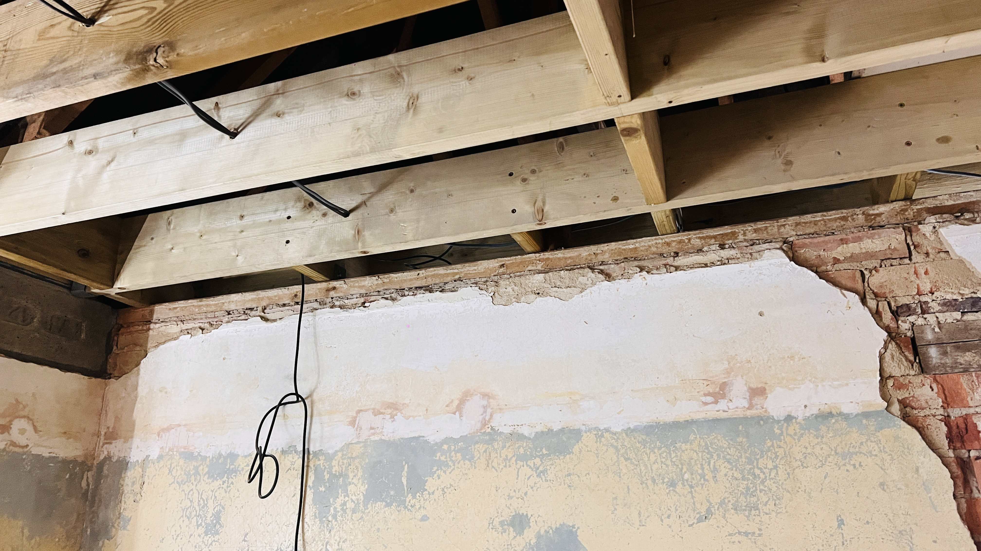

Hi guys. I have recently replaced the first floor joists in our renovation project for a future loft conversion. I had to remove the old ceiling along with the old coving which took the plaster at the top of the walls with it. It is a 1930's property with cavity walls and lime plaster. I intend on fitting resilient bars to the underside of the new joists so looking at resilient bar details it looks like the wall plaster should continue up passed the ceiling plasterboard and the ceiling plasterboard sit inboard of the wall plaster with a gap filled with acoustic sealant. What is the best way to fill these gaps at the top of the wall? I understand that lime is better than gypsum for breathability (but then less important for cavity walls) and I will do my best to use lime plaster where I have any large patches that have come loose but I also understand that lime doesn't really stick to timber so was wondering if the best idea would be to use bonding plaster for the strips around the top of the wall where there are timber wall plates. I was thinking to additionally fix 100mm wide galvanised expanded metal lath to the 50mm wall plate and brickwork under, sealing with PVA and then bonding over in 10mm layers. I know that I could probably do the same with lime but would need stainless EML and fixings if I am not mistaken and it just starts adding to the cost so would only do that if it was absolutely necessary. Does my approach sound reasonable and won't end up cracking all over the place or inadvertently rotting the wall plates because they can't breathe haha. Also will this approach be fine for a bathroom? Many thanks in advance.
