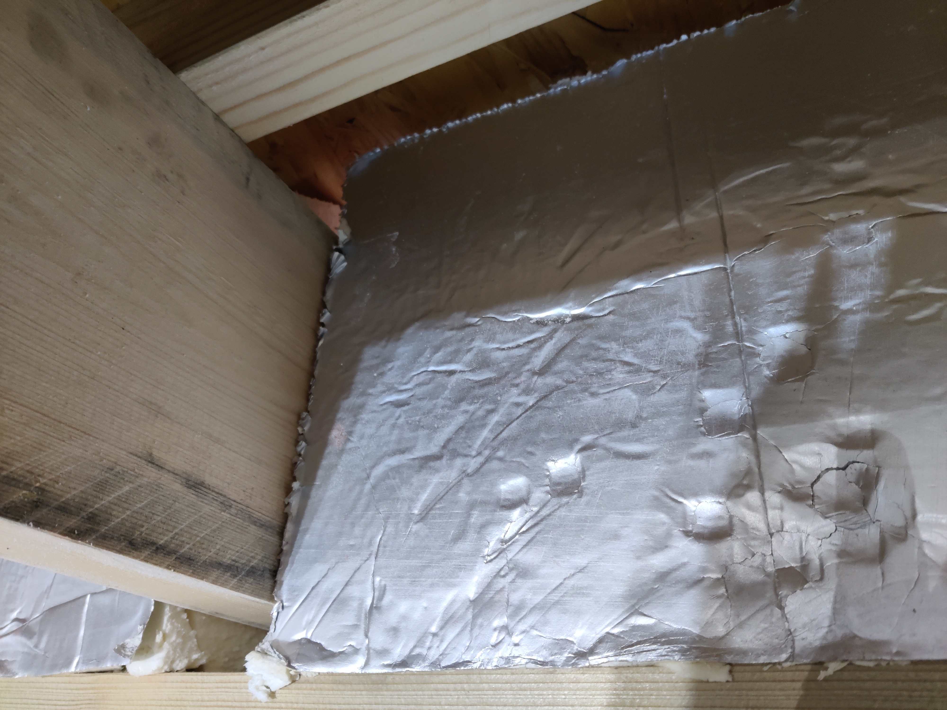

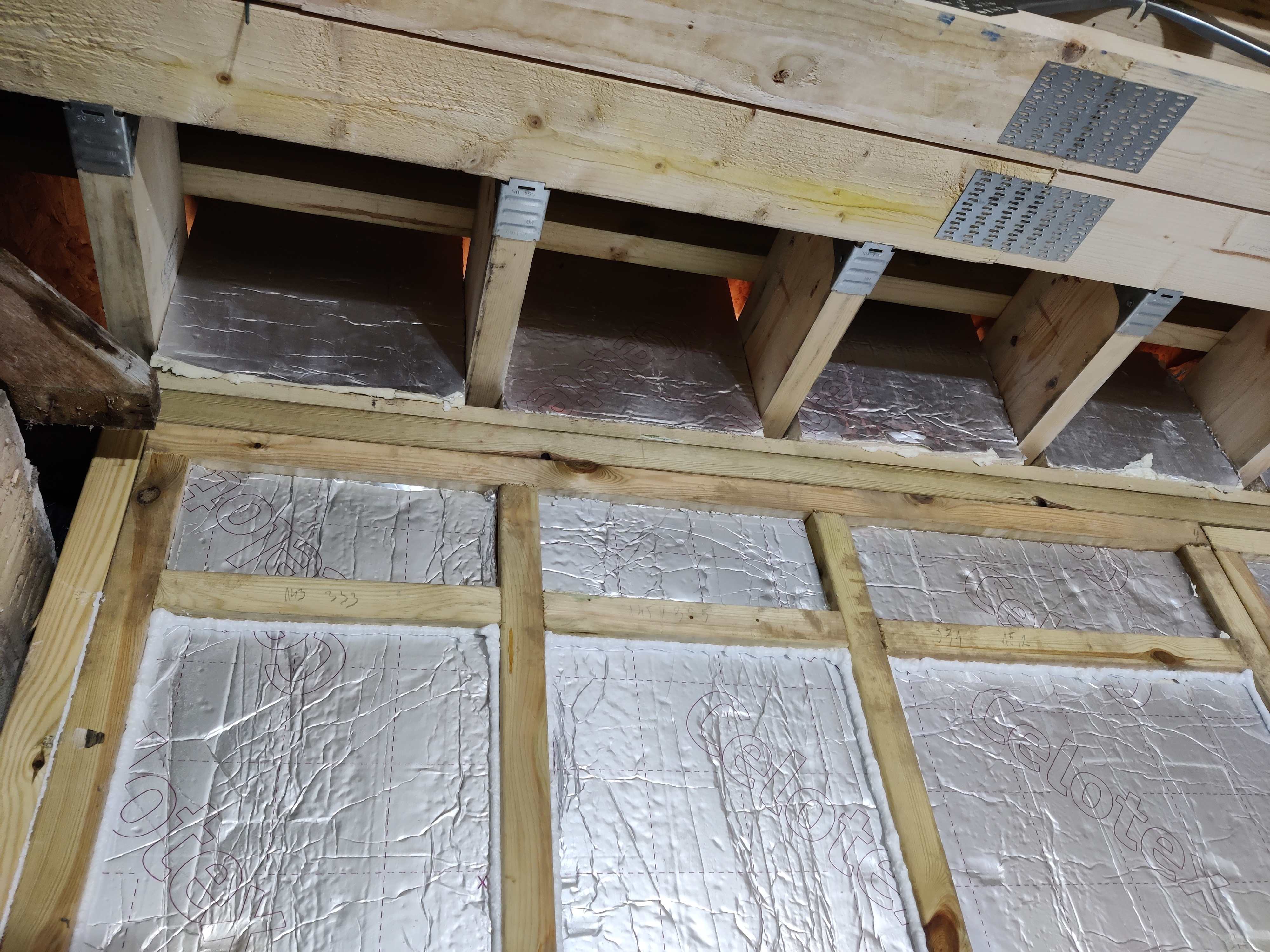

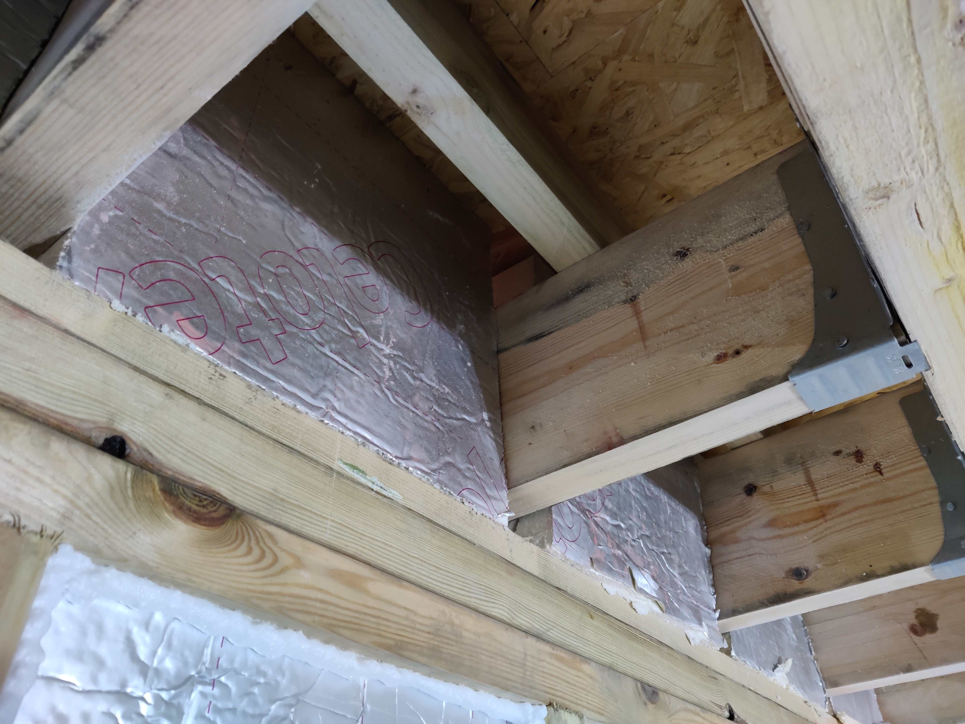

  2. Thanks to all the above comments. I have spent the last few weeks trying to fill the gaps left by the bad fitting warm roof, using PIR cut up into blocks and foaming them in I used a airtight foam on the inside perimeter and a large area 'coverage' based foam on the outside. Still not sure I have got all the gaps, due to the now inaccessible cavities between the outriggers and the roof edge Had many sleepless nights adding up all the area of the blocks I have cut, to literally cover the daylight coming in. Had this not been addressed, at least partially by my efforts, it would have been like leaving a window open continuously. I think the best way to have installed this would have been to fill the gaps between the outriggers, prior to the installation of the roof section, as you would have far more access. The roof could have then been built onto a continuous layer

  5. The gaps around the outriggers are due to added packing required to bring the roof deck level due to the discrepancy from the interface with existing building

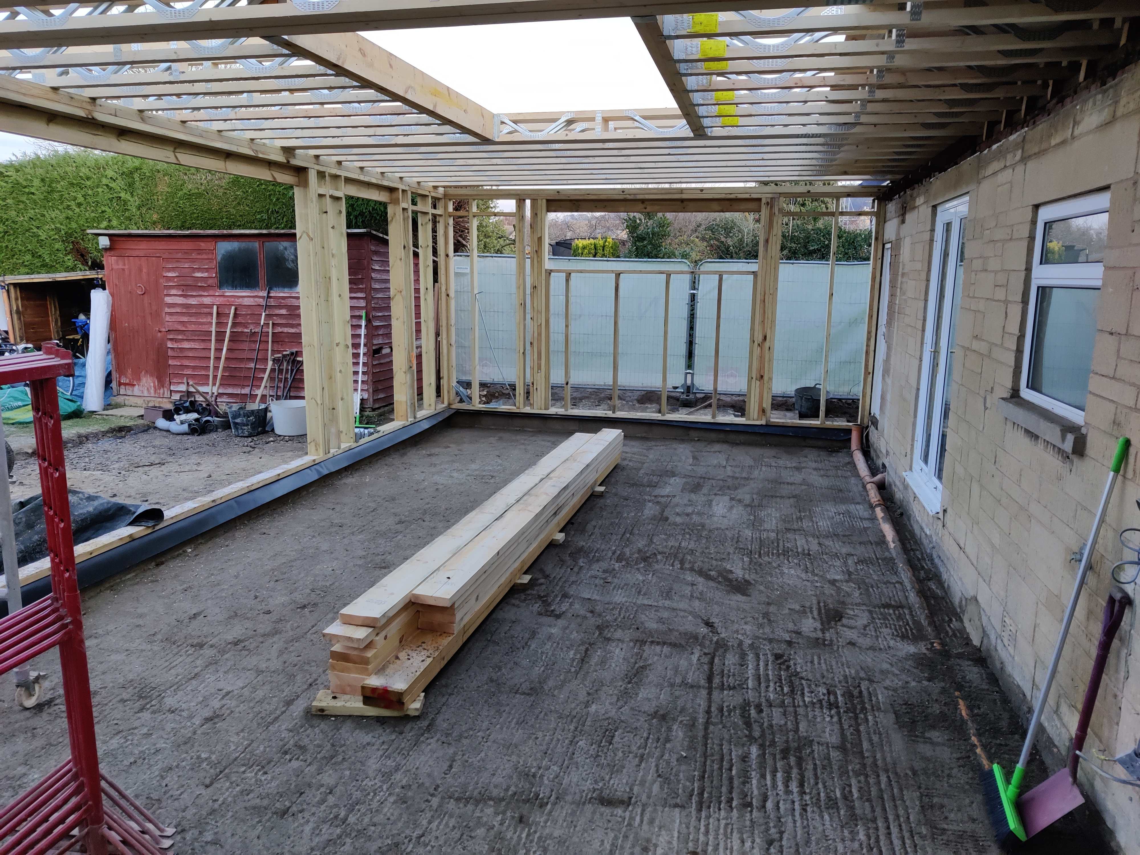

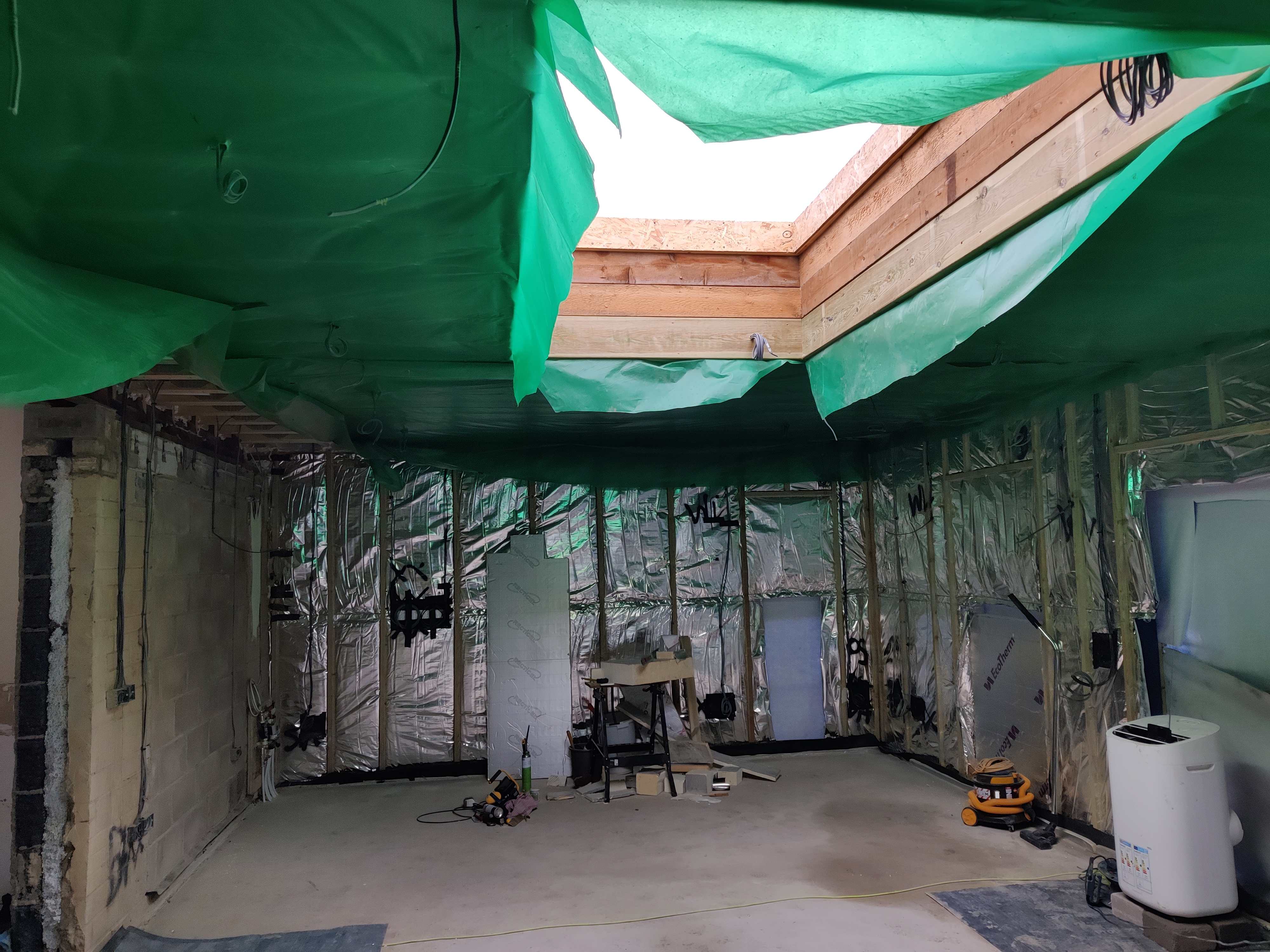

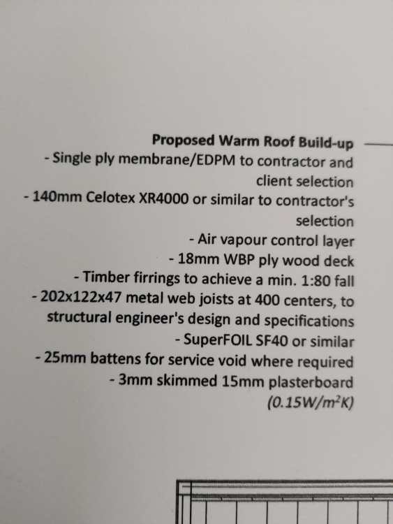

  6. I am mid way through an extension and house refurb The extension is a timber frame using a warm roof on pozi joists and I am increasingly worried about the separation of the roof insulation layer from the conditioned space below due to the difficulty in sealing up the gaps between the pj and the top layer of the walls with PIR To further compound the problems, I wanted an overhang around the extension. Whilst the PJ's facilitate this structure naturally on the one face, the two sides are forming the overhang using outriggers Combine the outriggers, packing and the roof fall angle and you can currently fly a drone through some of the gaps between the roof deck and the walls Whilst air tightness could be achieved using a vcl, heat loss from the break in insulation continuation cannot and I don't understand how we have got here Possible solutions I have considered are commercial spray foam sealing from the outside of the roof cassette and the inside or my latest idea to fill the area below the roof deck with blown in insulation. Please share your thoughts and possible solutions
