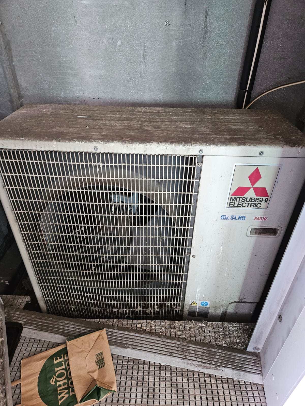

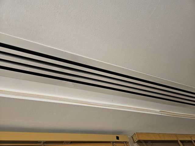

  7. Can you give me a rough estimate of how much it'd be to replace with a new system? I guess it'd just be the cost of new units plus replacing them given that as you say it's all ducted? Do you think it'd be noisy at night? Also I understand best way to make the AC work would be with a smart thermostat that switches it on just before we get home in the evening and automatically in the morning? Or a normal thermostat would be enough? Thank you.

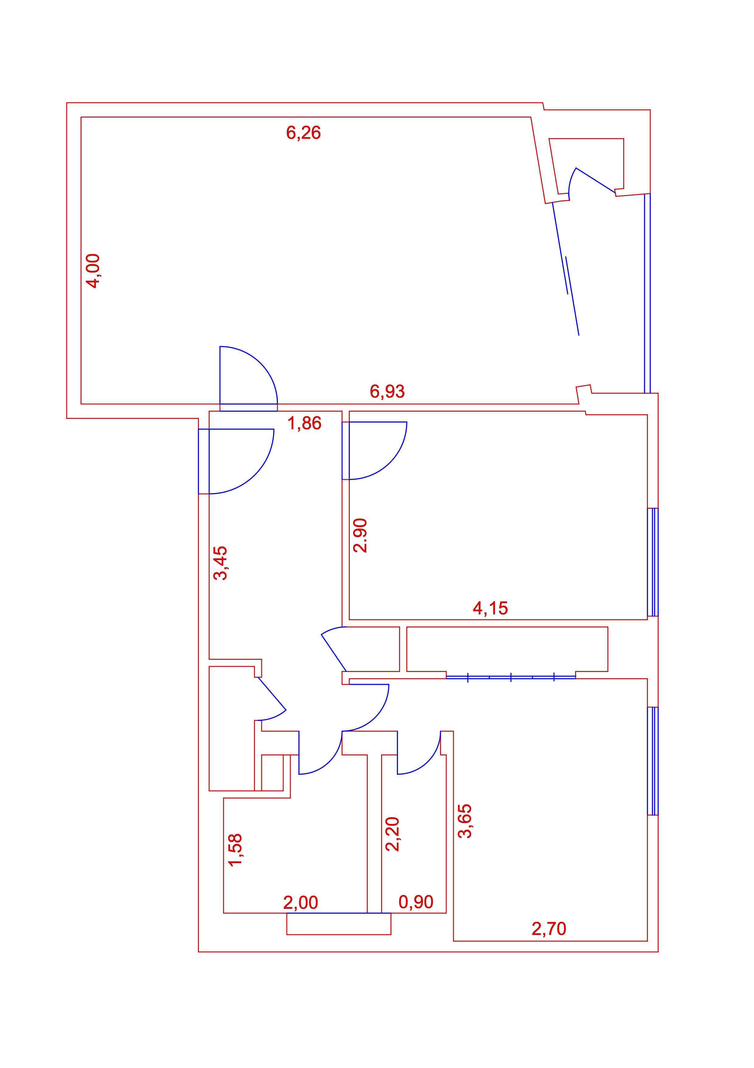

  8. Hi all, we've recently purchased a flat in London and are about to renovate it. The flat is 72 sqm, two beds two baths, lounge/kitchen and a small hallway. I am attaching a plan. There is no gas. Hot water is provided through a Megaflo cylinder. Insulation is alright. In terms of heating needs, my brother and I will be living there and are at work Mon-Fri during daytime. However my family will be visiting often and in such cases the house will have to be warm throughout the day. Heating wise, we have the following options: Electric UFH: among the works we will also change the flooring so could be a good time to put electric UFH. We like the idea and the builder is also pushing for this option. Yet I have heard it's very expensive to operate. I struggle however to get a sense of how expensive. If we were to fit it throughout but for the bathrooms, how much would it be per day? Air-to-Air system: in the flat there already is a ducted air con system which is a Mitsubishi Mr Slim installed in 2002. There is an A2A external unit on the balcony and air vents in the lounge and 2 bedrooms. It's still working however is obsolete and I guess noisier than the current systems. The cheaper option could be just to make the current system smart through a thermostat? Or the other option would be to put a new system in place of the old one using the same air ducts and pipes. See pics attached. Electric Storage heaters: 3 dimplex quantums, one in lounge and one in each bedroom. We would prefer the UFH in principle as the warm feel coming from the flooring is more attractive but also don't want to spend a fortune to heat up the house. What would you suggest? Thank you!
