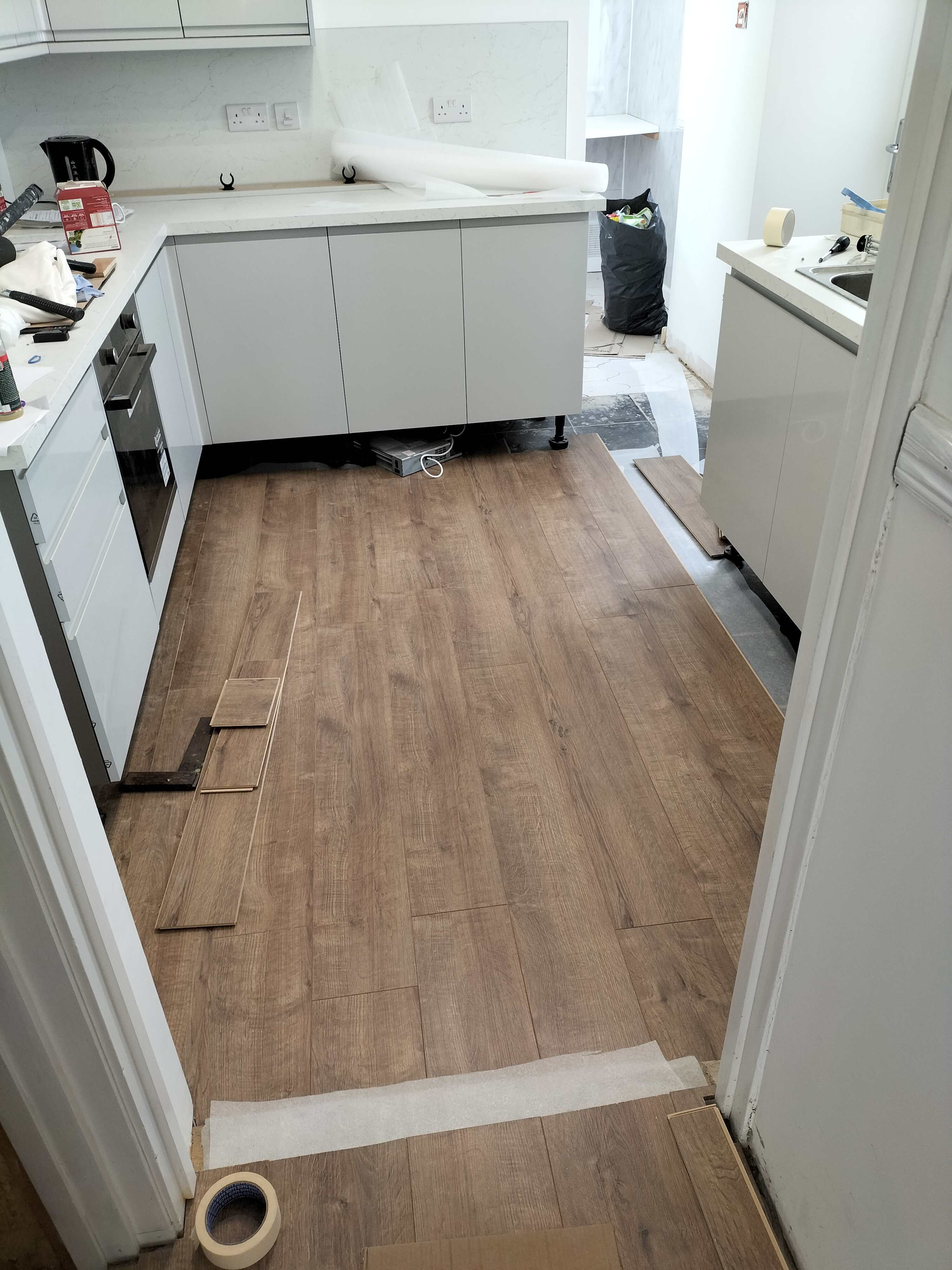

  2. Thanks for all your inputs. I didn't "stand" the legs on the planks as I thought that would definitely stop any chance of expansion / shrinkage But I like the suggestion of putting a retainer on the left and right so that is now my plan. If there are reports of a kitchen floor making its way up the M5 you will know where it came from! Thanks
  3. The floor area is about 2 x 3m plus the "hidden" area under the units. The kitchen units are on 3 sides
  4. I have laid a new floating vinyl floor (click planks) over old kitchen tiles which were flat but badly marked. I can't reach all the way to the back of the kitchen units so the new flooring ends just inside where the plinths fit. The only down side is I can't meet the usual expansion gap criteria ( the actual gap is probably about 300mm so obviously no worry about any minor thermal expansion!) but as it is a floating floor I am a bit worried it may move too much. I am thinking of gluing some pieces of wood around the edges of the floor where I can reach under the kitchen units and generating a "false" expansion gap between these pieces of wood and the new flooring. I would pack this gap with cork or foam. Would this solution work or is there a better way? For the record the kitchen units are in perfect condition so no reason the disturb the whole installation.
