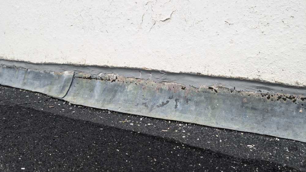

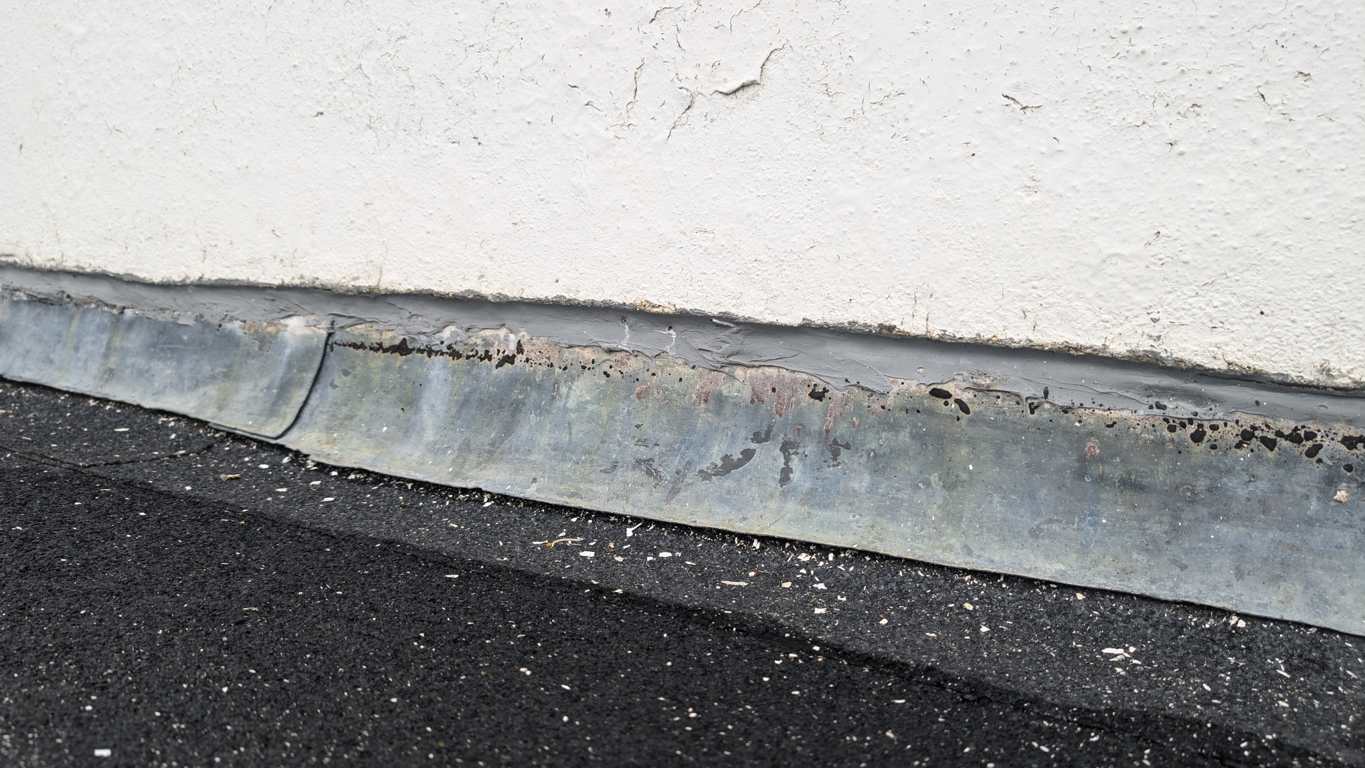

  1. Thanks Russell. Any particular brand stand out as much better than others or are they all pretty much the same? Up close there does seem to be a small lip still there to shed water over the lead. So I'll be careful clearing it out and try and keep it if it is still ok. Thanks again

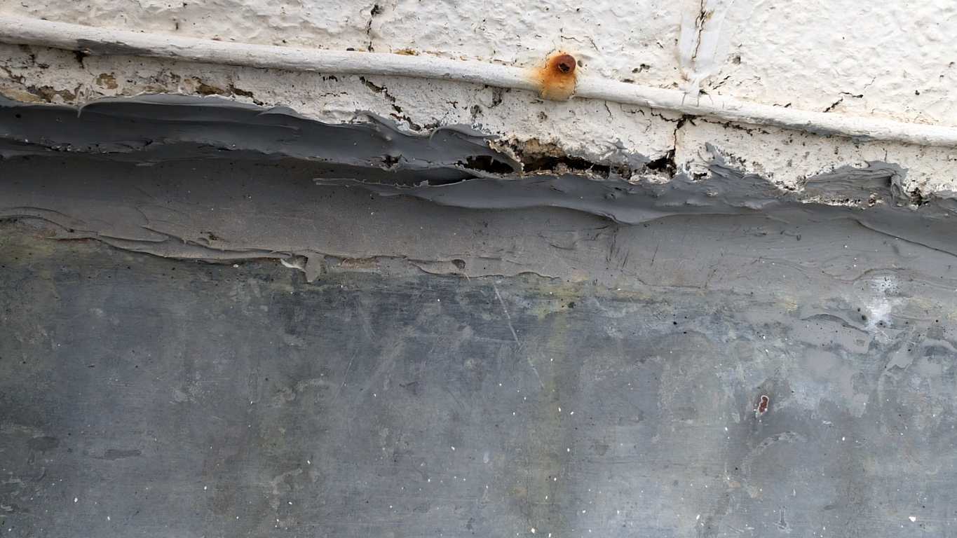

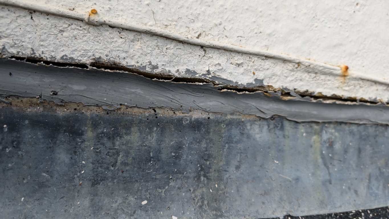

  2. Morning all, I'm after you advice please on the poor/well aged finishing on the front exterior wall to flat roof flashing in the attached photos. I'm about to repaint the front of the house and found this after a thunderstorm and a small leak. My question is do I remove all the old sealant and just refill with mortar down to the flashing or do I need to consider anything else? I am certainly no builder but do have a basic DIY understanding. Thanks any help appreciated.
