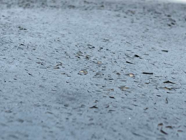

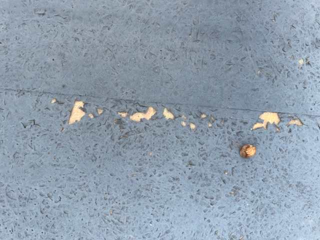

New Member (2/5)

  3. I have every intention of sorting it properly but realistically I'm not going to get a chance until after this winter. So for the most part the roof is fine, but there are some parts that need something. So hence the question whether I can apply something like tekcrly or in fact I'm being pushed some gorilla sealing tape which sounds like it would do the job. Like a quick sand down and apply - before the weather gets really bad. Most of these solutions say they work quickly and in the damp. Interesting you say it may not be GRP because from memory I am pretty sure that's what I was sold. I will need to go back to the original documents to see. If not GRP what would you guess it was?
  4. I took these before popping some tarpaulin up. I've done some reading and perhaps the coating wasn't done properly in the sense maybe it went up with the boards under being damp. I'd read that can cause peeling problems but really this looks like flaking and bird claws scratching away. Could be wrong! thanks Paul
