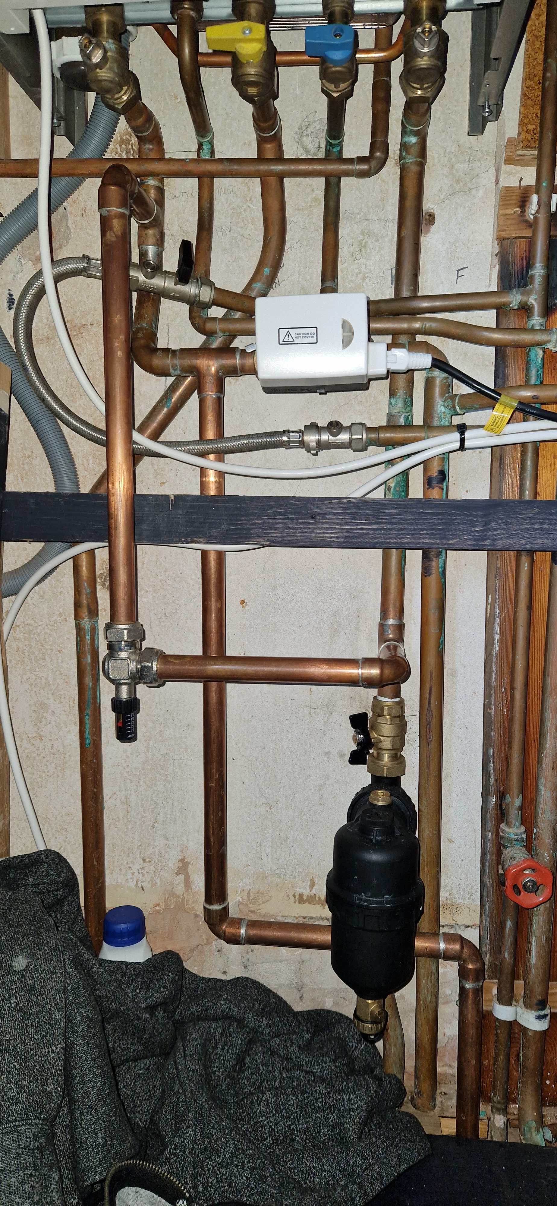

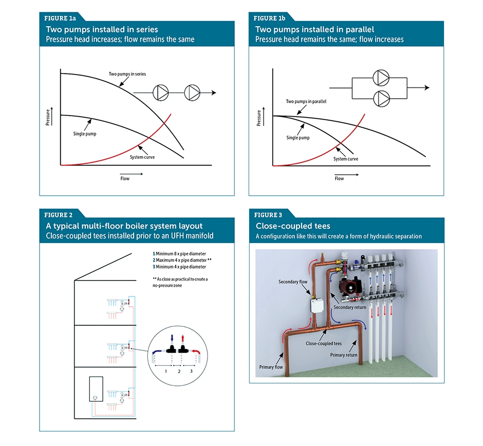

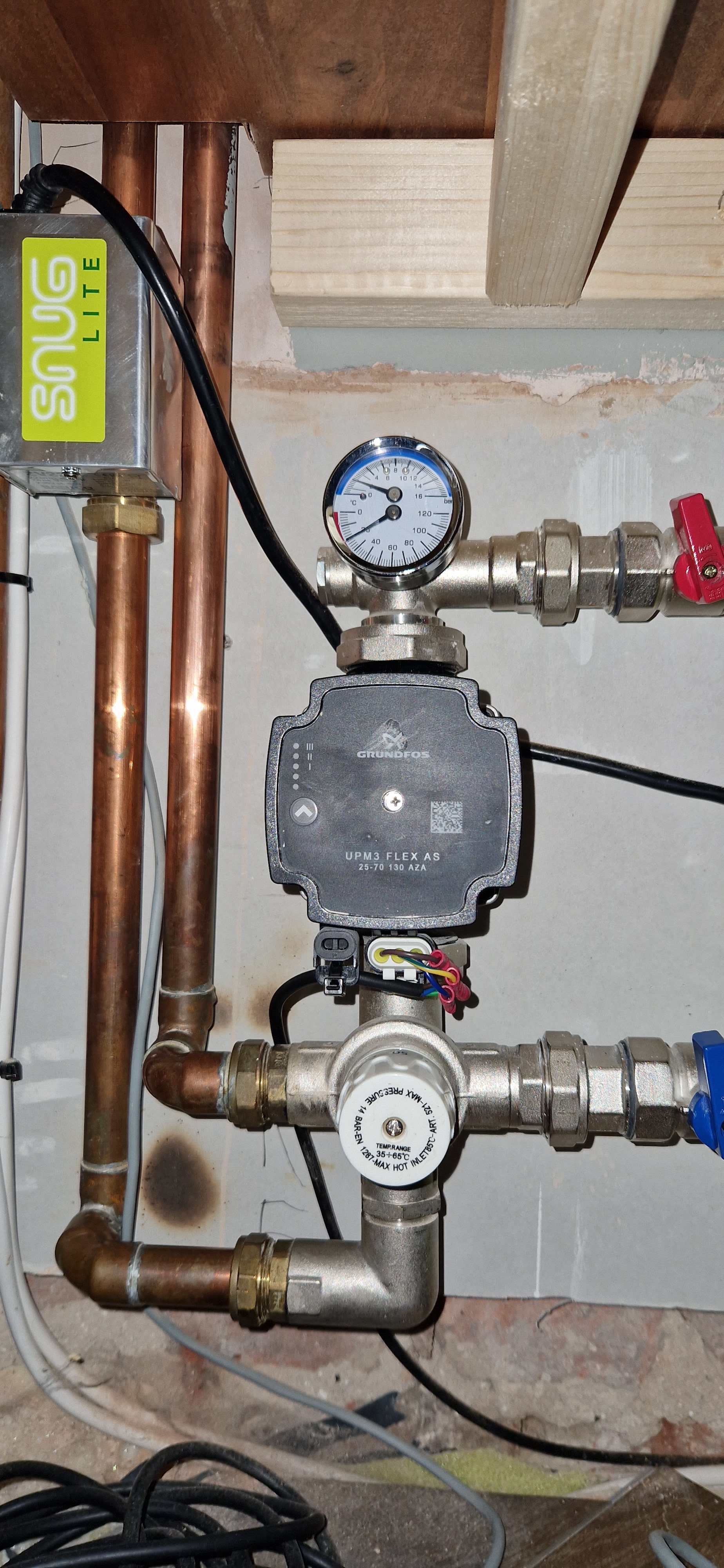

  5. There is the current 2 port valve (the snug lite) for the ufh on the flow, then the CH circuit valve under the boiler on the flow after the t off to the ufh flow.... so if i read correct, ideally the 2 port valve on the ufh circuit would be between the close coupled t's (open with ufh all the time), and would be closed if both the CH and UFH are on... that way there will be a circuit to the CH open at the same time the UFH is on a loop, but if only the UFH is on then there is a bypass on with this. As you can see there isn't space for this, and the manifold can't move, but might there be anything to help this with the current ABV set up? Obviously currently the ABV is there whether the UFH is on or the CH or both, and I presume in reality the setting of the ABV would be different if you treat both individually. Sorry for all the questions! I have a basic understanding of how the circuits can and would work, however I don't have the experience of it! If I am replacing the boiler I'd like to try and ensure the system is going to function. Just as a side note (whilst I'm waiting on people to see and quote for boiler replacement), I've stripped down the diverter valve again and put all the old parts back in but cleaned up with the washers from the newer parts. There is no longer any whining / whistling, and the CH seems to be working OK (albeit, the system still needs balancing properly since all rad valves got replaced). However, the UFH circuit now cuts the boiler after around 10 minutes with either safety stat fault or primary circuit fault. I've tried increasing the UFH pump speed and decreasing it but both seem to be the same. The water gets through as the manifold gets warm. It's presumably a flow issue, and another reason for trying to ensure the actual circuit is OK before just replacing the boiler

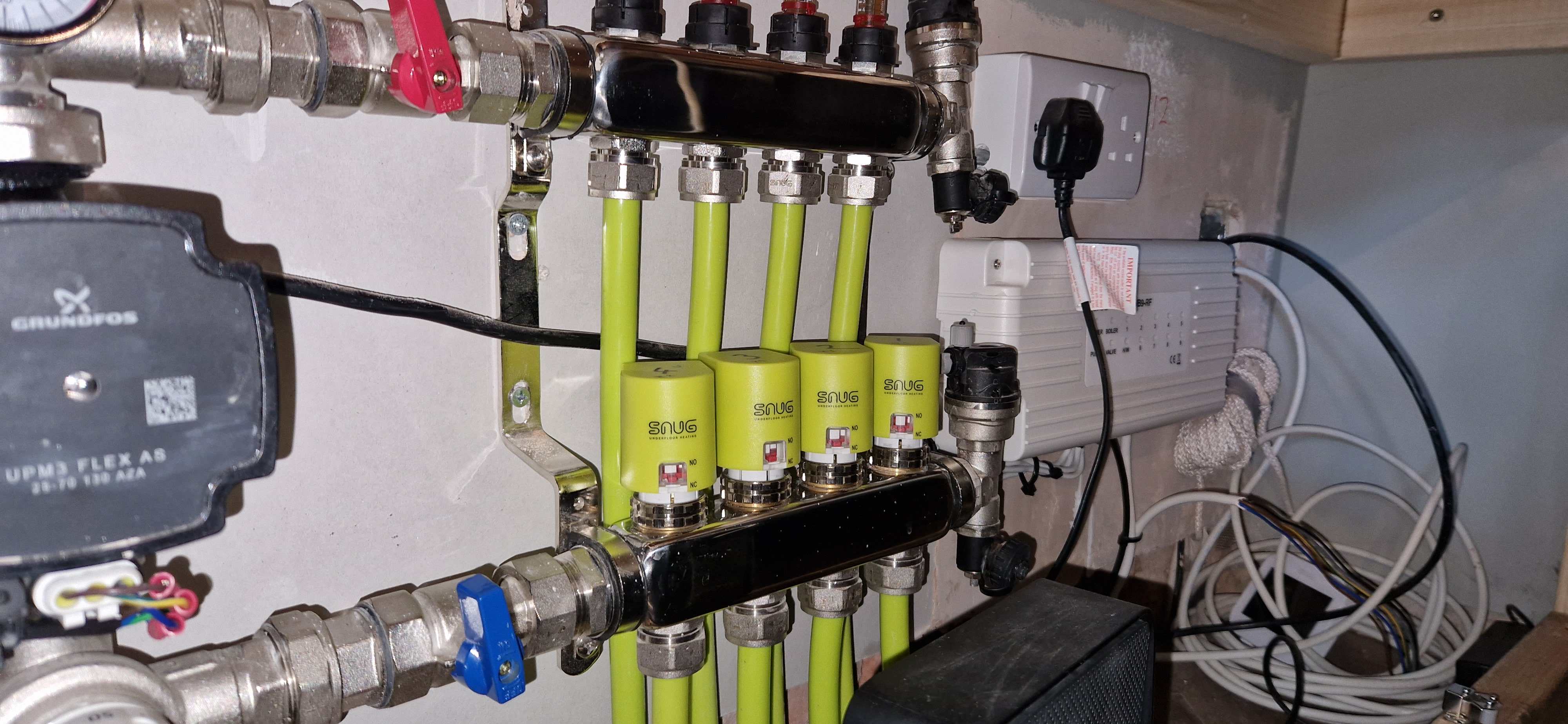

  6. These photos show the current arrangement under the boiler upstairs with the ABV, and then the arrangement at the manifold downstairs
  7. I will have a proper look when I'm home, but not sure there will be enough space available where the pipes have been dropped down in a corner. Might be able to make a primary flow circuit in the first floor under floor boards before they drop down as secondary (secondary flow pipes are going to be around 3m away though then).
  8. Something like figure 3 in this image thank you for a thorough explanation of everything too!
