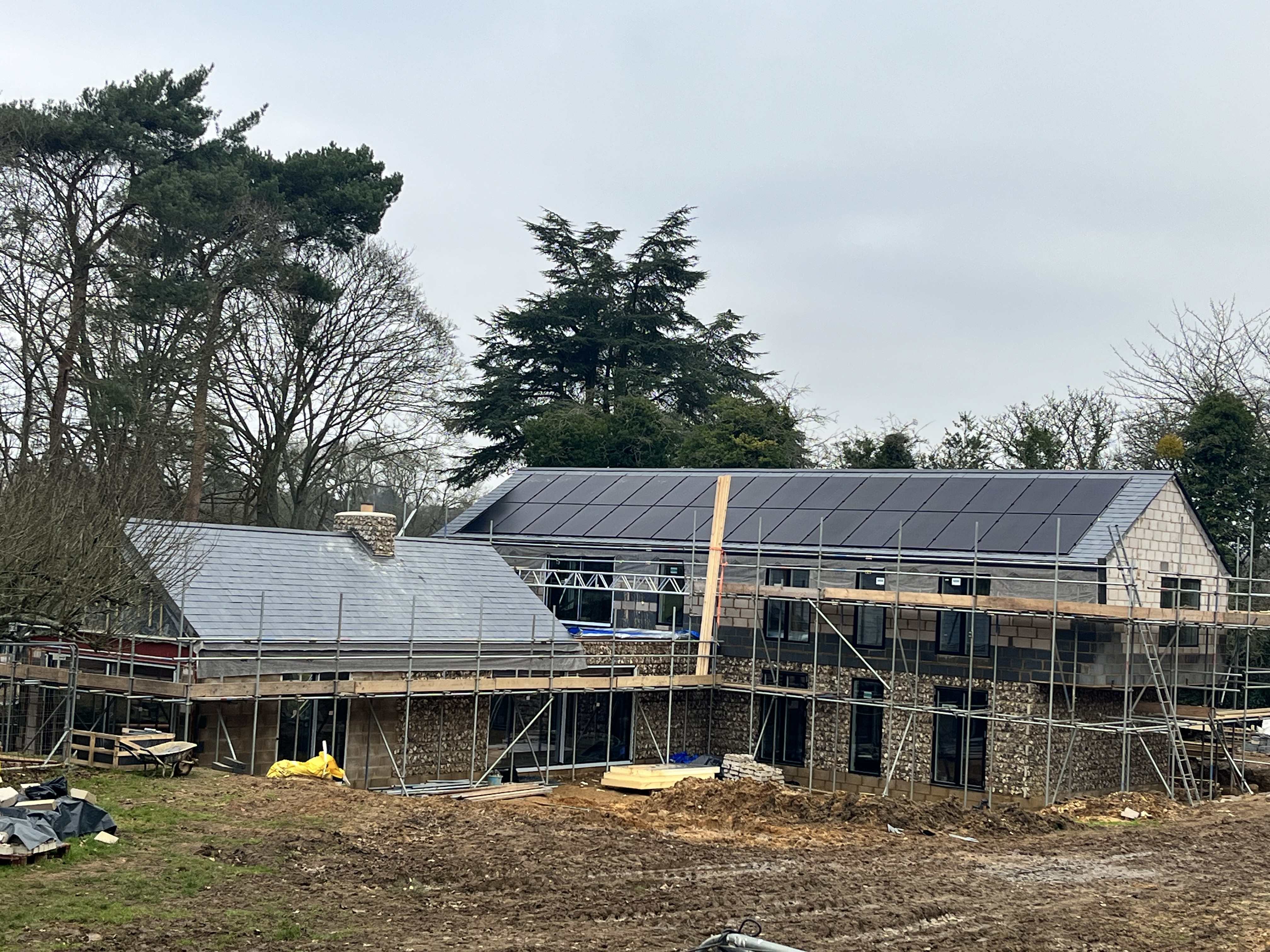

  1. So we are just starting first fix on our new build. Construction is solar blocks with cavity (and 130mm PIR in cavity). external is a mix of wood cladding and flint blocks. We are trying to achieve good airtightness levels (1-2?) (and we were I think pretty diligent in sealing the PIR at all joins with aluminium tape and foam where needed) - though not aiming for passive house- for MVHR system to be effective (and to make the most of the triple glazed window investment!). My main questions are: 1. do we need to parge coat the inside of the external blockwork walls 2. Is there a recommended preference between batten and plasterboard or dot and dab (do either route make airtightness easier to achieve) 3. Is it better to wet skim the plasterboard on the external walls rather than just taping and filling joints - from an airtightness perspective. Understand this is a somewhat well trod discussion path , but be interested in latest (and simplest ) thinking.
