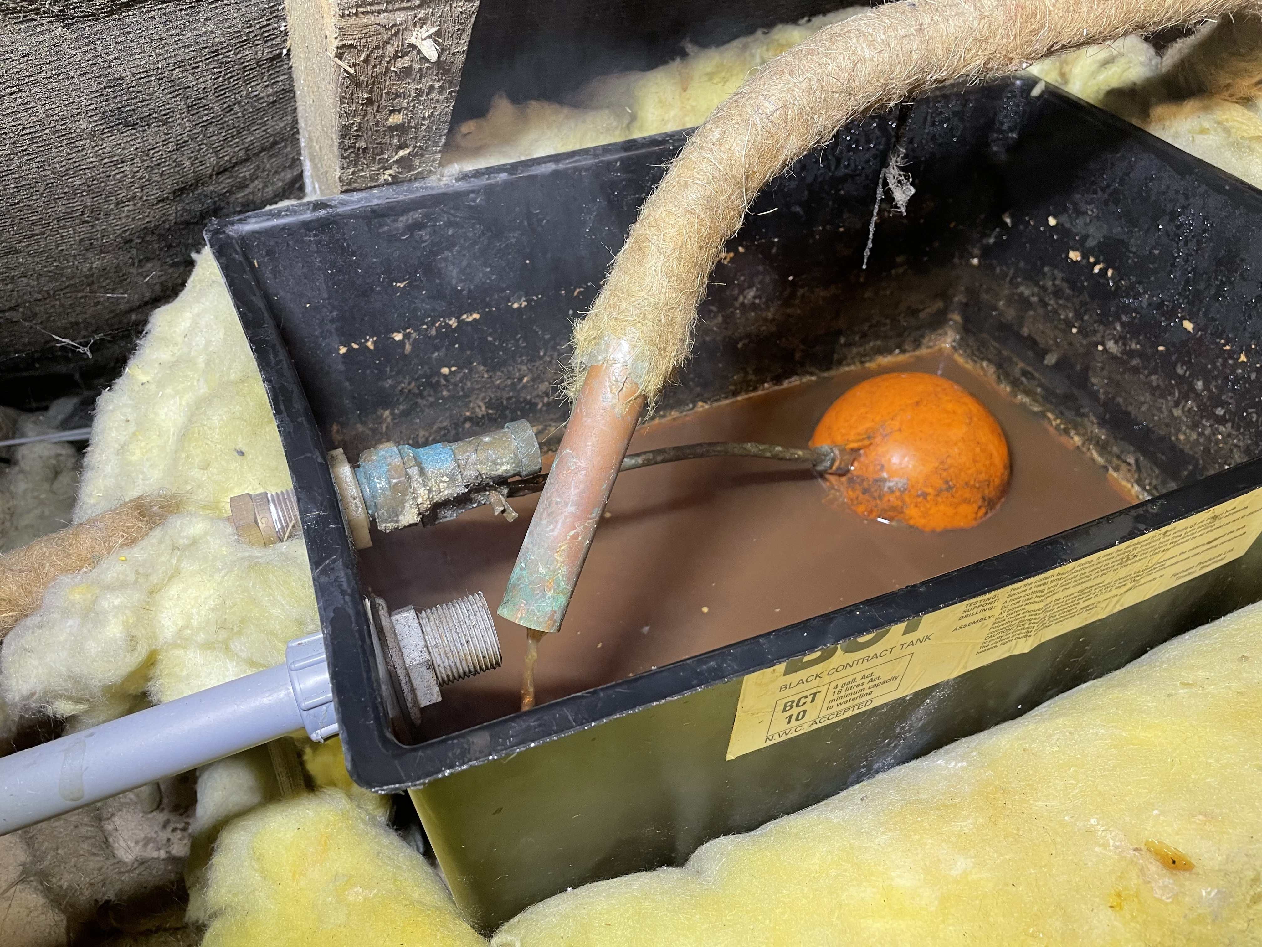

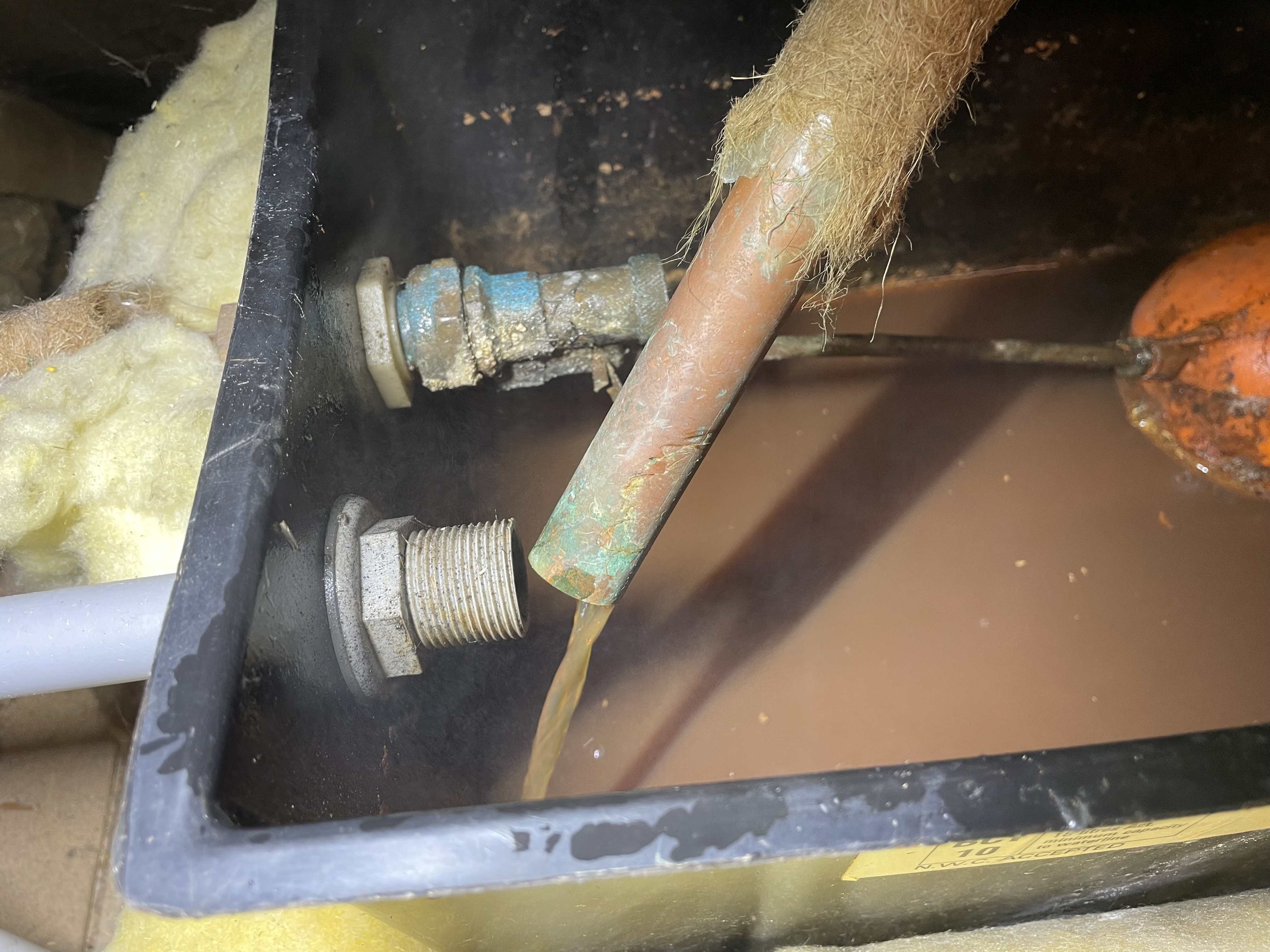

  7. Hi, here's the update. We cut the H pipework out, releasing it on the top side of the pump inlet valve. Popped a hosepipe below the cold feed isolating valve and emptied and cleared the header. There was plenty of gunk just in that, obviously most sitting on the bottom and sides under the water level. The inlet side of the pump was choked though. I don't have a pic of the H pipe as I was in the loft but that did have residue on the pipe walls. After this was re-instated the partial refill that was needed seemed to go better than previosuly and there was no pump-over at PP2 pump setting but still a little at full bore. So I asked plumber to lift the vent which he did. I'd already told him that I didn't want to retro-fit a pressurisation vessel. There was no pump-over after that at CC3 but in fact I left it at PP2 and all was well. The header had got some brown water in again from that brief pump-over and so I'm resigned to another full drain and flush/fill - but not until the summer. It has some Fernox P3 in for now. I need to leave it and give my parents relief from the to-ing and fro-ing. Thanks again guys for your sage advice and comments. It has been very helpful and gave me confidence to stand my ground and not do the pressurisation and certainly not rip the whole lot out and replace for £5k

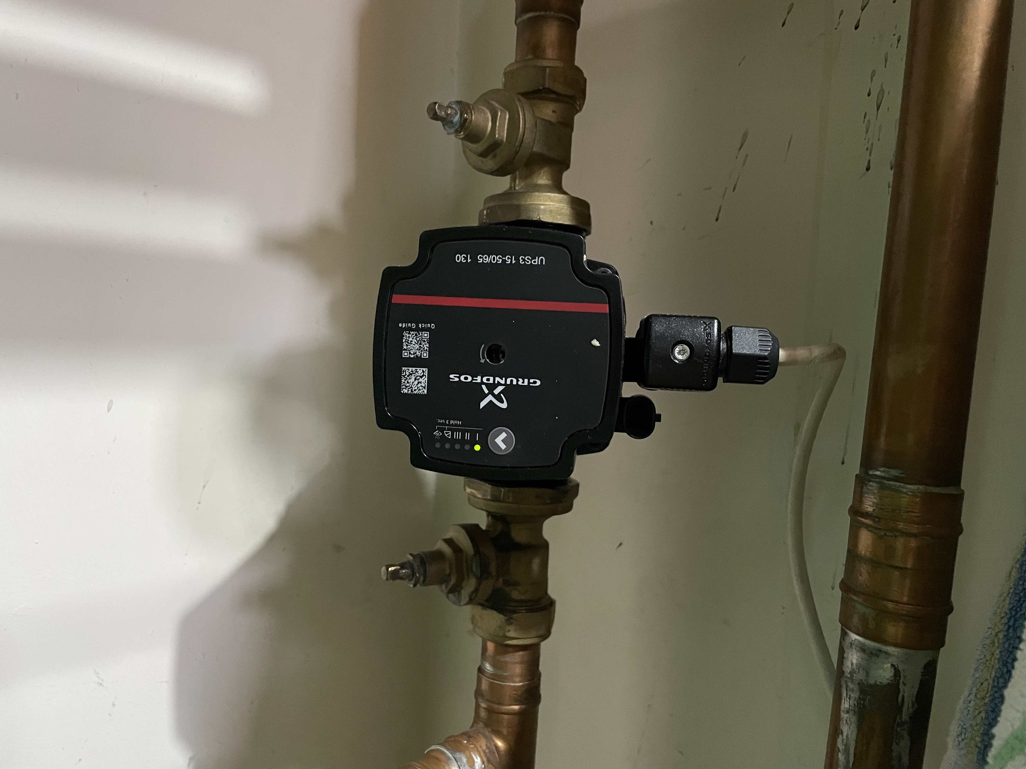

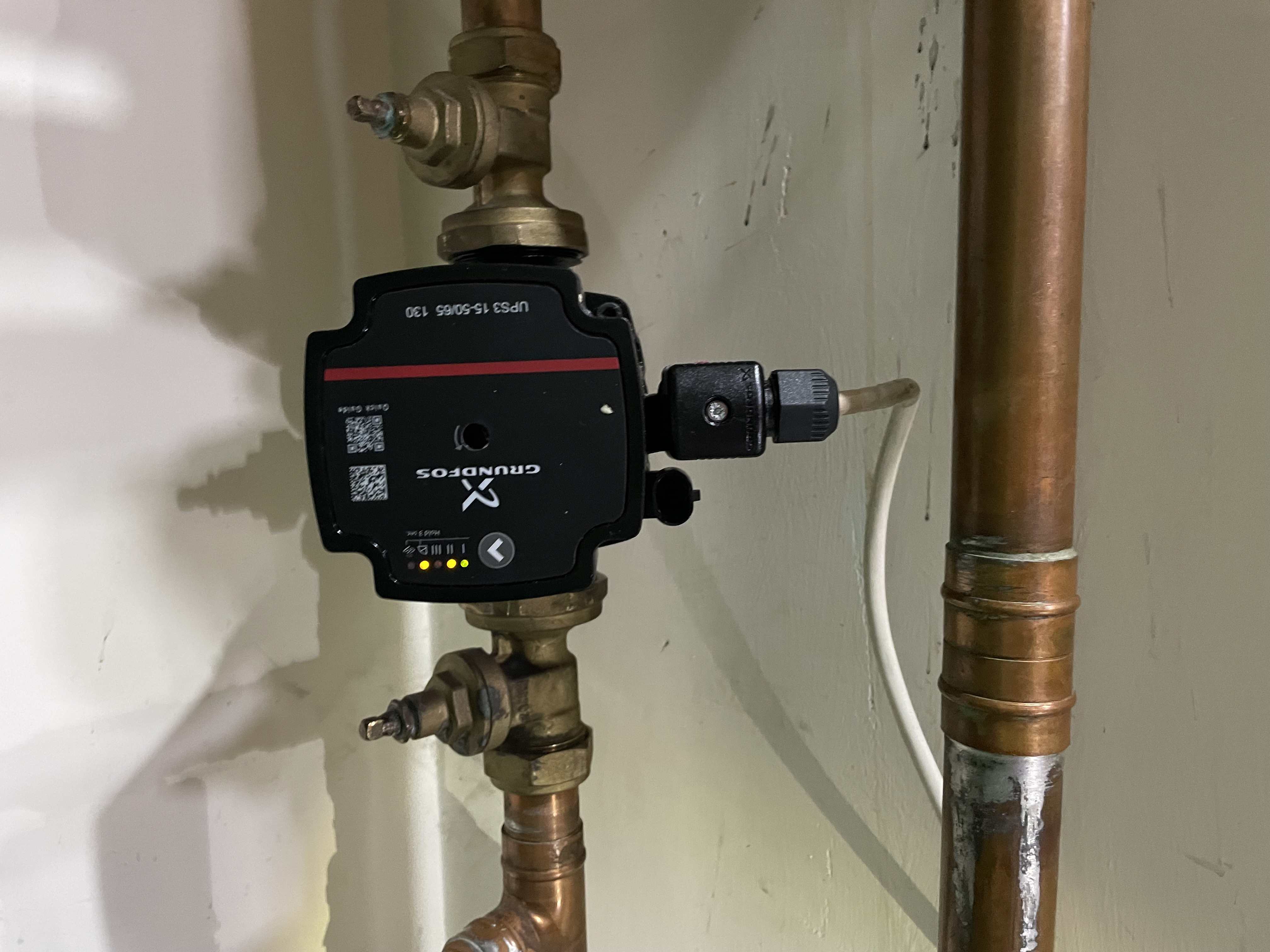

  9. Plumbers 2 & 3 did. Don't know about #1. Thank you for all the help. This thread proves that often all of the detail is needed before a cause can be found.

  13. Ok some pics plus my father is having some sort of issue which I’m keeping an eye on. This is the first setting and the water flow over. This is PP2 with reduced water that sounds worse than it is. That just means I should have looked and not listened. There is scope to lift the height of the vent. Edit. Obviously the water colour is still not good and it will need a further clean.

  23. Thanks for the feedback; I'm not surprised by it and it seems to be sensible. I did try the PP2 setting this morning but again only for a short time. The noise from the vent water sounded louder from the bottom of the loft ladder, so I changed back to the (slow) CC1. This is the pump that was replaced. And the new one
