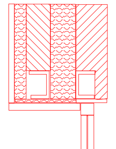

  2. Back to back channels with insulation under/around?

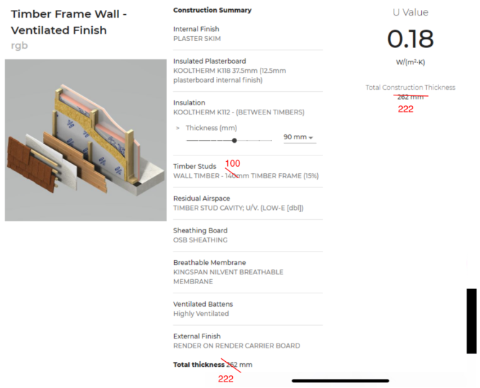

  3. Thanks. The difference is being able to put a bed in the room or not and still get around it comfortably. Managed to still keep U-values to 0.18 and a 222mm build-up. Have checked it with my BC/NHBC buddies and they seem to think it's ok.... (we shall see what my local one says soon enough!). Just checking in with Kingspan i haven't ballsed it up. NB- Also seem to have noted you can't get hold of 90mm K112 boards. So 100m it is.

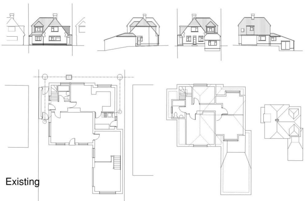

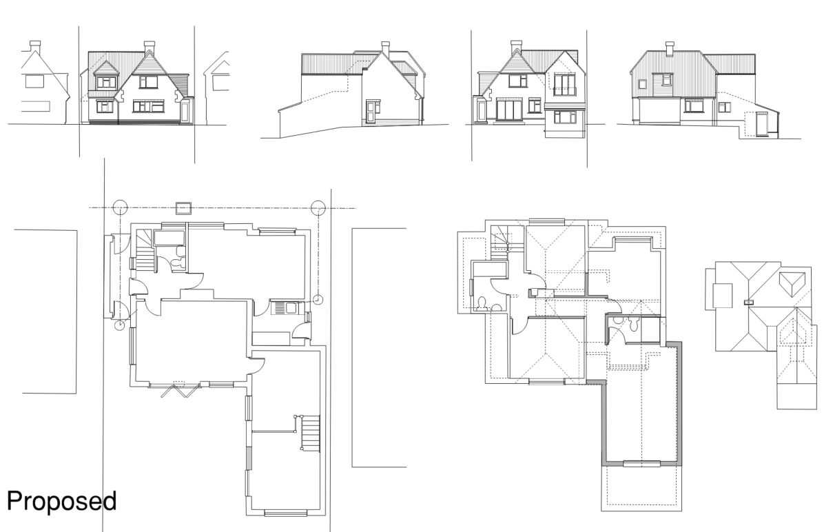

  5. Hi All, First post (apart from my intro) so go gentle 😀. I'm looking to build on top of an existing extension at the rear of my detached house. The existing ground floor extension is against the boundary. Both my house and the neighbouring house are 1m from the boundary at the front. I'm hoping to build straight on top of the ground floor extension bringing it up against the boundary. I know generally planners don't like building side extensions against boundaries on a row of detached buildings as it breaks the character of the street. And none of my neighbours have either. But given the side extension is basically a rear extension and well set back from the street I was wondering how much leeway the planners will give. Other thing to say is the roof will go from a hip to a gable end which none of the neighbours have either. Pictures speak a thousand words.....
