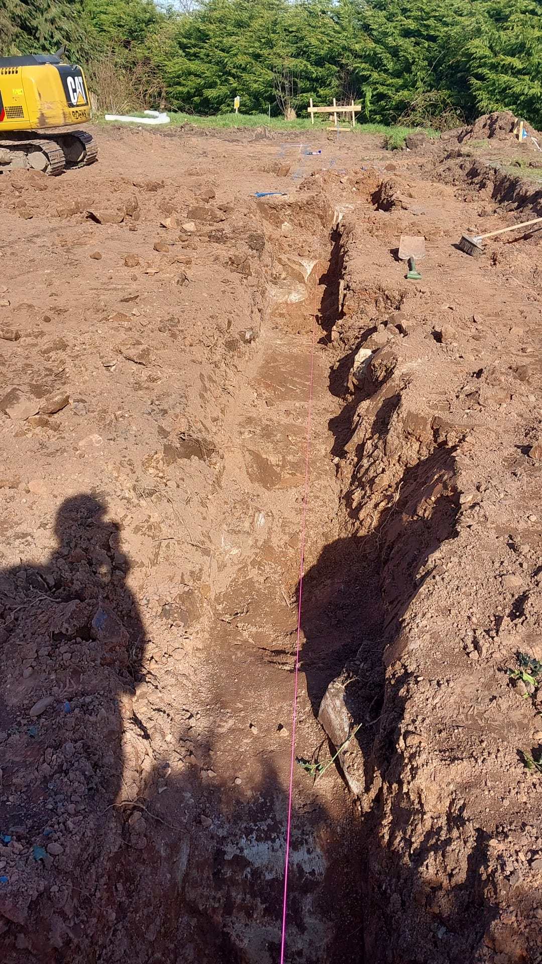

  1. thanks guys, yes agree a decision for a professional but good to get combined experience here too. With hindsight a raft would have been better. Stopping work isnt an option as the kit is on its way so we need to keep going, more money and more concrete has been decided as the way forward 😒

  3. Hi We have had a call from our builder who is laying the strip foundations for our new house. The ground is all sand and sandstone and the strip foundations he is digging are hitting quite high bedrock in places then dropping three foot down to lower bedrock. There are loose sandstone peices which means the pit walls are falling in places and other places the bedrock is sticking into the trench. The builder has proposed using mesh and filling the trenches with concrete but this means using a lot more concrete than we have budget for. Has anyone encountered this before and if so did you find a cost effective solution? Any ideas apprecaited!
