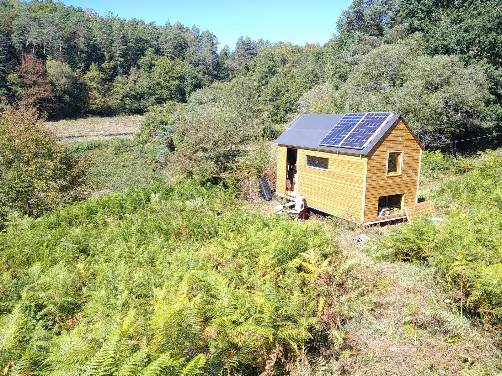

It's not a shed. It's a house, so it needs insulation. Temperatures vary between 40 degrees and -7. I want to minimise my heating/cooling costs, so we're looking at 300mm thick insulation and minimal cold bridging. I've built a shed there already, which I live in while I'm building. It's 11mm OSB framed with 2 x 1. 25mm celotex in the walls. 75mm celtotex in the roof, and 100mm celotex in the floor. It's 4.8m x 2.4m floor area. It's fine it all weather except the top temperatures, when it gets far too hot. -

Hi, I've done quite a bit of building - renovations, extensions, replacing rooves. Always DIY, low budget, usually working alone. Built a tiny off-grid cabin in a lovely piece of a valley - 23 acres of oak forest surrounding a meadow which is full of insects and wildlife. I'm aiming to keep it that way, with a few fruit and nut trees scattered about. But we can't officially live there, so I bought a building plot nearby. The plot is nice and was cheap. The intention is to build a cheap timber house close to passive house standard. The plot is sloping 8 degrees, and I wanted a minimum of digging and concrete, so it's built on oak piles. The floor space is under 50 square metres, so I'm not obliged to hire an architect or structural engineer or have air-tightness tests etc. But I do want the house to outlive me, and as the builder I am responsible to correct any defects that appear in the house over the next ten years. So I'm here, mostly for feedback and advice. Brexit only allows me 90 days at a time in France. I'm generally happy to come and go (though the principle of losing freedom of movement offends me!). So some of the building I'm doing in the UK - making up I-Beams, and making doors and window frames, and taking stuff with me to France with my van and trailer.
