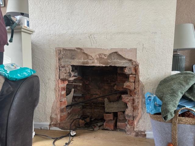

  1. Awesome so look for the fireplace and all will be on there?

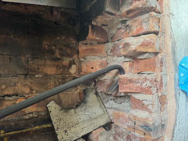

  2. Hi guys. Has anyone got the up to date information for fitting a log burner. Just need to sizes to get cracking on mine. I’ve found this one if it’s correct. Also I’ve looked in the hetas website but couldn’t see anything

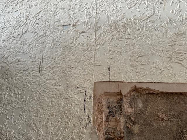

  3. It’s my kitchen on the other side of that wall.

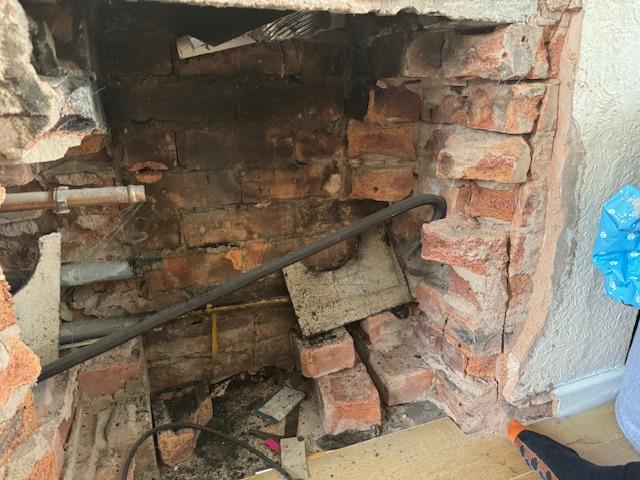

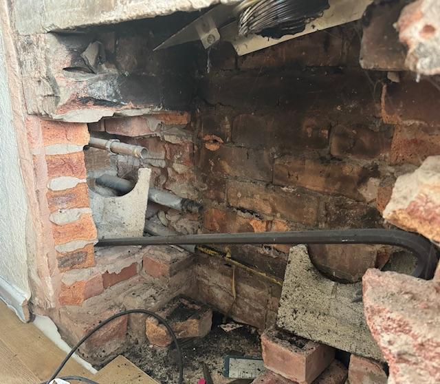

  4. Do you mean the way the bricks are taken out/left in or build a new support?

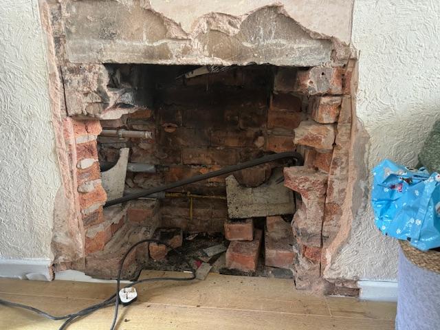

  5. I was going to screw in a temporary beam above and fill in the holes later. Would removing any of the bricks down the right hand side be an issue? (The side without the pipes)

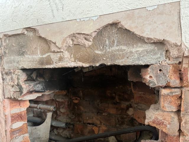

  6. I’ll be putting a new lintel in which is wider than the original. The one that’s in slopes up at the back. I’ll be making the gap a little bit wider for the regs
  7. Hey. The guy who lived over the road gave me some advice when he did his. He was in the building trade. Like I said in the first post it’s the right hand side that I want to be safe and not have bricks falling down Rich

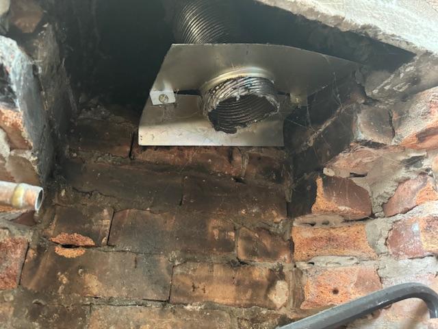

  8. Hi guys New to the forum. I’m going to be installing a wood burner. The hole was already there but the previous owners had filled in the gap. I’ve knocked it out to reveal what’s in the pictures. I’m looking for information on what you guys would do. I will be installing a lintel and doing the work myself. I’ll be getting a qualified person in to fit the flue and all those bits. One side of the wall (the one with the gap behind) I can straighten that but the other side will it be ok to knock out the bricks and fit with a lintel?
