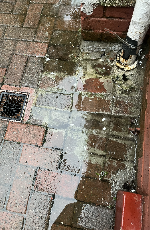

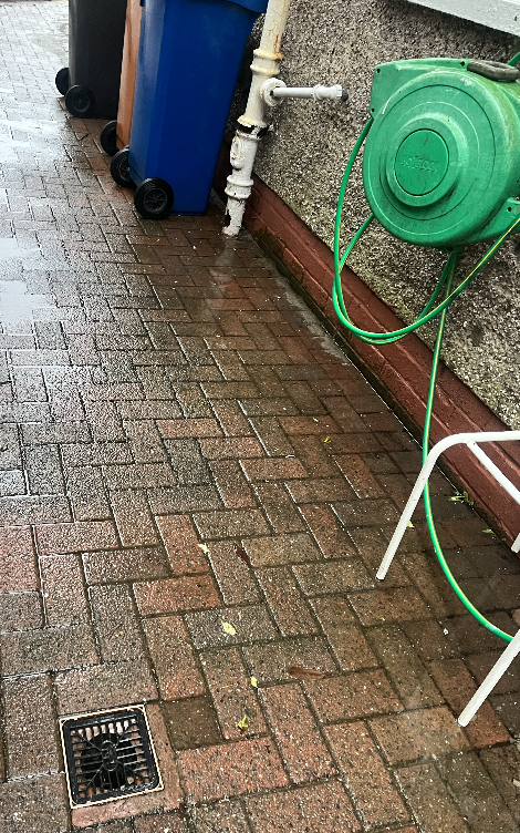

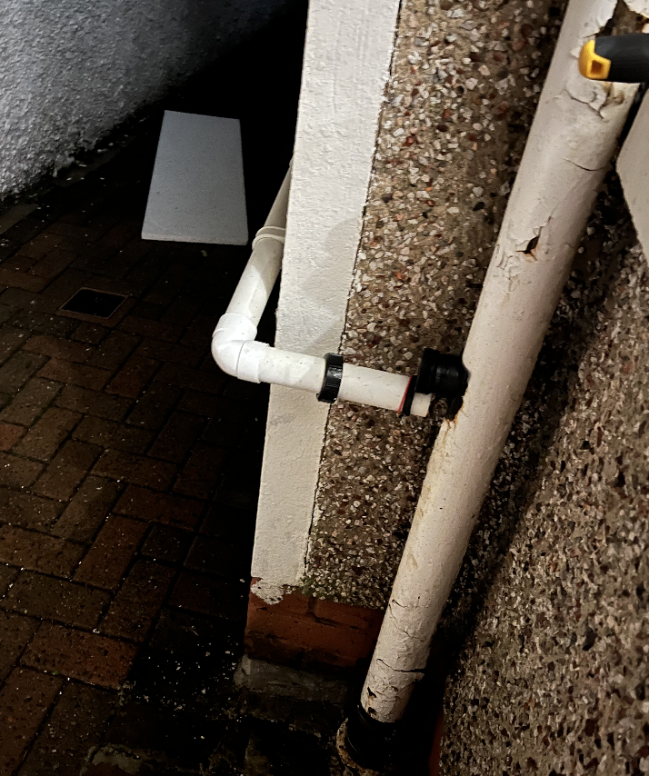

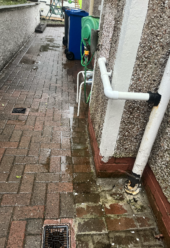

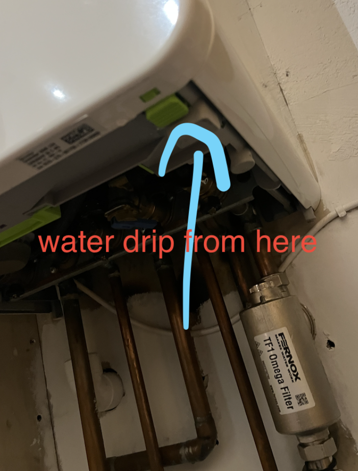

  1. Thanks for linking them together; that was the trigger. The pipe was cleaned and there is nothing inside, also a filter is added in the gutter to stop leaves into the pipe. I can;t see what is underground but i believe it is fine since I used my garden pipe to pour water through the gap for a while, seems nothing is below.
  2. Indeed, that should be solved as well.
  3. That is a boiler pipe.
  4. Thanks Dave. The downpipe is only connected to the gutter for rainwater. I saw the reason the pipe (not the drain) was blocked: there are trees around and the leaves dropped in the gutter and blocked the pipe. Now it is fine (though all leaves are flushed down through the pipe).
  5. Hi everyone, I’m looking for some advice regarding a drainage issue beside my house. Rainwater tends to pool right along the external wall after heavy rain. The water usually drains away within about 30 minutes after the rain stops, but during the rainfall, it clearly sits lower than the nearby surface drains, so it doesn’t flow into them. The block paving along the wall appears to have sunk slightly over the years. I believe that when it was first installed, the paving would have been level or slightly higher than the rest of the driveway, but now the row closest to the wall is slightly lower. There are no cracks in the wall, and the property has a suspended timber floor with a ventilated crawl space underneath. The wall is a cavity wall. My main concerns are: Whether this amount of sinking is typical for block paving over time. Whether water pooling against the wall (even if temporary) could cause long-term damp issues or subsidence. Whether re-levelling a few rows of blocks would be the best solution - I am thinking to DIY. At the bottom of the downpipe there is an opening/gap (a plumber cut it previously when the pipe was blocked). I have temporarily covered it with tape, and water does not leak much from there, but I would like to know the proper way to seal or cap this gap in the long run. I've attached photos showing the pooled water and the relative height difference between the paving and the drains. Any advice or professional opinions and the best way to fix it would be greatly appreciated. Thanks!

  8. Also, compare with the heat loss from the wall and floor, is the draft (even a small one) much more serious and should be treated first?

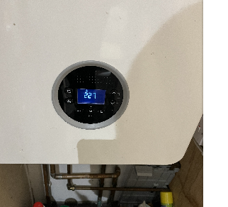

  14. Hello Nick and Dave, thank you for your answers. The boiler came back to work normally this morning. I believe it just dried overnight. Yes, the connection between the pipes is blocked. Last time was the rain water and this time, should be the pipe connection part blocked. I don't want this to come back every year; maybe it is time to look at the pipe and find a solution.
  15. I’m looking for some advice regarding my Worcester boiler which is currently showing fault code 227, which I understand is related to ignition failure. I believe I may have found the cause. The condensate pipe from the boiler is connected directly to an external drain pipe, which seems to be blocked. We had heavy rain today, and I noticed that rainwater has likely backflowed into the condensate line, causing moisture or water ingress inside the boiler. There are some signs of dripping water and dampness inside the bottom of the boiler, although not very severe but i can see water drips in every 10 seconds or so (pictures attached). The same problem happened last year, and at that time it was much serious; the boiler fan was damaged and had to be replaced by an engineer. I watched the engineer to solve the problem. He replaced the fan and then only tried to dry the ignition components, then it worked. This time, I don't think the fan is damaged. I have turned off the power to let it dry out naturally but not sure if that will work. Do you think it might start working again after leaving it to dry for 12–24 hours, or is it likely that I will still need an engineer to inspect it (e.g. ignition electrode, fan, PCB, condensate trap)? Any suggestions would be really appreciated. Baby in the house so I prefer to solve the problem ASAP. Thanks!
