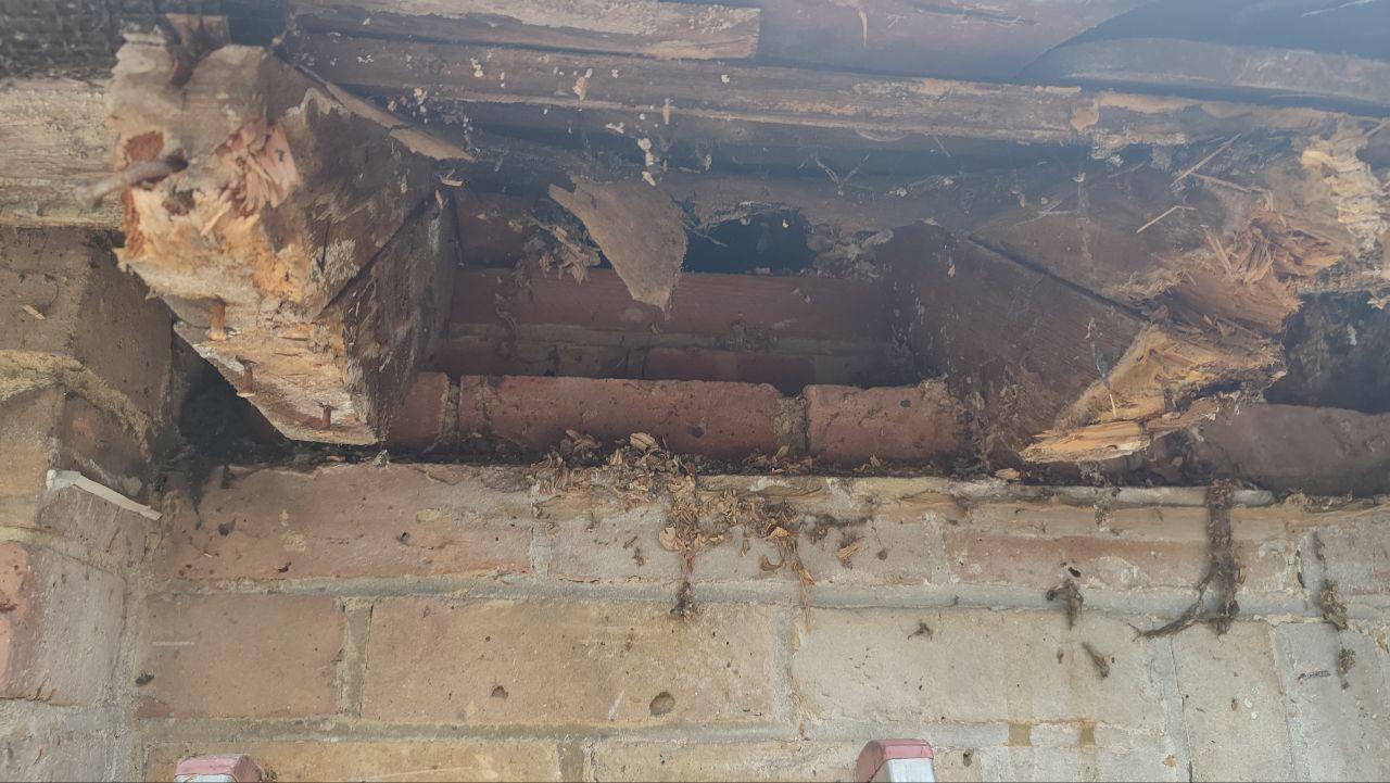

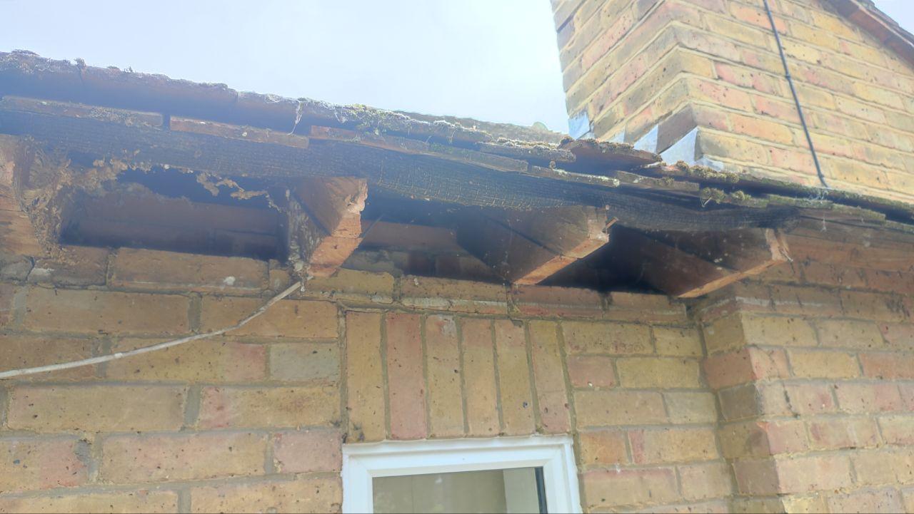

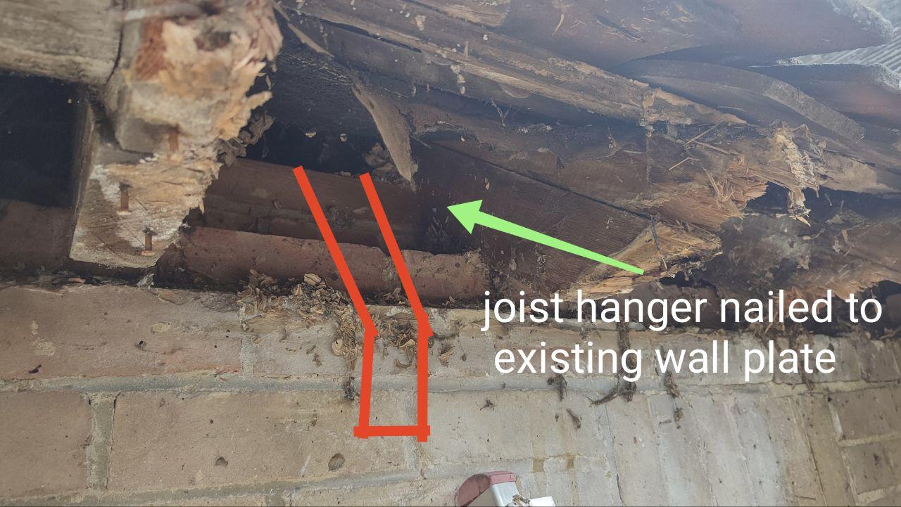

  1. Hi guys, Can you please advise what is the best way to connect flat roof rafters to this existing pitched roof. See photos. I am thinking either remove the top course of facing bricks, put a new 3"X2" wall plate and sit the rafters in top. Or attach joist hangers to the existing wall plate and hanger the rafters off them. Thank you
