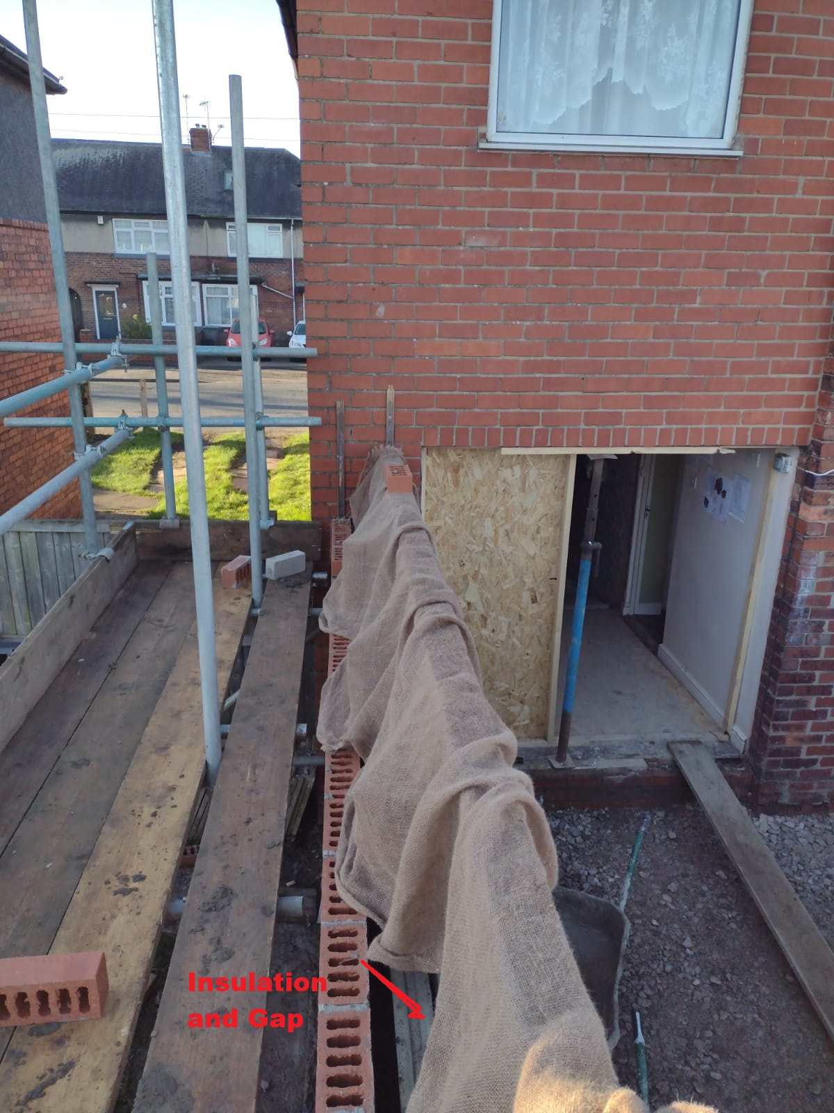

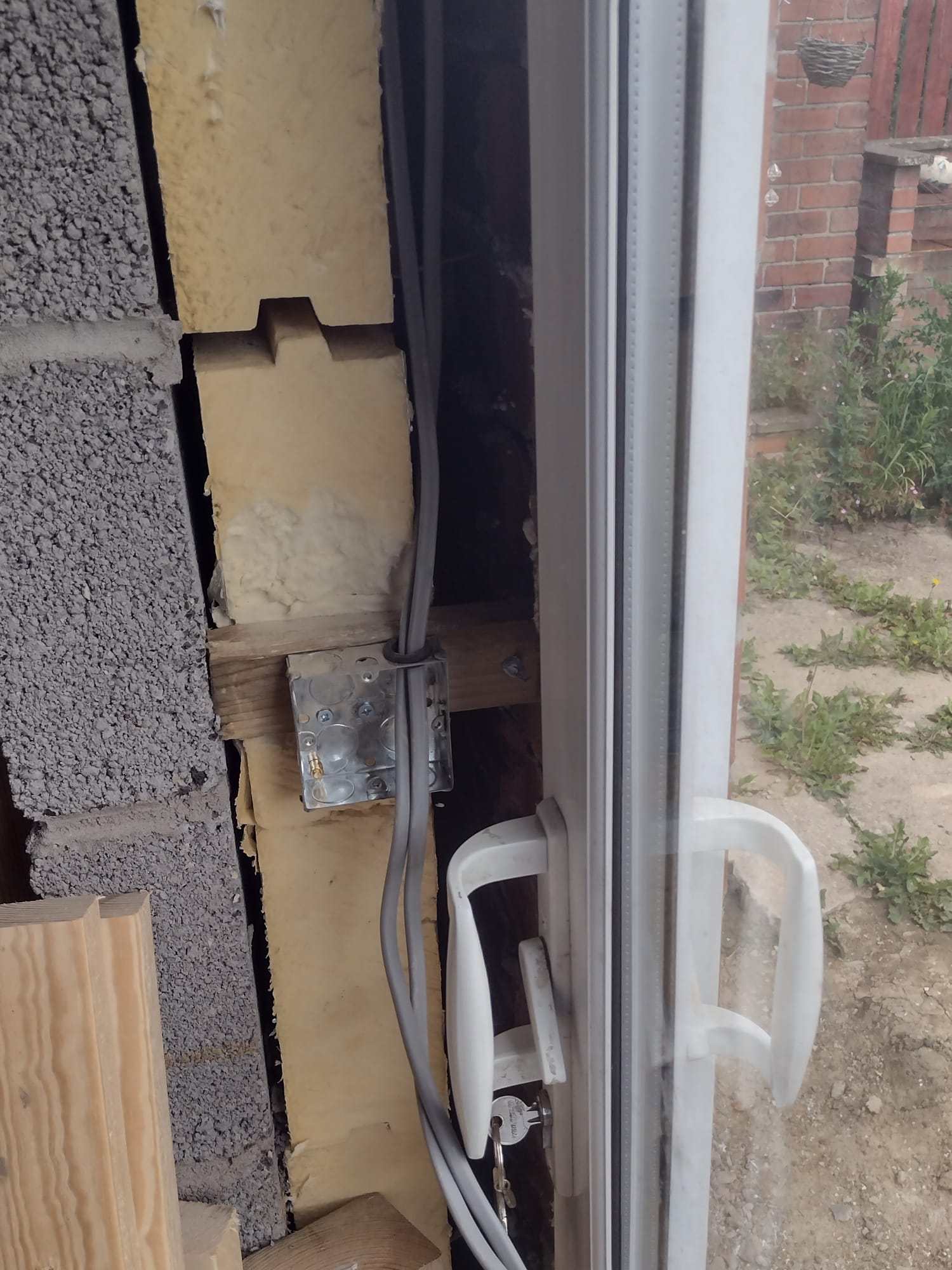

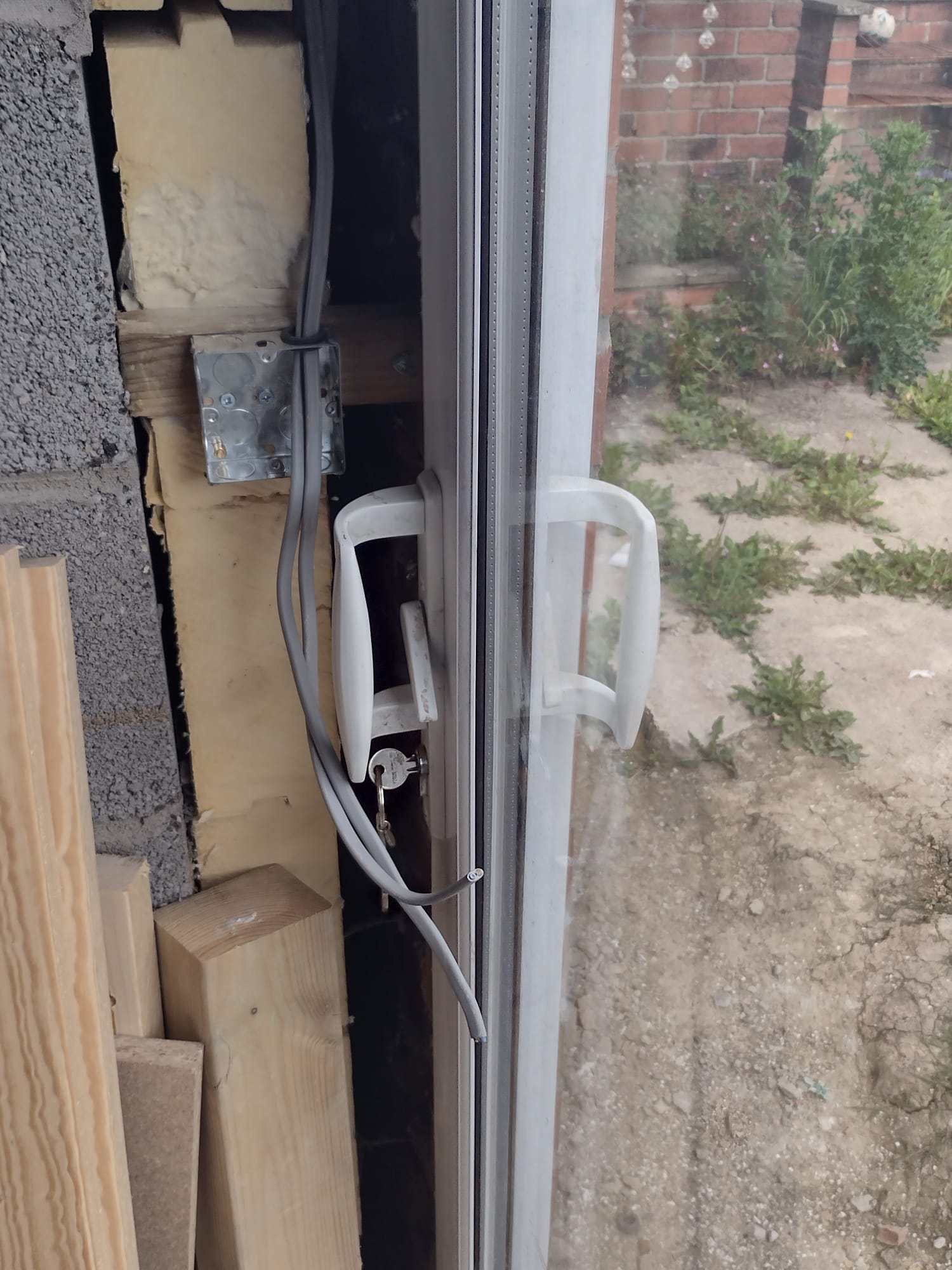

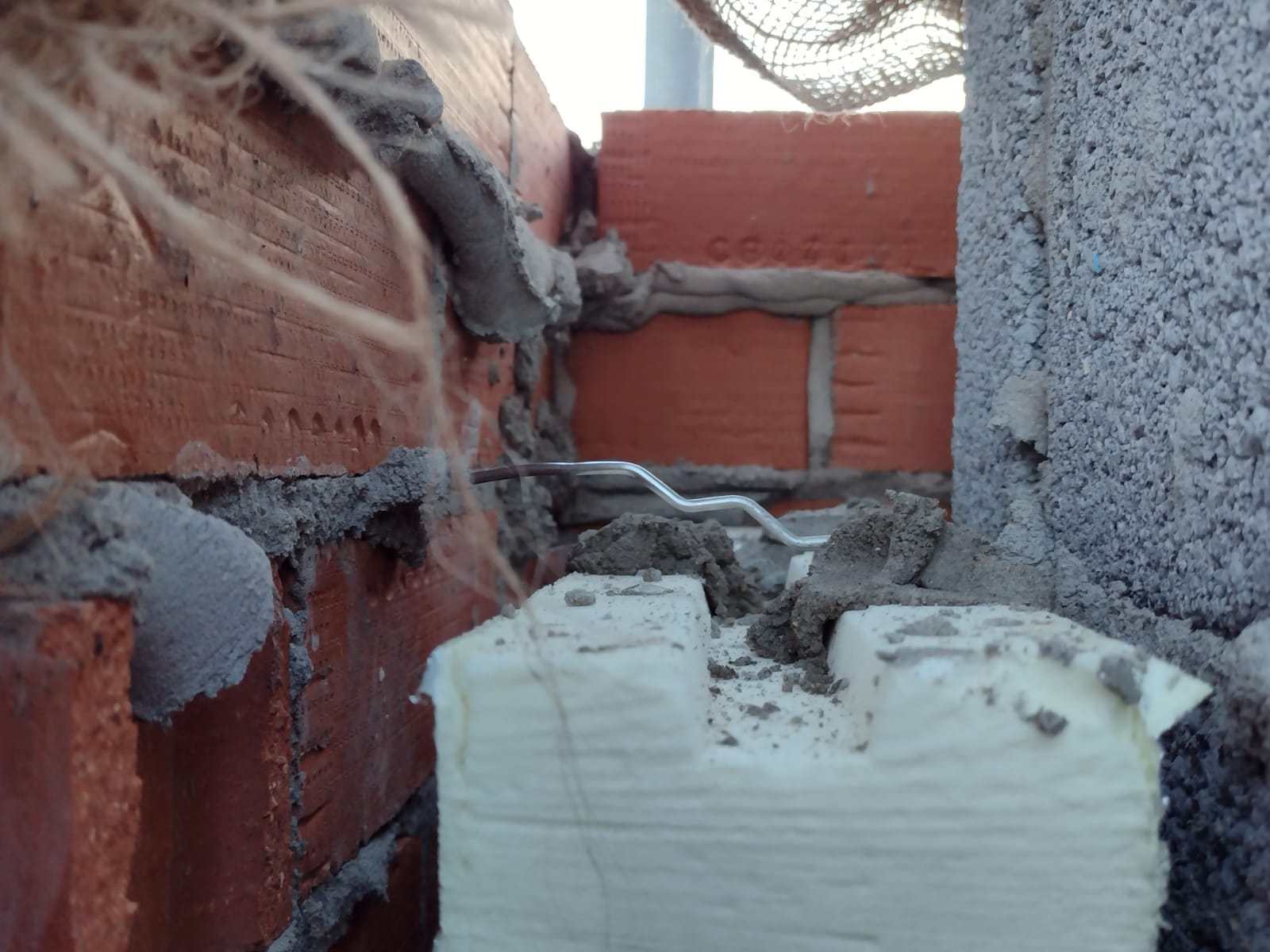

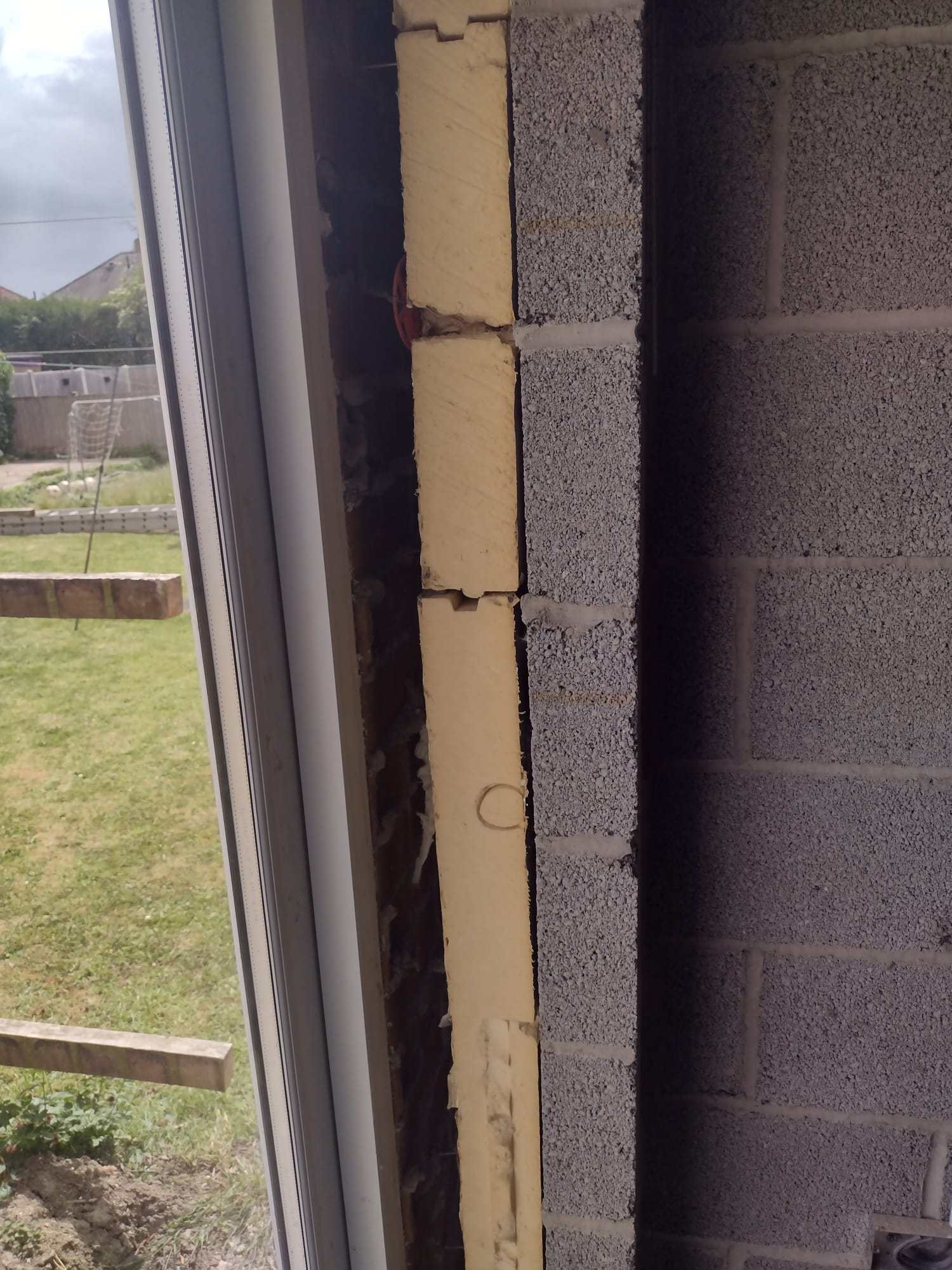

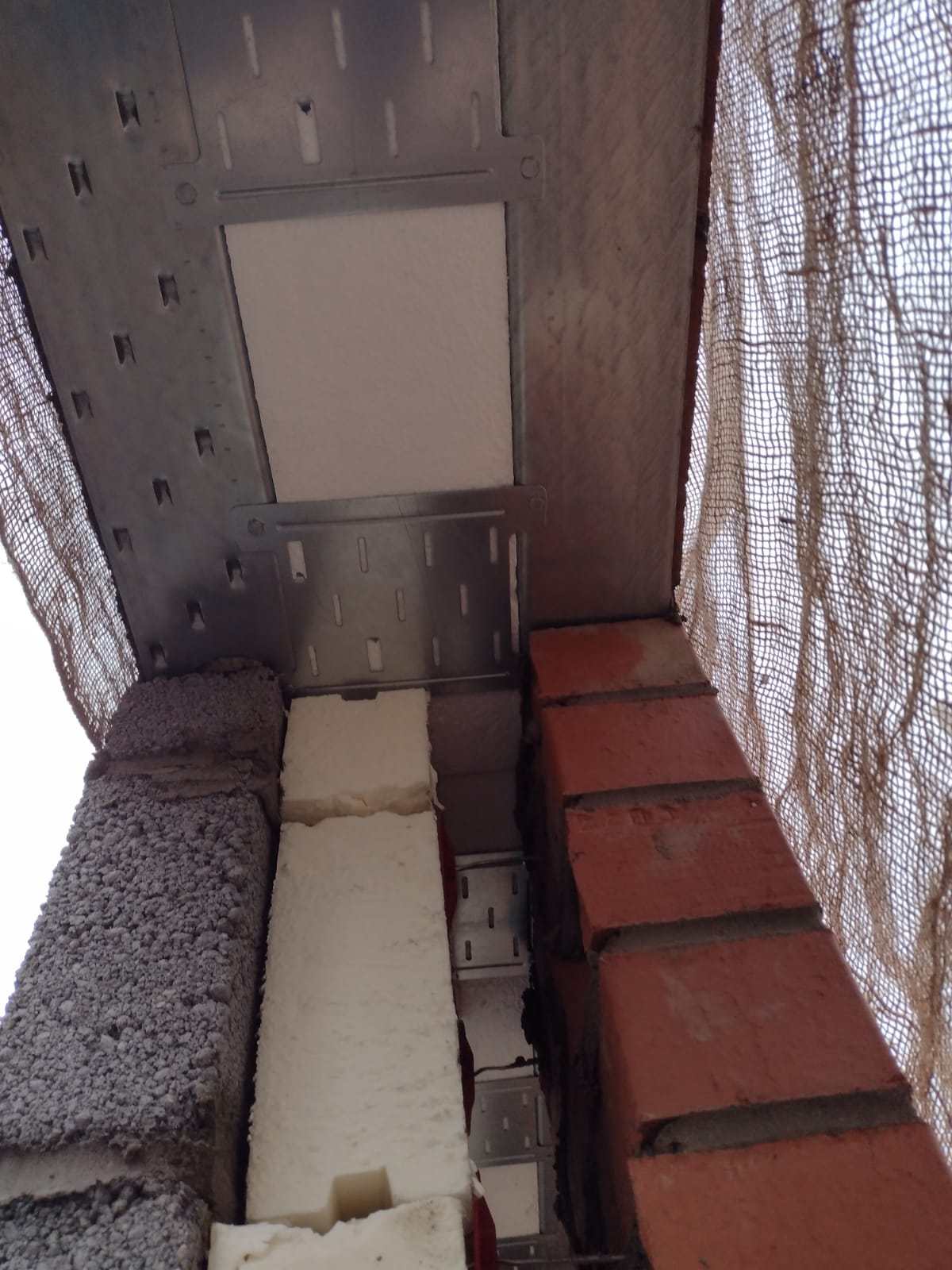

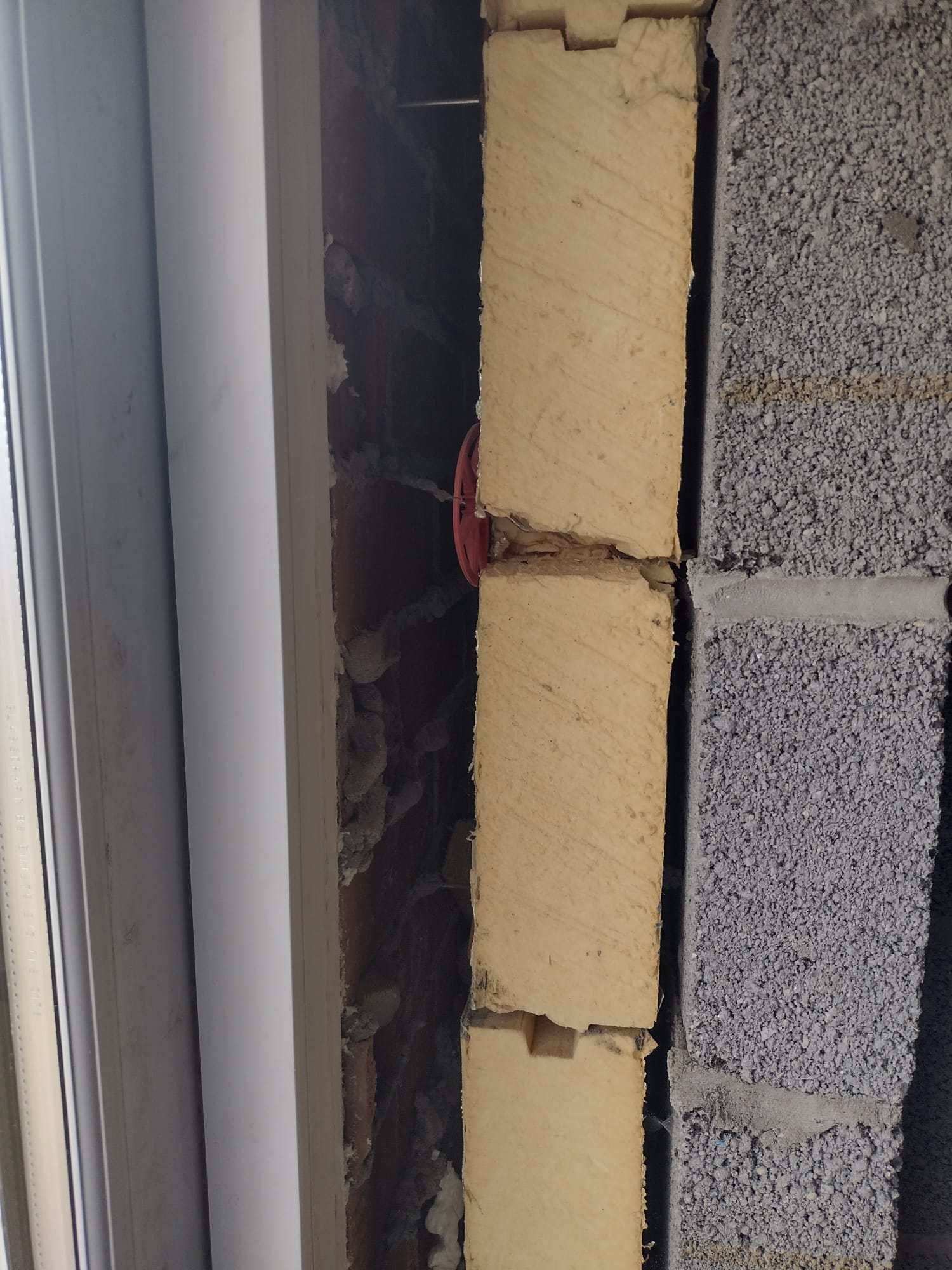

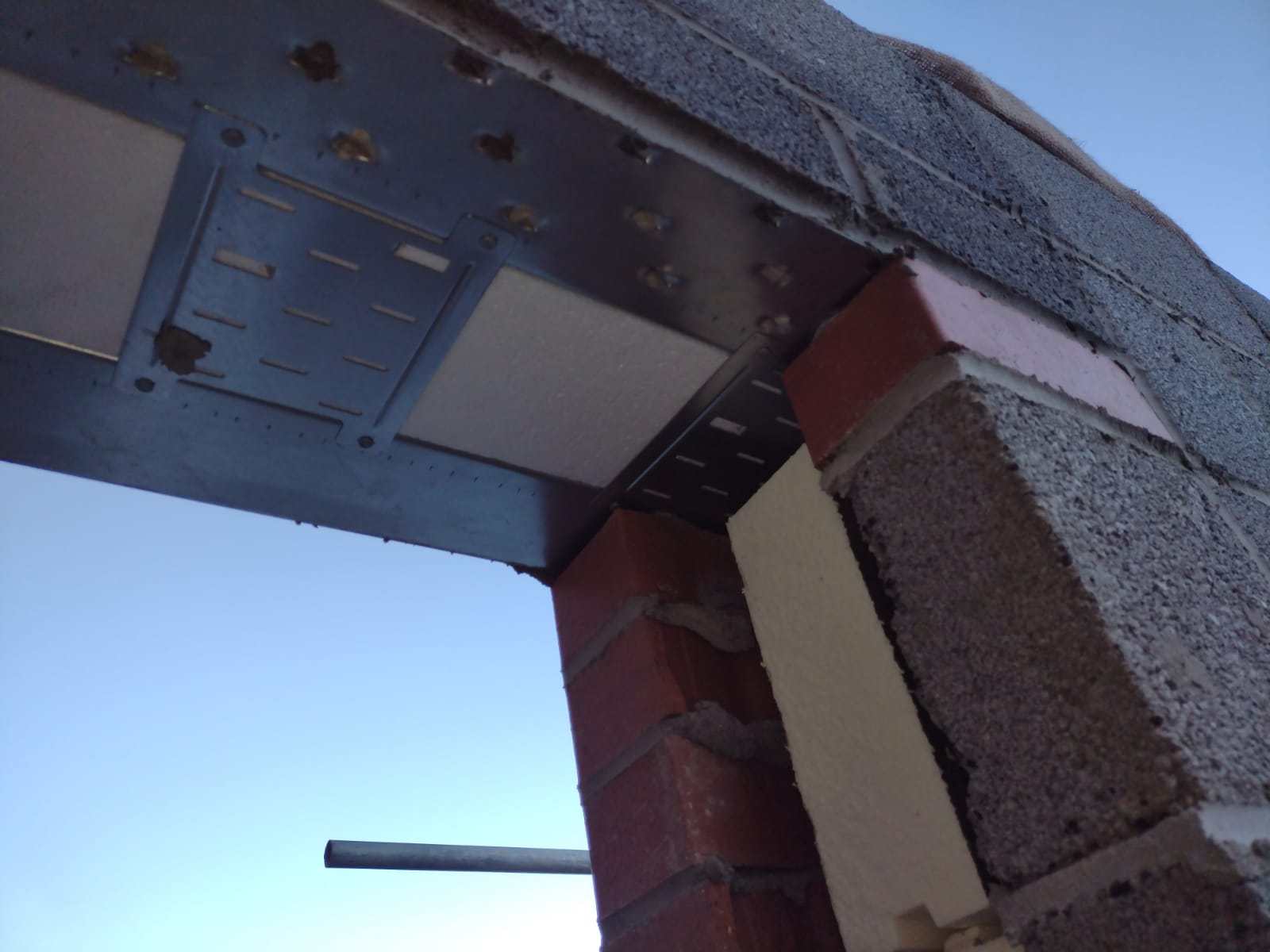

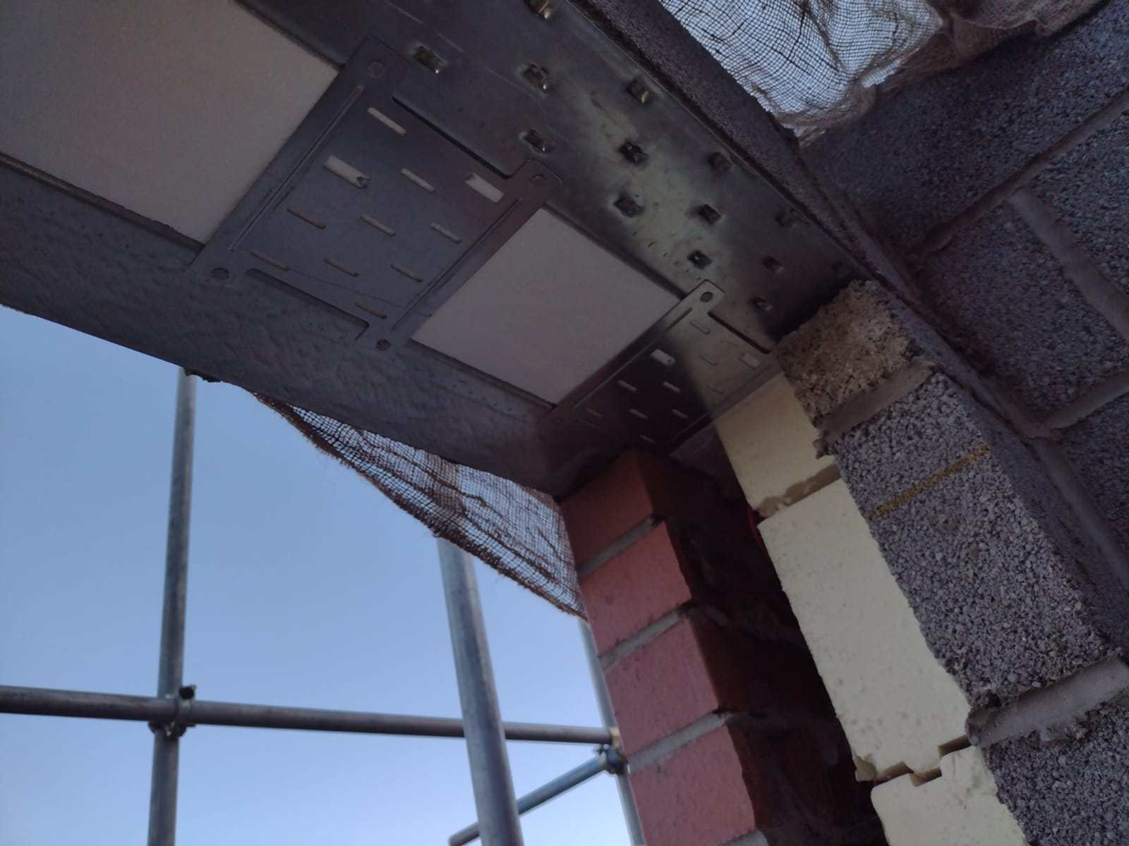

Hi All, From the open ends lot of cold is coming in winter. Although the builder told he will cap them using some plastic strips. Can we put some insulation at the end along the back side of plastic strips to ensure no cold escapes from wall. Note: I believe the open gaps between the wall insulation and wall is for air ventilation and needed isn;t it with regards Mubbashshir

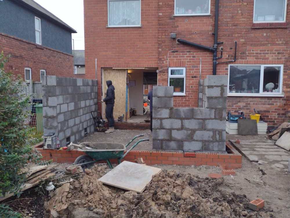

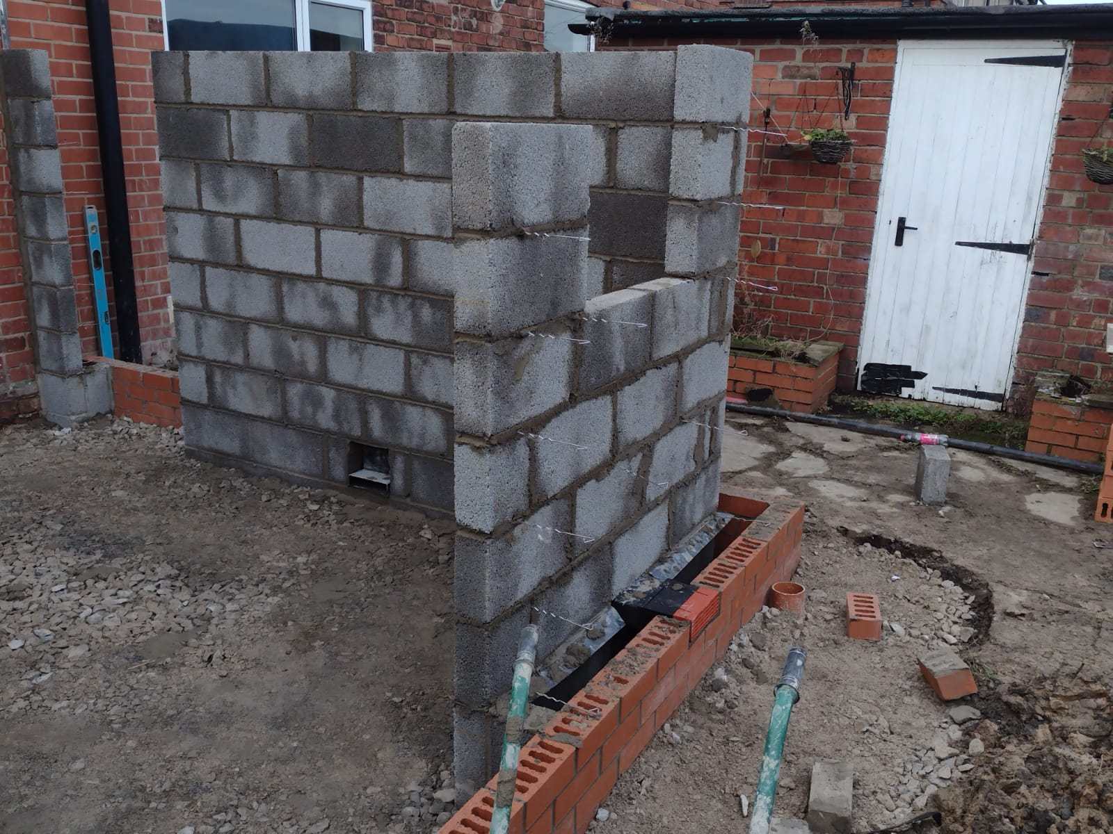

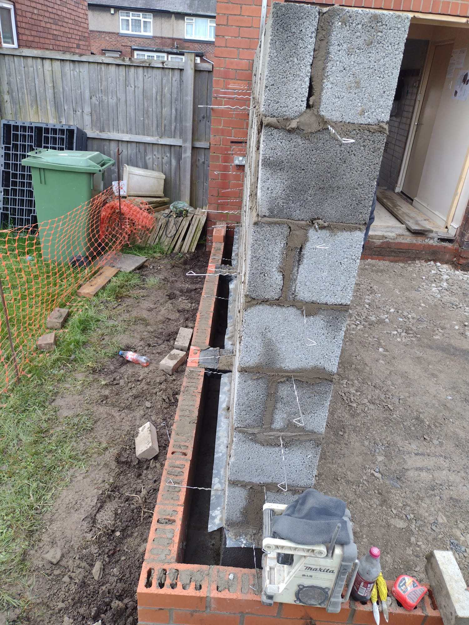

Hi All, I am still working on the final bits with the builder. This small single-storey extension has developed a crack in the soil, although it's a bit away from my wall. However, there are no cracks in my wall or any problems like opening or closing the doors. Please note that this is built over a soil pipe. I am a bit suspicious that the builders might not have put a concrete slab in the way they laid it to bridge the cavity over the pipe. Also foundation is good size i.e. 750 wide mm and 450 mm deep based on calculation done by structural engineer. This crack wasn't there before or may be gradually became more apparent. Also attached are the pictures of foundation which you can see clearly how deep the foundations were. Reasons for cracks: 1. Is there anyother checks to be done on new extension or existing building to ensure this crack does not expand and cause any further problems. What next steps should I inform my builder or insurance company asap
