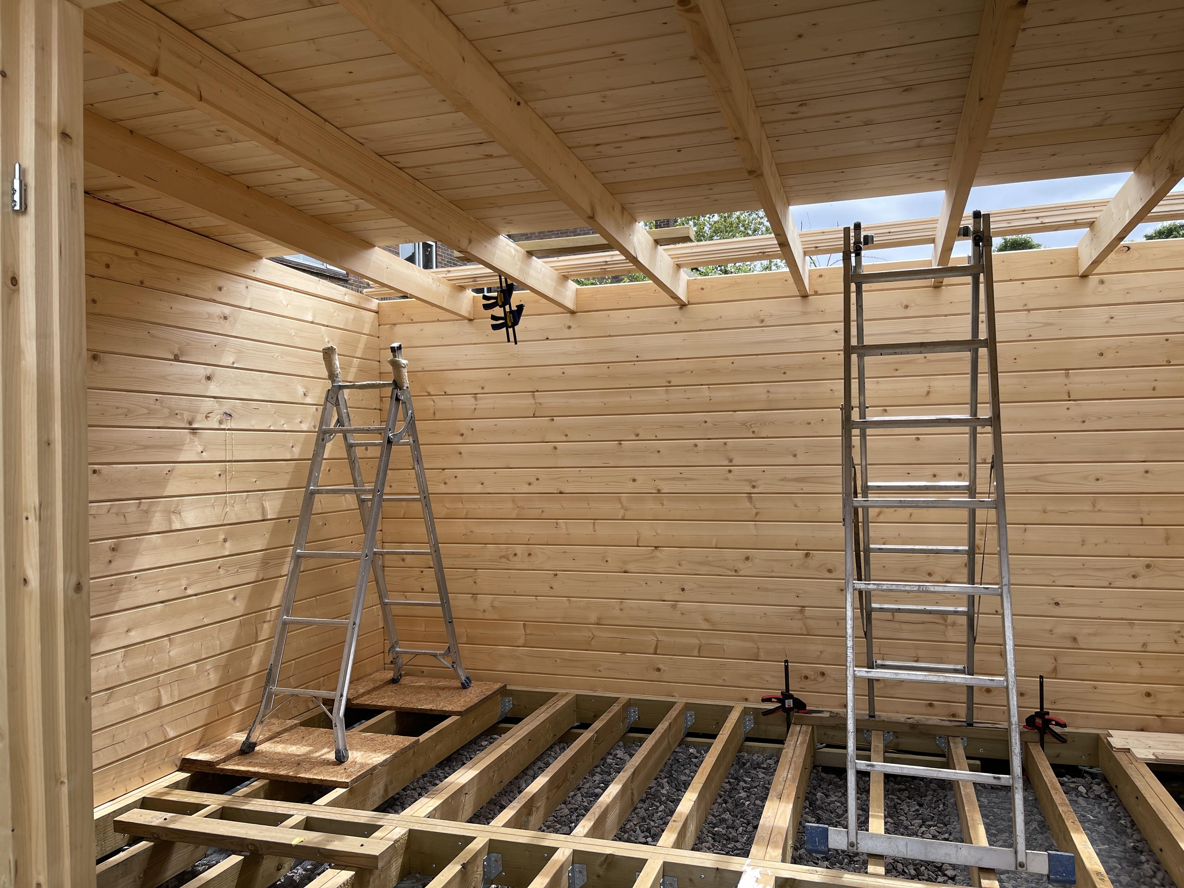

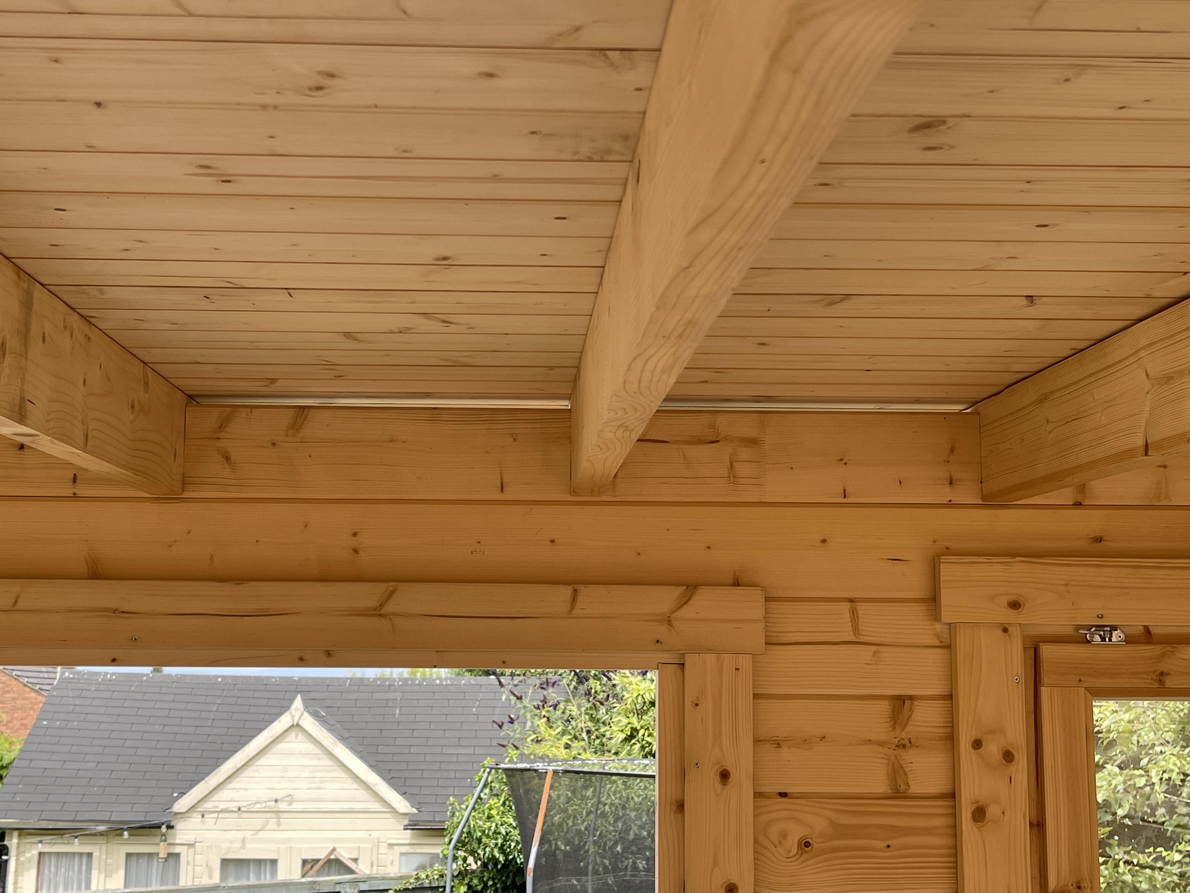

  3. Bottom pic shows my “built-in” vents. Although there’s a little variance between purlin levels, they were never going to be flush. Top pic shows similar at rear wall
  4. @Iceverge Thank you for your comments. Like most other people on this site, I've gone down the rabbithole and become slightly overwhelmed. Warnings to KISS are noted. My saving grace may well be half-decent workmanship, fingers crossed. I do have a couple of queries tho.. Airtightness is all very well, and doable in the floor and ceiling. But Tuin also strongly recommends adding air vents at opposite sides, one high and one low. I can see the sense in this, keeping a small but regular change of air. But won't that negate me spending plenty of time and cash on taping the floor and ceiling? My understanding is lacking here. Or is it subtler? I want to keep moist air away from places it could condense and become trapped (within layers of the floor or ceiling), but inside the building overall, I want moisture inside to balance moisture outside? Cold roof seemed the best option for this cabin, what with height restrictions for permitted development. And as I've made progress on the roof, I see it also has "built-in" vents front and back.. I hammered those purlins down *hard* too - I'll post a pic shortly. To be honest, right now I'm still wavering on how to do this. I'm just so tempted to use PIR! But I still have some time to decide.. For the floor, the eco-build schedule does make sense - clear instructions, I can save some cash by using alternates to Solitex Plus and Proclima DA, and if I follow those instructions well, I can be confident jobs a good un. Even if I'm spending more and getting a lower U value than I'd have with PIR. For the roof, I have no problem with attempting a mirror of the floor, using a membrane either wrapped around the joists as per the floor, or individually fixed like this but fixed lower to keep my airgap. Then either jute and a membrane; or jute, membrane, PIR, t&g ceiling (however that would work). I also know I should, at some point, insulate the walls. But I need to get back to work at some point, so that might have to wait. I've also not thought about voids to run electrics through, hoping a solution would present itself while I'm working on something else.. On the whole, I am finding this fun, most of the time. Plenty to learn and the principles and benefits of good insulation are kind of fascinating. Very helpful to have people such as yourself on this site to bounce ideas off, or just say "stop overthinking and crack on!"

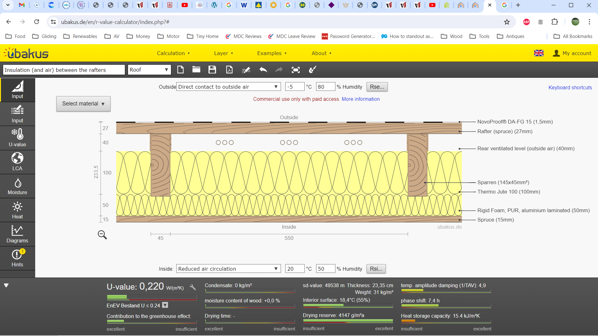

  5. No worries! This is what I was thinking of.. Not sure how to put a vapour barrier in here yet (or why Ubakus doesn't flag this), but this is pretty much how my roof would look if I were to use thermo jute and PIR/PUR
  6. I was thinking of the Ubakus models of slab insulation between roof rafters, then a complete layer of PIR beneath. I'll see if I can find a pic..

  8. Even the government says PIR isn't breathable - so it must be true. TLDR: "Second, impermeable materials made from petroleum products: phenolic foam, PIR, PUR and EPS. These offer broadly similar performance, and do not breathe, which is an important consideration for moisture control" It's a bummer, given the difference in insulation value and cost compared to wood fibre etc., but I wouldn't believe a timber framing company with a vested interest. Even looking at the major suppliers for Celotex you'll find on Google, I'm not seeing anywhere in their blurb that it's breathable. You can draw your own conclusions.. This also makes me wonder why some people are using a layer of PIR beneath slab insulation. How does this work with moisture? I must be missing something, because I'd still love to use it for the cost and insulation benefits. Yes, too late for a different roof system. Many, many nails have already gone in.
