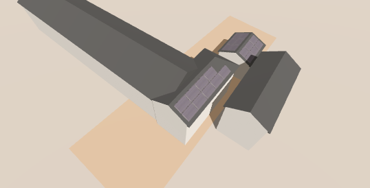

  1. Hi guys, I am looking for some advice in choosing one of these 2 options Option 1: 6kw Polar S Hybrid Inverter for 2 strings 4 Tigo Optimisers on the garage roof for shading issues An additional 3.6kw Solax String Inverter connected directly to the grid for the 3rd string Total system capacity: 9.6kWh (6kWh + 3.6kWh) Option 2: Single 6kw Polar S Hybrid Inverter Both garage roofs are on 1 string 12 Tigo Optimisers are required due to different roof orientations Total system capacity: 6kWh Common elements: 21 x 435w Jinko N Type All Black Panels 5 x 5.2kwh Batteries = 26kwh Total Capacity Same price for both options
