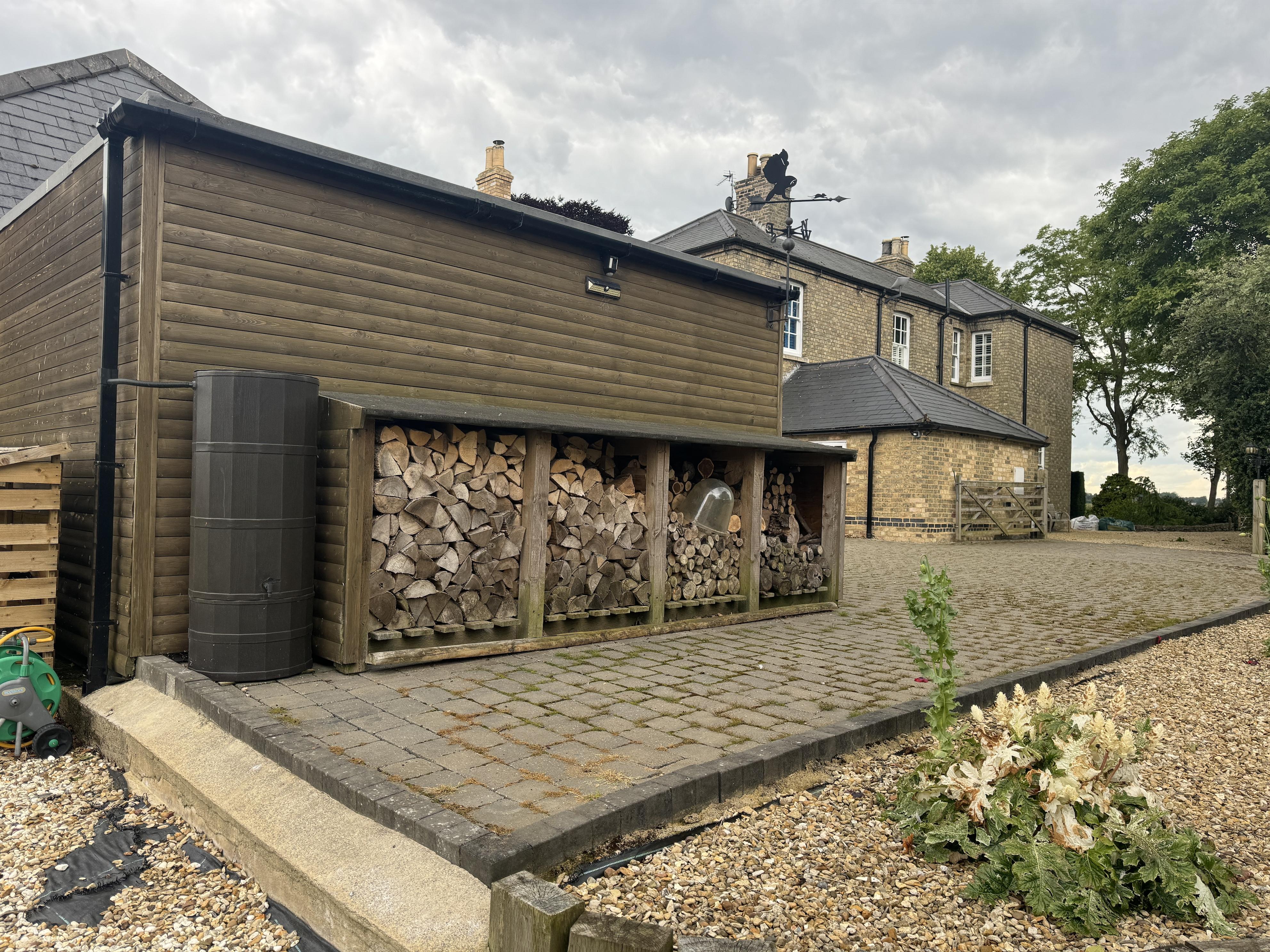

    2

  1. Many thanks for your advice, very helpful. It will be approx 2.3m high on the side that adjoins the existing building and a little less on the other side to create a suitable fall for the roof.
