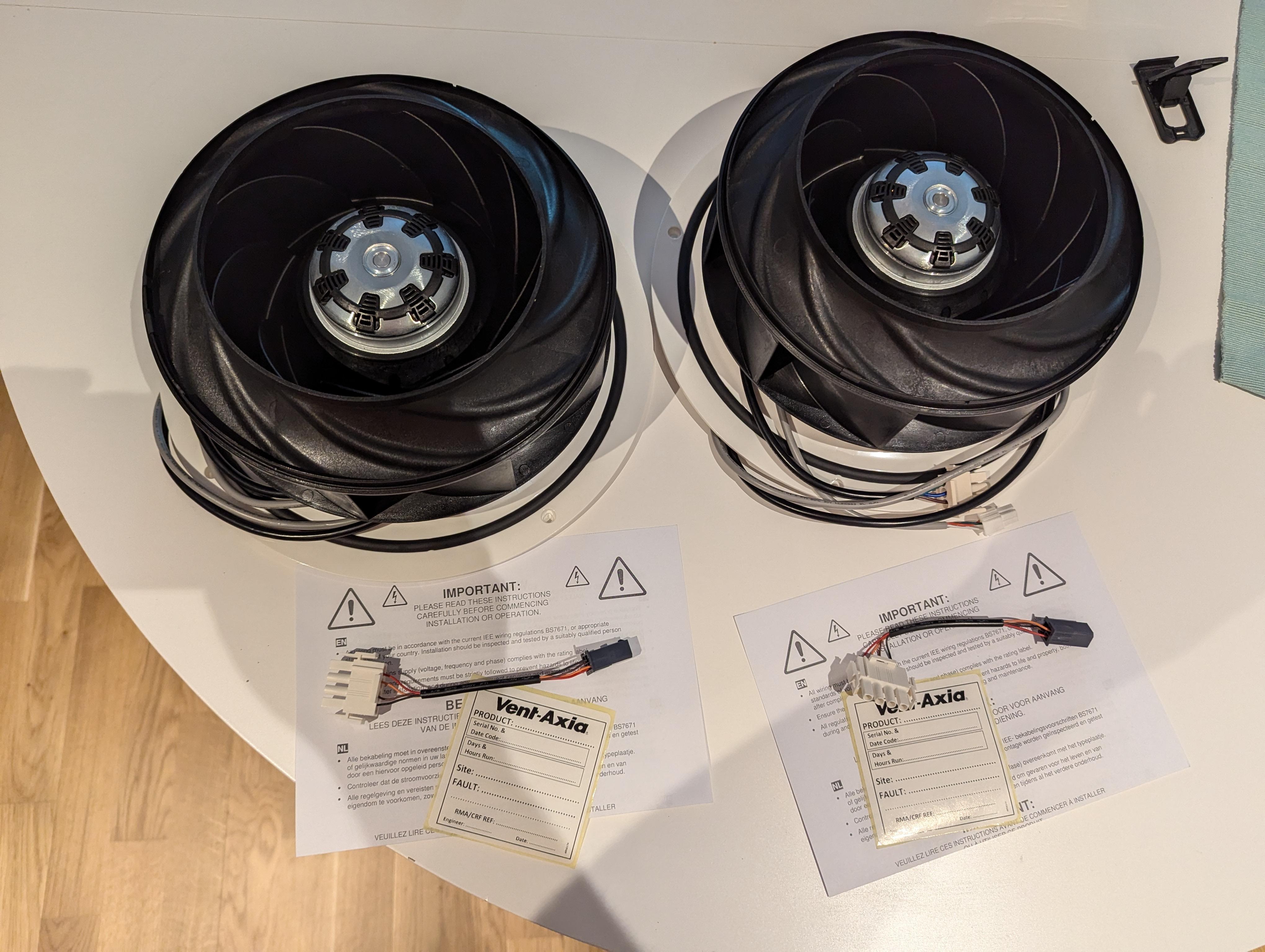

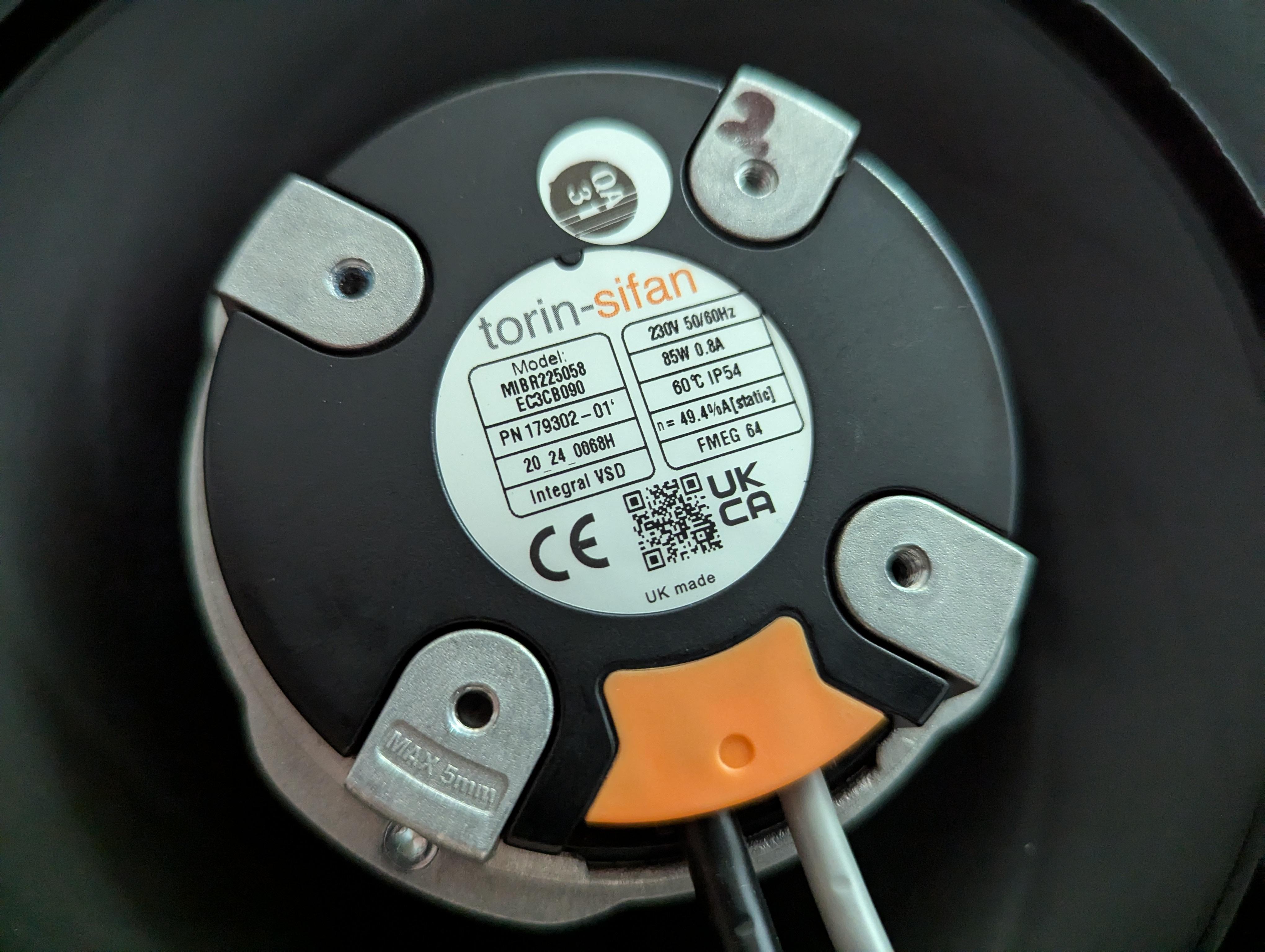

  1. Update: after 3 weeks, vent axia sent the replacement motors. They look like this, from manufacturer Torin-Sifan. I didn't manage to remove the old fans yet, as the unit is built into a very difficult position in my flat, and I will need another person so we can remove the unit, and the old motors with the dodgy bearings.

  5. Update: Vent Axia confirmed it's a bearing issue, after I shared the details and the video with them. As my unit is 10 weeks away to be 5 years old, they are apparently sending out to me a complete, brand new motor (497818 Motor Assembly & Patch Cable Kit)! Unfortunately they cannot organise a technician under warranty anymore, as the unit is more than 2 years old, however this new part free of charge is already reassuring. I will update this post after I received and installed the new part to share my experience. However so far, Vent Axia handling the situation prompt and very professional.
