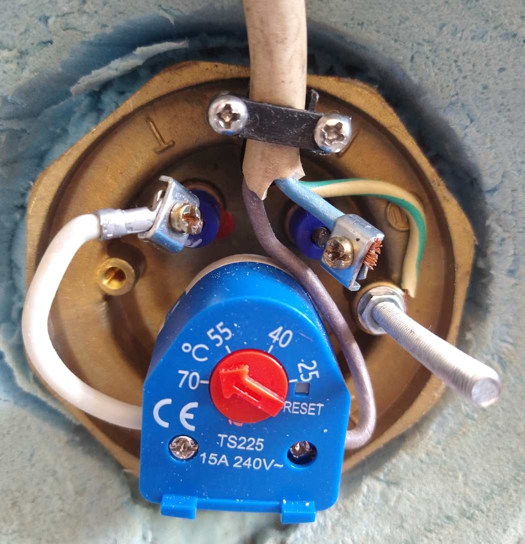

Initially, I'm renewing the thermostat in the lower immersion heater, with a different make (a Backer to replace a Tesla). A continuity test on the element gave me 21 ohms, which I understand is about right. Confusingly, it was working fine last night - heated a whole 162 litre cylinder without tripping. By the way, a note to NickfromWales - I haven't been able to follow your advice about returning the cylinder because I bought the cylinder without any immersion heaters fitted. I bought the immersion heaters from Screwfix, but didn't keep the receipt, so can't return them. -

I've moved the thermostat from the bottom immersion into the upper immersion, and put it on 'Boost'. It hasn't tripped yet, but the upper immersion doesn't stay on for as long as the lower one, of course, because it reaches set temperature more quickly. -

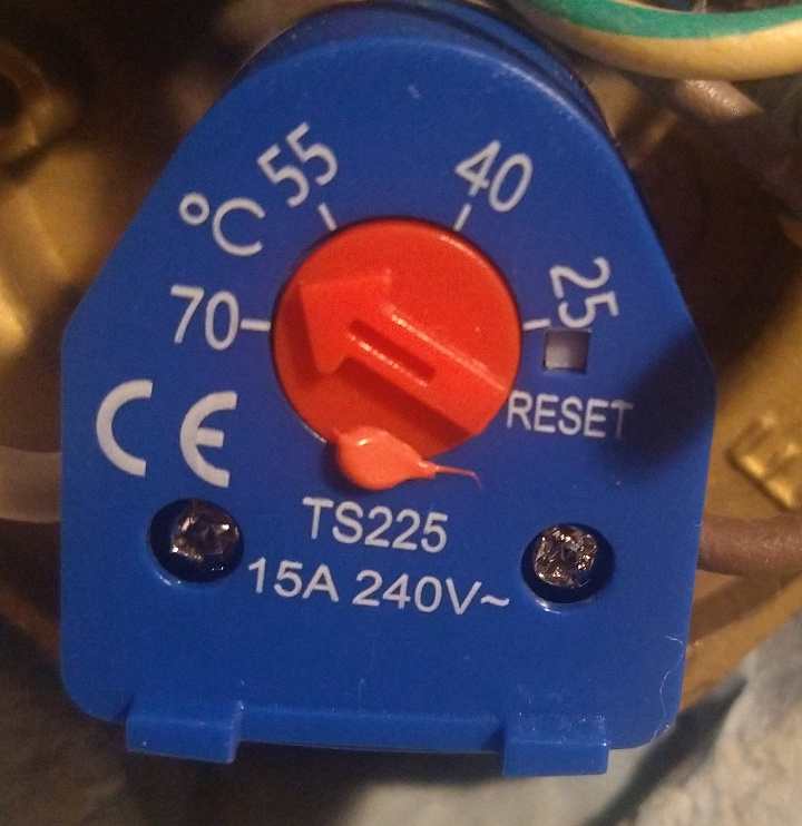

The limit stat is part of the control stat. It's set to about 60/65 now. Will send photo later. Thanks -

The latter, John. The reset button on the immersion thermostat keeps popping out (but stays in for a while after being clicked back) -

The thermostat in one of my immersion heaters keeps tripping. Immersion element, thermostat and cylinder are about 9 months old. Thermostat is set to 65°. This is the lower immersion heater in a dual heater Economy 7 cylinder. I swapped the thermostat for the one from the upper immersion heater, but that tripped at some time during the night. These are Tesla units. I've ordered a Backer replacement, but does the fact that two thermostats tripped indicate that the element is at fault? We live in a hard water area, but the elements are incoloy-type, and nearly new. Any suggestions? Thanks
