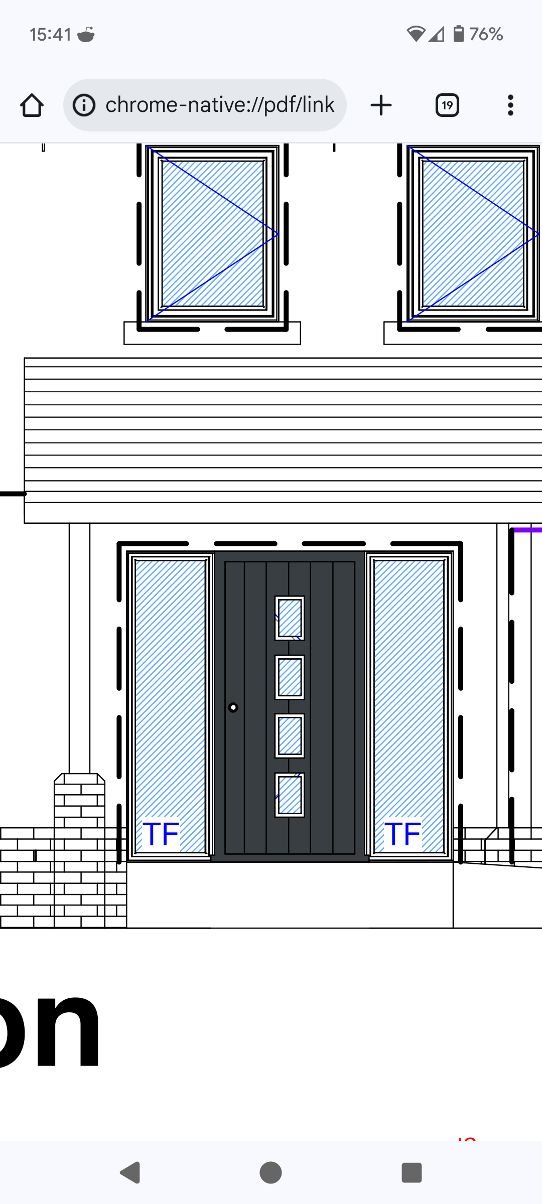

  2. Hi folks We have a nasty galvanised pole supporting our porch roof. Our plan is to create a brick pillar around the bottom of the pillar and the top half oak cladding. I am trying to find the best option to transition between the brickwork and the oak, and at the moment it seems to be a split pillar cap on top of the brick pillar, and then leave a small gap between the cap and the oak to stop the water tracking up. The sort of thing in the picture. What do you think? Will this work, where could I get a split cap, any other ideas etc. Thanks

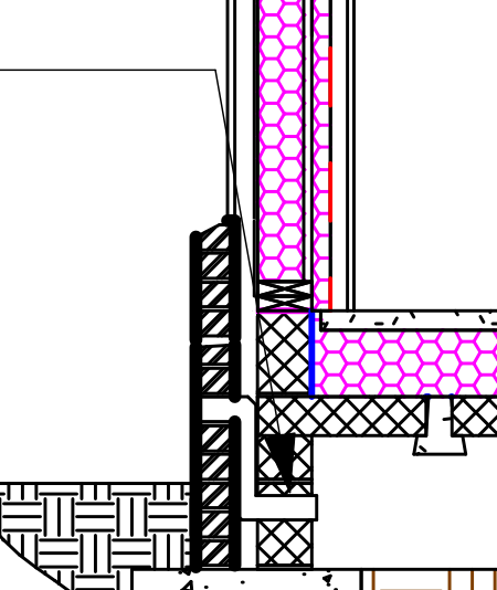

  8. Hi As many, we are starting to run out of money towards the end of our build and would like to postpone the level threshold/ramp element until we have sold our existing house as this is going to be a big invoice! I've had a meeting with BC and they are happy so log as the house is complete with the exception of the access they will give us a Habitation Certificate. Our hope is that with a Habitation Certificate we will be able to get "normal" house insurance so we can move in, although combined with the house being timber framed it could be more difficult. Does anyone know of an insurer/broker who would be able to help. Thanks
