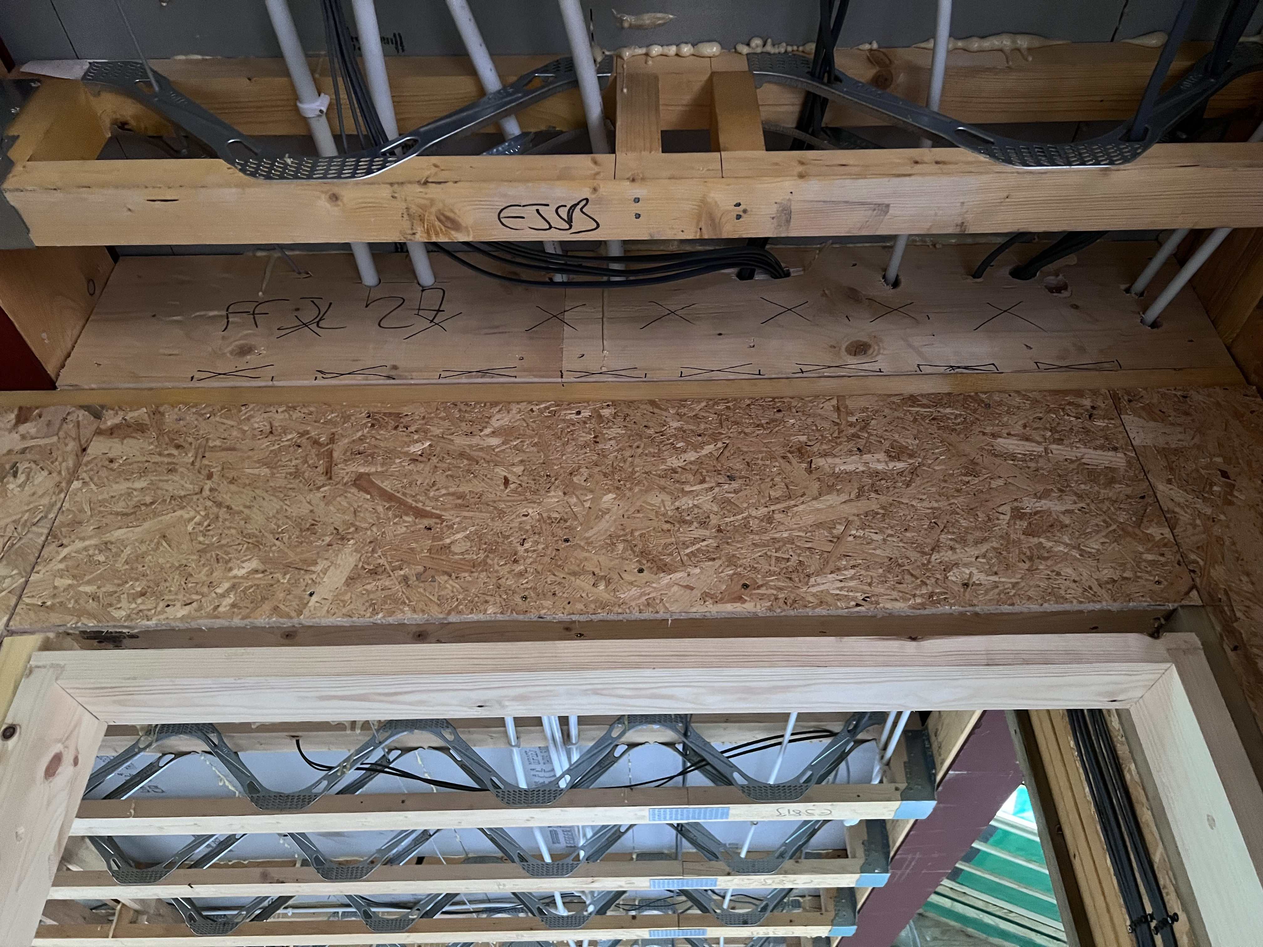

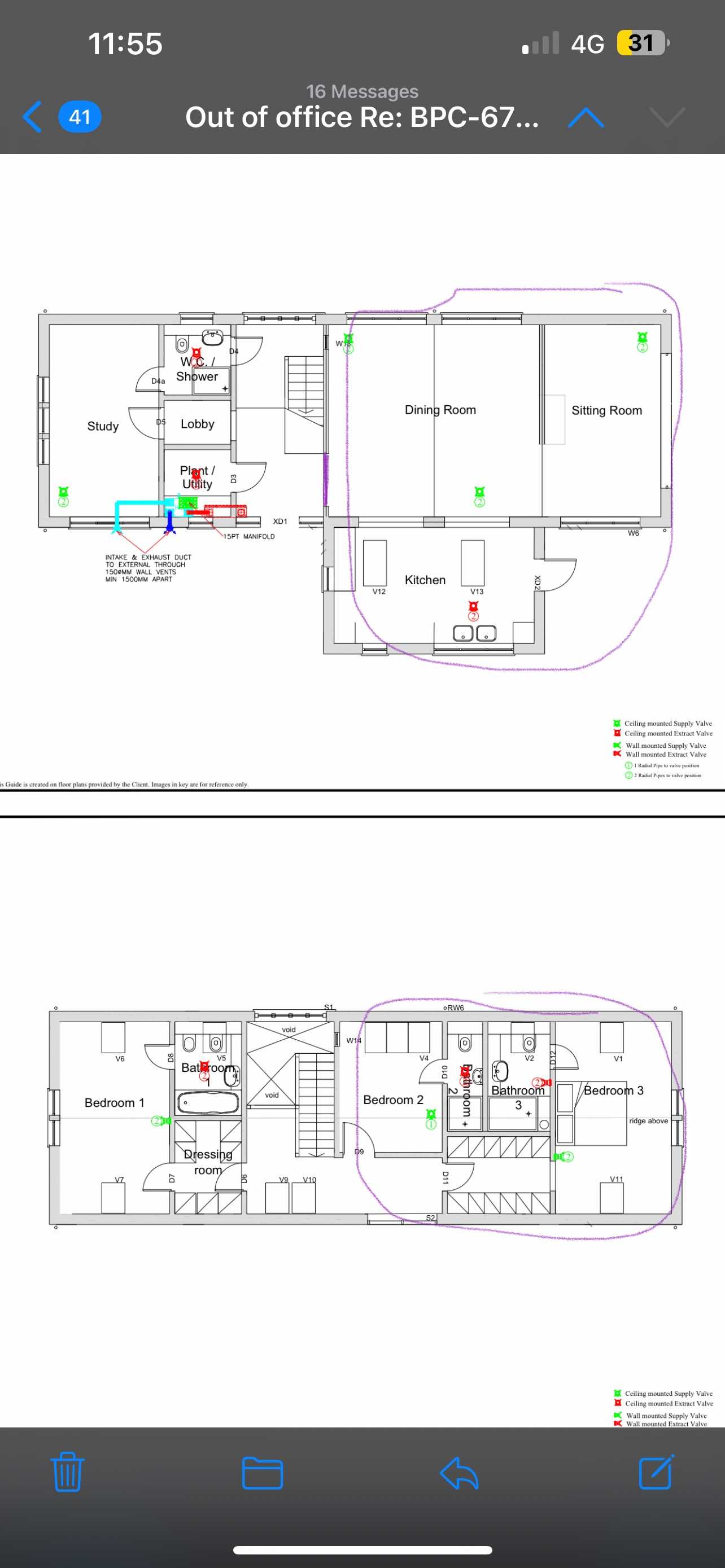

Hello! I have come to a problem that I don’t know how to get around with my DIY installation. I have a wooden beam above a doorway (see picture) and in order to supply the side of the house through the doorway (both ground and first floor) I will need to get 15 of the 75mm pipes through here. I can’t manage this without seriously weakening this wooden beam. There is no other route to the other side of the house. i have attached the floor plans, the purple line is where the wooden beam is and the purple circles are where I’m struggling to reach. Does anyone have any ideas/suggestions?? Can you attach another distribution box to the first distribution box so I only need to get one pipe through? I have contacted BPC who I ordered through for some help but not heard back yet. Thank you in advance!
Thank you for your response! If they can’t be on the diagonal to the door, is it a huge problem or just a ‘do the best that you can’ sort of thing? I think due to the design, it’s never going to be optimal placement here but would it still be better than not doing it at all? I sort of need to have the system now because my windows don’t have trickle vents in. The dining room is large - 36m2 so could that be why it needs two? No flow rates, this is the first design they have done for me and now the guy has gone on holiday which is why I’m posting here! Do you mean an actual sock?? Thank you!!
Hello MVHR friends! I have been lurking on this forum for months whilst planning my MVHR and I could do with some help please! I have attached some plans that I have received from BPC which I don’t think are quite suitable because the upstairs has vaulted ceilings with exposed beams and there is no way for me to create enough space in the ceiling for the pipes, same with the kitchen, there is no space on the vaulted ceiling for pipes. There is also no access across the hallway void to bridge the two sides of the hallway upstairs. Bathroom 2 is no longer a bathroom so no vent needed there and bathroom 1 is no longer an en-suite it is a family bathroom with door to hallway. I have attached the plans from BPC and then marked my own crosses (red extract, green inflow) and purple for the possible placement of the unit. If anyone could help with any of these points it would be really appreciated: 1. Could you help with the placement of the vents if you can see anywhere better for them? I am struggling especially with bedroom 1, bedroom 3 and the kitchen because they can’t be in the ceiling. 2. Would it be better to have two separate smaller units, one to supply the left side and one right? Or one to supply the ground floor and left side of upstairs and another for right side of upstairs? if you have any other suggestions or words of guidance I would really appreciate it! thanks! MVHR1.pdf MVHR2.pdf
