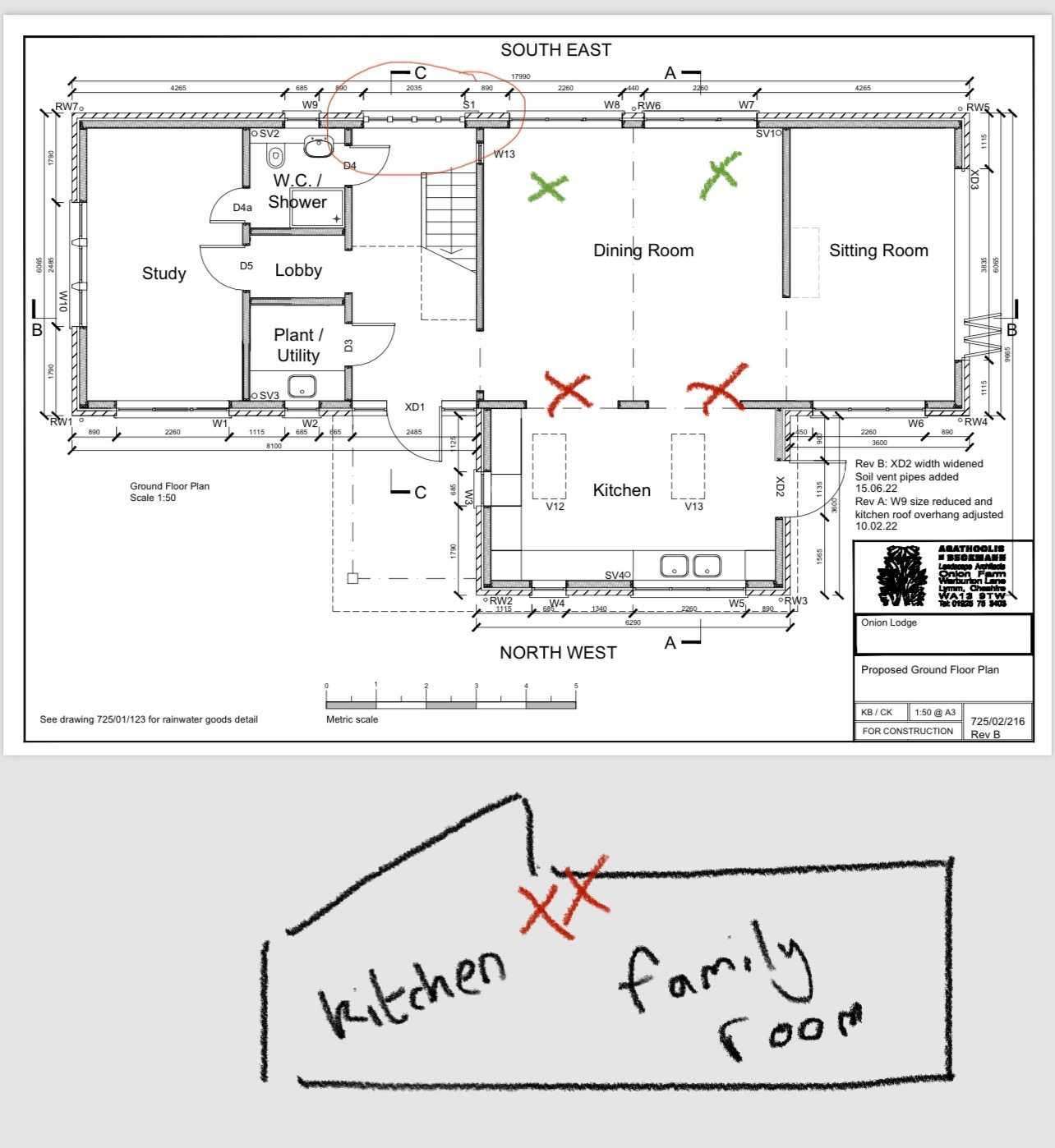

Whilst I’m at it…. Does anyone think this design might not pass building regs for ventilation? We have a large open plan family room/kitchen but the part of the ceiling in the kitchen is vaulted and then back down to the family room (pic attached). Because it is vaulted, I can’t get the extract vents to the other side of the kitchen, the closest they can get is where I have put the red crosses. I am also planning to have a hob with recirculating vent. Are building control going to have a problem with that? -

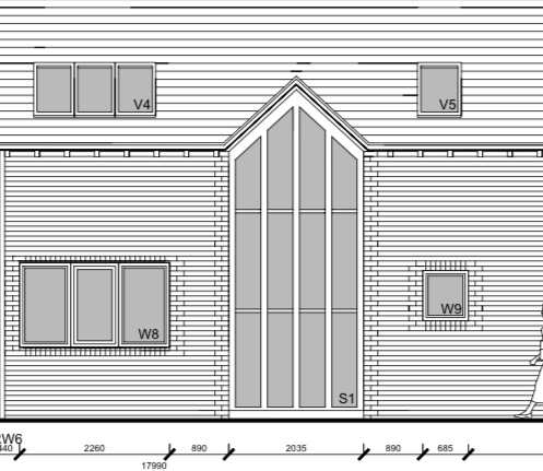

Hello! Everyone here is much more experienced than me so I was hoping for some help to understand the building regs here. We have a SIPs build which will have a single skin of external brickwork. There is a large two storey aluminium framed window going in one external wall. To satisfy building control, do I need two layers of engineering bricks under the window for DPC or can the window sit directly onto the finished floor level? I have attached a picture of the window. Thank you in advance for your help!!

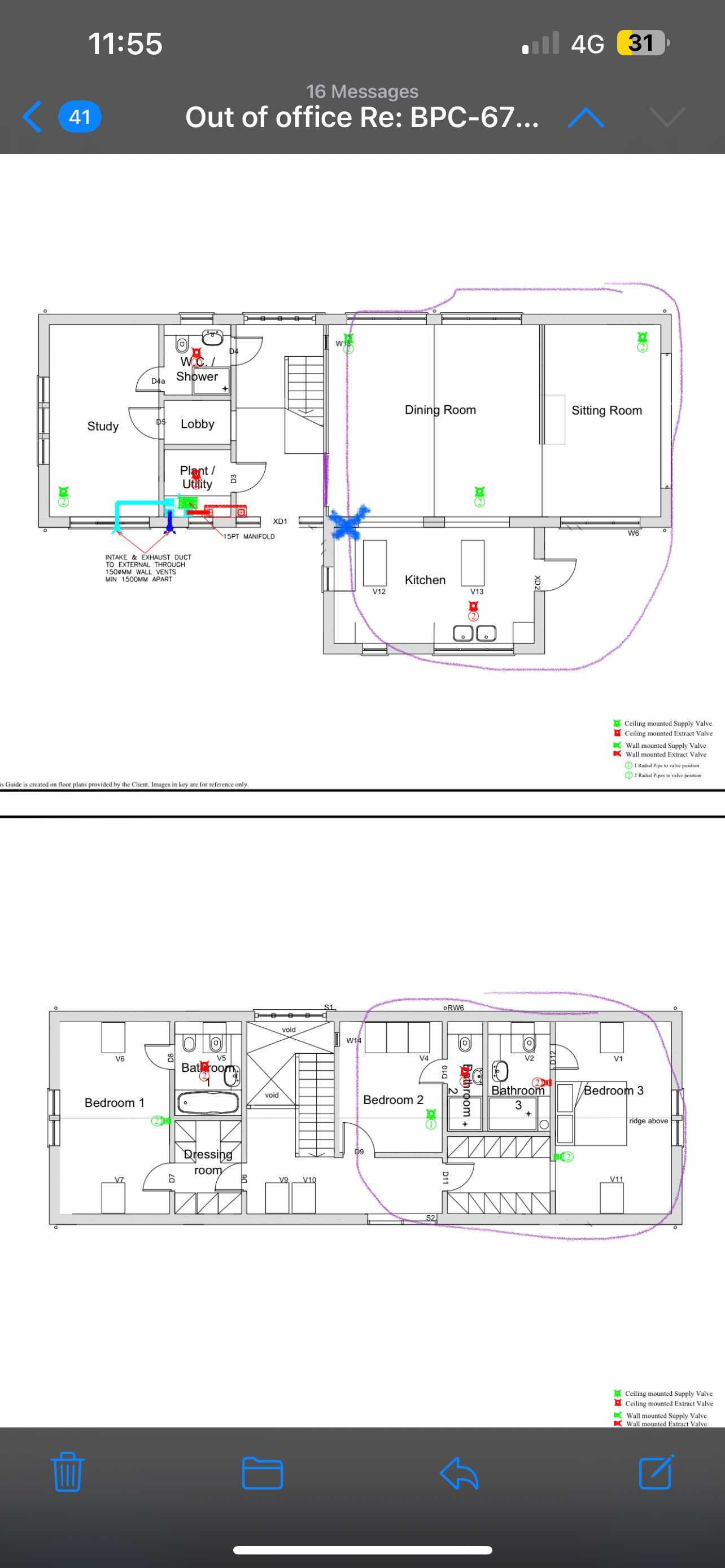

Ah I didn’t know there was a free/paid for option. I just asked for the correct materials and this is the plan that came back. -

Do you think a wall mounted vent here where I’ve put the blue cross would work? Facing into the kitchen? Thanks -

Thanks for your help! We have vaulted ceilings in the hall with exposed beams so can’t run anything up there. I was also thinking it looked like too many ducts - the rooms are large but not ridiculous and the dining room has fairly low ceilings. Maybe I should ask BPC to look at that again. Also I’m not sure why the downstairs bathroom and plant room need double ducts - I was just going to put them in there because I do what I’m told… the kitchen is difficult because again it is vaulted with exposed beams so I told them I couldn’t run anything in the ceiling. I actually think I’m going to have to put those extract ducts just outside the kitchen into the dining room where the column is on the plan because I can’t find anyway to get them into the kitchen otherwise. I have also asked BPC to redesign this if possible.
