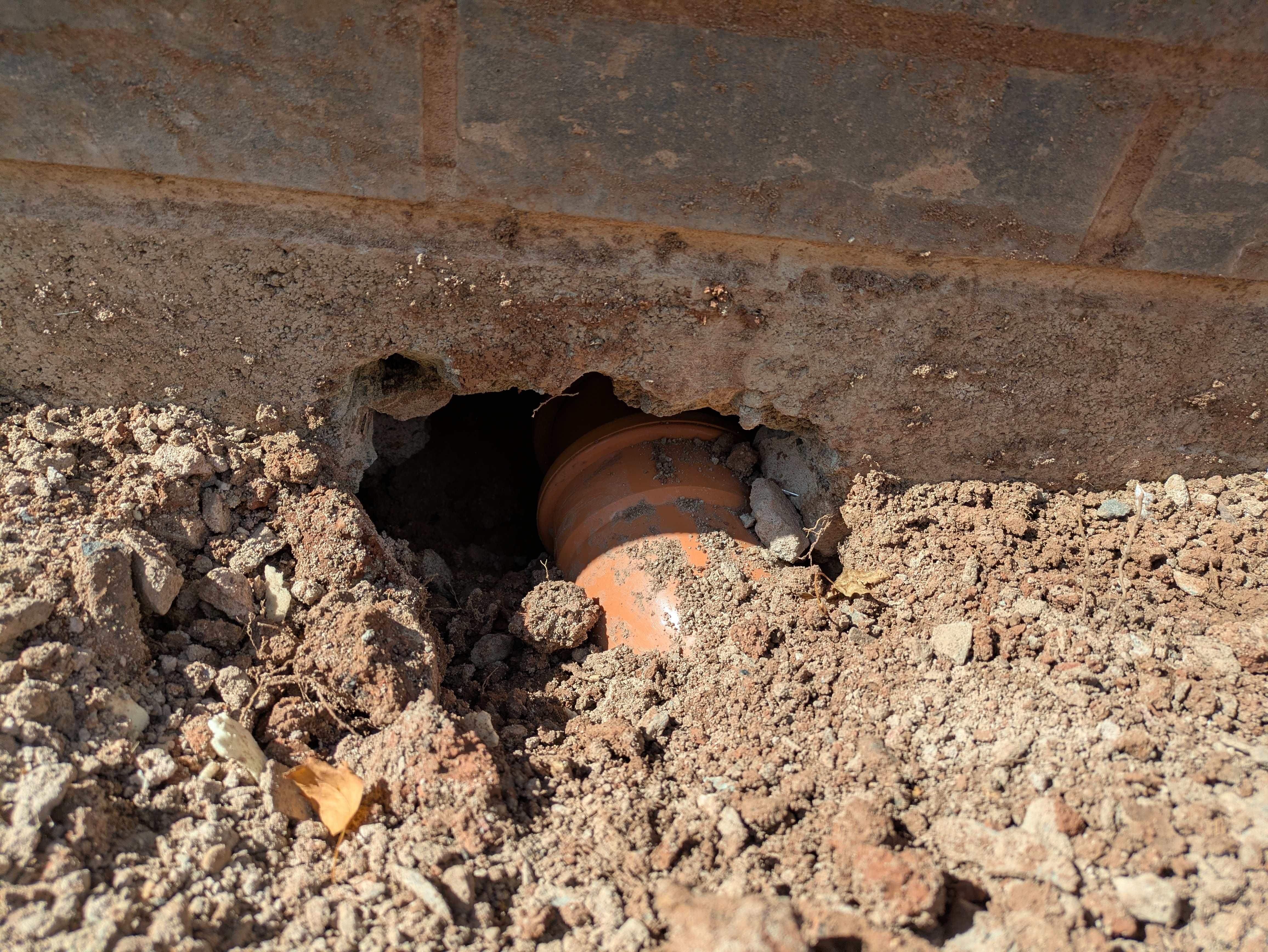

Thanks guys. I have some left over expansion tape from when we did the floor that will perfectly envelope the pipe -
Hi all My extension has been built and I'm having landscaping done. They have revealed a large hole where the underground drainpipe goes through fir the kitchen sink waste. They added this as an afterthought.. What's the best way to rectify this before we close it in with MOT type 1?

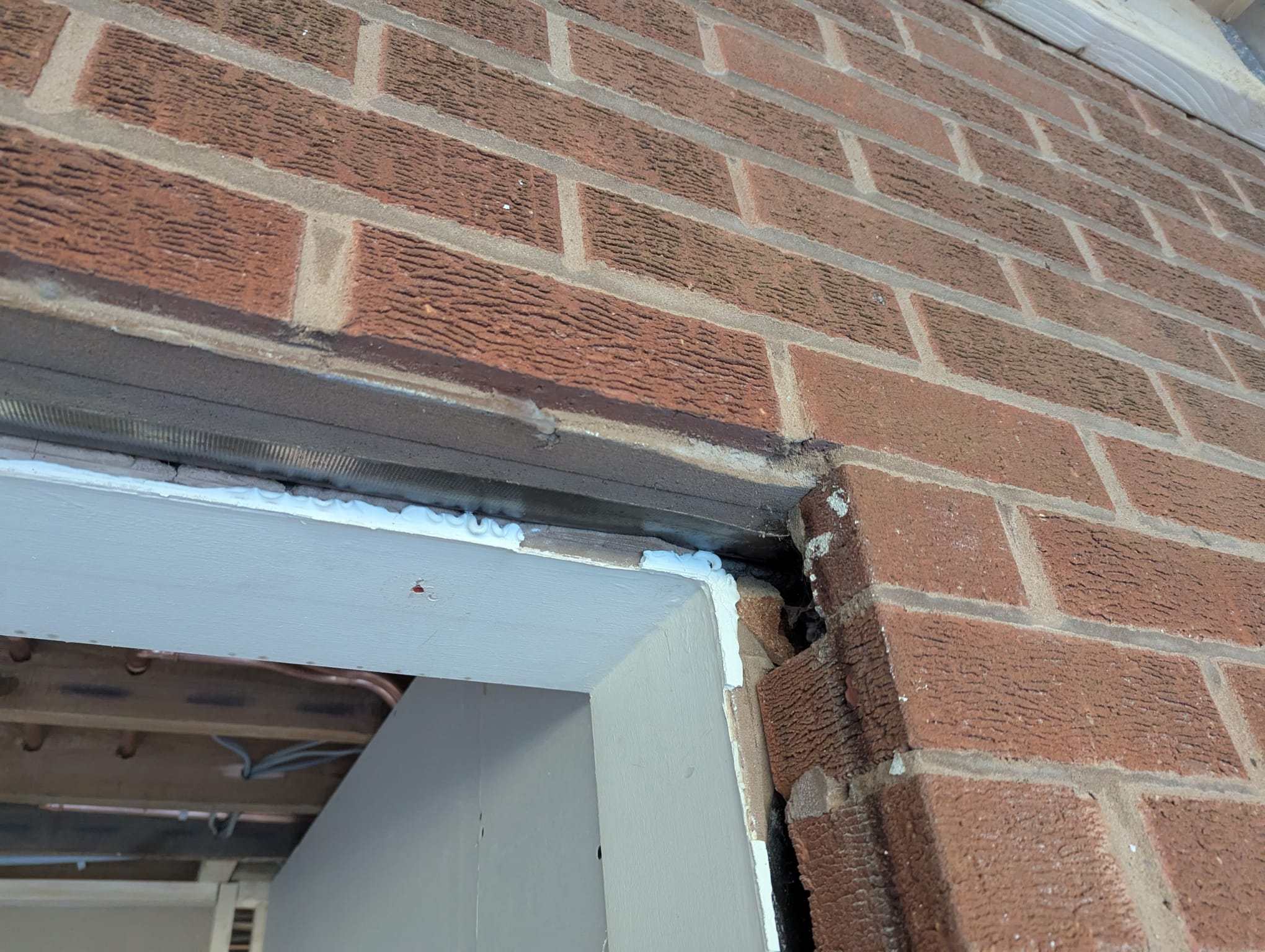

I was thinking to just drill out all the mortar, 150mm either side of the opening and place the angle in from the outside face as the cavity is 50mm, and use a dry mix packed tightly above and below the lintel. Any issues or better way for a DIYer? -

There's definitely no lintel, I knocked off a bit of mortar to check. There is a concrete lintel on the inner wall. @Canski, it's stood firm with no cracks through the full extension build somehow without failing! 2 more days with no activities should be oka. Haha famous last words I went to a builders merch and they did recommend a steel angle lintel. So I'm going to put that in on Monday -

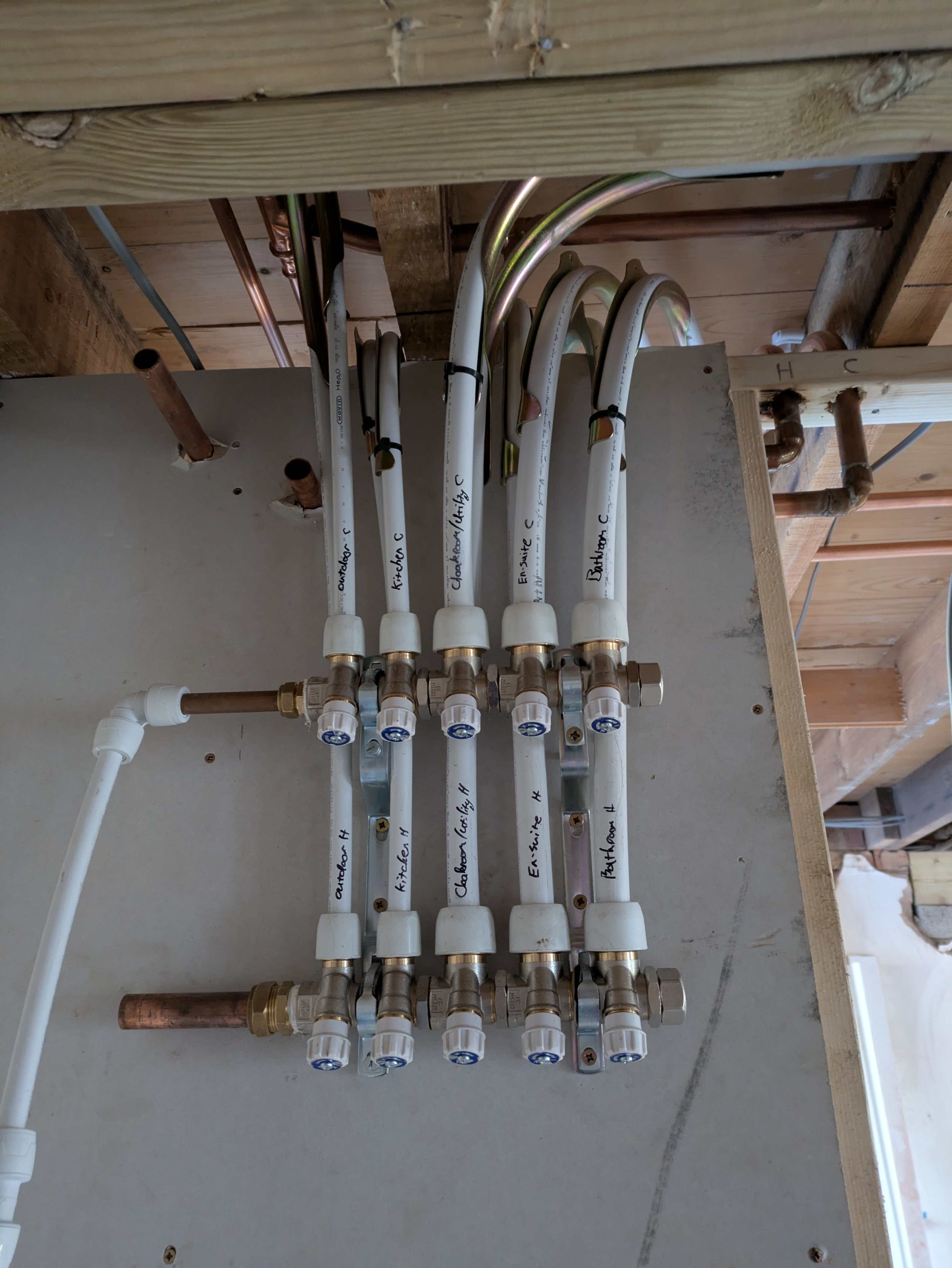

Glad my post came in useful, unfortunately I can't give any experience based insight as I've not lived with my system yet! I think you're making the right choice with the 15mm hot feed. I just didn't have the will left to argue with the plumber.
Hi folks, We had removed a window from there rear to create the entrance to the extension and there's actually no lintel in place. Oddly enough the opening has been fine for a month with excessive work taking place as we've added a flat roof above it! I wanted to make it right though, just wanted to get thoughts on what to use It's a 2.7m opening with a 50mm cavity and 100mm brickwork. I am hoping to use an angle iron on this external face, remove some mortar and just dry-bed it into the each side by 150mm - easiest DIY option Alternative would be to remove 1 corse of bricks and replace with a concrete lintel or a steel box As the plasterer is looking to crack on on Monday I'd like to get this done this weekend Any thoughts?
Glad to return some help 😅 My plumber said the bracket fit nicely on the 15mm manifold, but he had to use longer screws for the bracket holding on the 22mm manifold as it wasn't designed for that size
Thank you @Nickfromwales @torre and @JohnMo We've completed first fix and I'm super pleased with my water set up ☺️ As I have a joist in the room I can actually box off the pipework, keeping it fairly neat. I used hep2o manifolds with built in isolation, and regular branching at each room. The plumber wasn't so convinced that the manifold system will help any but did like that we could isolate the outdoor taps in winter. I used 22mm and 15mm hep 90 degree bends which the plumber found more useful than he thought they would be. The manifold bracket looks to have worked great! I see others used Munson clips but I bought the manifold mount just to try. I realise I've gone against advise here and have 22mm for the hot! Things just got done and I didn't catch on until a bit too late My components 15mm manifold (2 port, available in 2,3 &4) 22mm manifold (single port) Manifold mount 15 & 22mm 90 degree bends 3/4 iron to 22m compression 90degree manifold cap My plumber changed the end fittings over

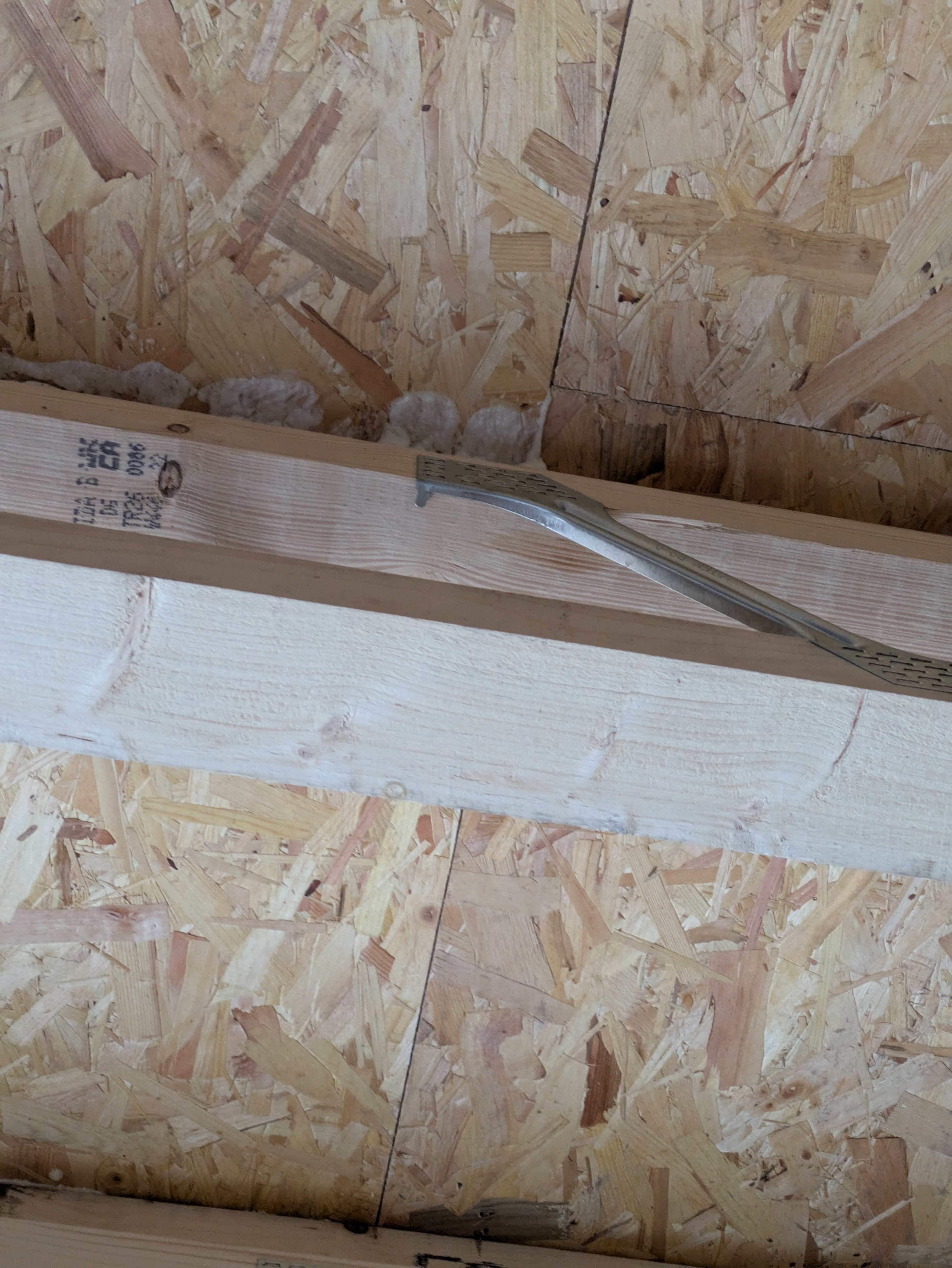

The roof is currently going on but I see leaks, thankfully for the rain!! It's part built so I'll explain where they are at with it, and I would appreciate some advice on the rectification work needed Warm flat roof; Joists on, furring on, osb on (glued and screwed), vcl (alutrix 600), 150mm celotex (glued down and foamed together), osb top layer on and screwed down. They have laid dpm to protect the roof, but I gave seen two areas with leaks coming through because they have missed the joist Will be very hard to see from a picture but I've added one. It's a constant drip.
