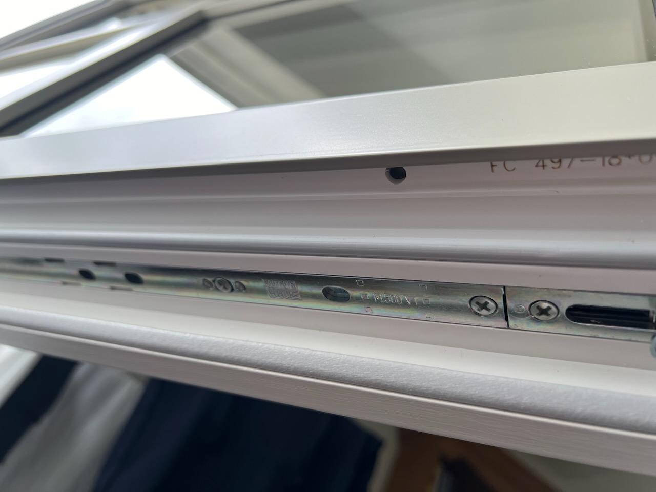

The Internorm manual recommends using an acid and resin free oil to lubricate the window mechanisms. Does anyone know if the standard 3-in-One oil spray meets this criteria? Or otherwise could anyone recommend a suitable lubricant please? I know for the locking mechanisms/doors they recommend using PTFE only spray, but not sure if this is needed for window mechanisms.

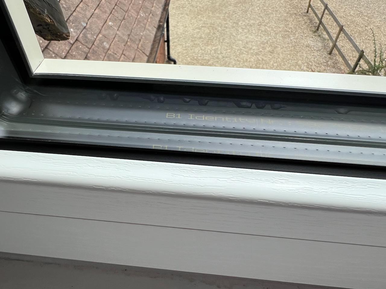

This picture might be clearer. The water doesn't appear to be within the glazing. It's between the glazing and the outer rubber seal, where there is a drainage hole underneath if you open the window, pictured.

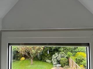

Thanks that’s really helpful. I should’ve said my blinds are Duette, not sure if the mechanism differs to Venetian. I will have a look and see if I can detach them in the same way. The water is on the standard tilt & turn KF410 not the ones with integrated blinds.
Yes ours are the same. I can access the blind but don’t see how to adjust it.

Thanks, yeah it's a nightmare. Same, windows and doors are amazing, but the fit is not the best. Unfortunately it's not so bad that I can really do much about it either. I totally regret not going with the platinum installer. Going with a firm who fit double glazing 95% of the time was definitely a rookie error 🫣 Thanks for checking. They seem to be closing ok with the packers. They are glued on quite strongly but I can peel off if needed. I did ask the installers to adjust the blind before they left but they said they couldn't so just wanted to check if it can actually be done.

Hi all, I’ve had Internorm windows fitted recently and have a few questions about them: 1) On the KV350 with integrated blinds, there are what look like black plastic corner protectors on all four corners of the outer window pane, glued on. On one of the windows one is missing and another has come loose. What are these and is not having them a problem? 2) One integrated blind is quite wonky. Is it possible to adjust this? If so how? 3) One KF410 window has water inside the bottom outer seal constantly. I notice there are drainage holes below this channel that does let water out. Is it normal for water to collect here? Pics attached. Thanks
