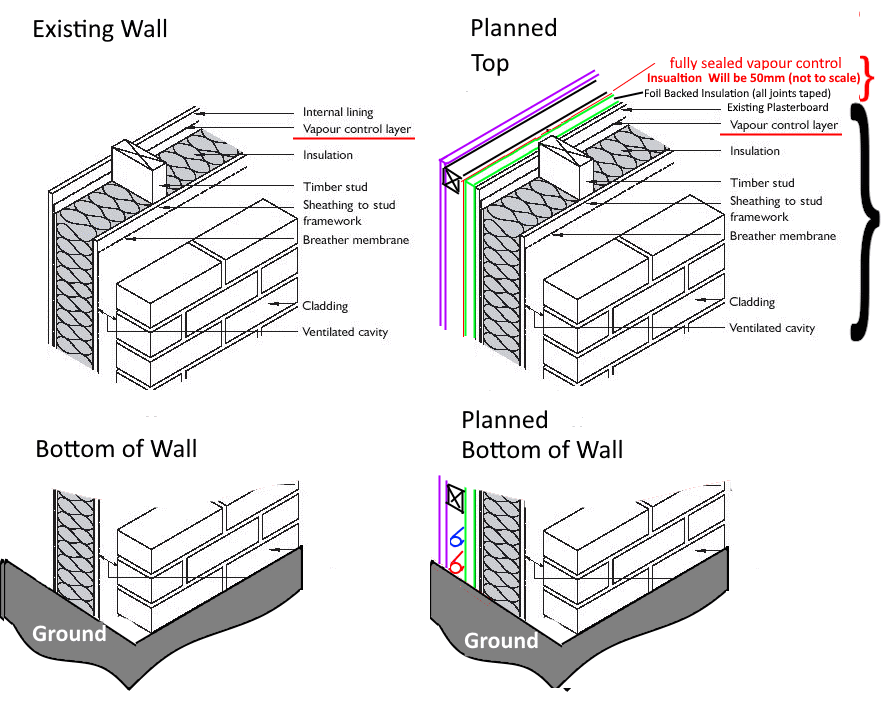

I am not a plumber so feel free to tell me if I am incorrect in anytingng I describe or ask. My son is adding additional internal 50mm foil backed insulation to all internal walls of his 1890's timberframe hosue + a vapour barrier. Insulation supplier has calcculated minimal consensation risk to existing vapour barrier. He will also be completely replacing the whole the heating system - either Oil Boiler or Air Source Heat Pump (grant ddependent) + new radiators. He plans to add HEP2O below the bottom horizontal battern before adding plasterboard and plaster. - see attached image I would appreciate a comments on what insulation, if any should be applied to the HEP2O pipes. He is already losing some room space and keen to make battens as thin as possible. Would minimal insulation wrap around the pipes plus insulation above the pipes (below the batten) be sufficient?

@SteamyTea Thanks for our input - My son has decided to keep the existing insulation and plasterboard and follow the procedure discussed in the early part of this thread @SteamyTea @ProDave @Redbeard I would appreciate your comments on this (hopefuly) final image and answer a question about Vapour Barrier The attached image shows two possible locations for pipework. My son plans to go with the second version where pipes go along the bottom of the wall along 3 bedrooms. I have noted the importance of taping the joints of the insulation to make a good vapout barrier. Buiding Control mentioned the possibility of a plastic vapour barrier (not sure if he will want to enforce this if he is happy with the taping). What are your thoughts on taping + plastic sheet vapour barrier? Any negatives of adding the plastic vapour barrier? Someone locally mentioned the possibility of condensation forming on the plastic vapour barrier, however as it will be on the inside of 50mm insulation I assume both sides of it will be close to room temperature - hence no condensation issue (if fitted) - Comments? Any other comments would be appreciated.

My son owns a 1980's Timber Frame bungalow . Structure is same as attached image. He is currently converting the attached garage to 2 bedrooms. The garage is already insulated, with fiberglass between the studs - same as the house. The house is unoccupied and with no furniture and he has easy access to all the walls in the house. The Northern Ireland Building Control inspector has mentioned that the insulation is probably not up to modern specification and would need to be upgraded. I believe he was correct that by adding additional internal insulation (on top of the internal plasterboard) could cause condensation to form on the plastic vapour barrier, behind the plasterboard, due to the lower temperature on the outside surface of the vapour barrier. The most effective solution is probably to add external insulation, however that will likely be more expensive and could end up with the garage part the house having a different finish to the rest of the house (not the end of the world). Is removing all internal plasterboard and the vapour then adding new insulated plasterboard a possible solution? However that means no vapour barrier - what effects would that have? Is there a better solution? The issue is further complicated by a comment from the Building Control officer that suggested there might be a requirement to upgrade the insulation for the whole building, however that would be a lot more work and cost. I am not fully clear on the reasoning for needing to upgrade the insulation of the whole house (I think it was due to him also requiring building control to upgrade the heating system). I need to call the inspector for clarification, but I want to be more clear on what is a suitable insulation solution for the garage or the whole house before I ask more questions. Any guidance on the most efficient / cost effective way to upgrade the garage or whole house insulation would be appreciated.
