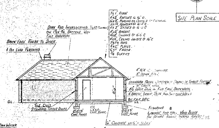

  4. Hey all! TLDR: Heya! We got an old house, lots of work and decisions to me made and done!😮‍💨 As the title suggests i would like to think of myself a DIYer but not a so experienced one but you'd only learn by doing! It's frustrated me to no end that I'm not as practical as i'd like to be, anything to do with computers, programming, 3D etc is a different story. Hope you guys could help lend some of your experience. My girlfriend and I have just purchased a 1959 semi-detached bungalow which doesn't look like it's ever been updated, or if it has been... it's not been updated well with so many corners cut it's more like a circle. I've had 3 plumbers come to look at our system, 2 couldn't be sure if the heating is a 1 pipe or 2 pipe system, and the 3rd thankfully so confident it's a 2 way, he'll put money on it. As I type this the windows are finally being replaced and have already started to feel warmer! but still a bit colder inside than it is outside. With having moved in not too long ago and things still packed away. I'm hoping to take advantage of that and try where I can to do things right and get the place rewired from the get-go! Heating will be next. The house is a bit of an odd shape at the back and everyone we've spoken too has suggested to square the back off where the conservatory is which has led us to look to reconfigure the layout of the inside overtime, but bearing in mind this is a multi year project having been quoted 60k for a 25m2 ish single story extension to replace the conservatory and build to the side a bit. As we look to reconfigure over time, the main dilemma fighting in my head at the moment going back and forth is how to do UFH! All the radiators don't look like they've been updated since with no TRVs and just big blocks of iron. We know which rooms won't and will change and by how much thanks to the magicplan app, We've also got the original planning permission for the house when it was built. We supposedly have 6" (152.4mm) of uninsulated concrete floor under our delightful carpet and lino floor (no asbestos). I've spoken to companies like Wunda, Continal, Nu-Heat etc about retrofitting on top of our slab knowing we'd lose head height. But they seem confident their 15-20mm channeled polystyrene boards with the pipes embedded into them would be enough insulation to keep heat loss going into the slab to a minimum and I think they said max 8% downward loss. Supposedly the bottom thickness between the bottom of the pipe and board is the same for the 15mm or 20mm boards, they just reduce the height at the top and use smaller pipes. The other side of the battle is thinking do I just break the concrete room by room and redo the floor but i'd look to do this DIY! The main reason I'm contemplating UFH knowing having the whole house done is known to be really pricey, is because we know some walls are going to be removed when we eventually extend and reconfigure. We intend to keep the current radiators in the rooms that will change, such as bedroom 3, Kitchen, bathroom, and dining room and put UFH in the lounge, hallway and bedroom 2. In the future, we will extend the UFH to the other rooms and have had these UFH companies look at the current layout and our future intended layout to make sure the system could flow into the other rooms after the extension. This turned out to be a longer post than I thought but good to get it all written in one place! Any suggestions, or insights are GREATLY appreciated!
