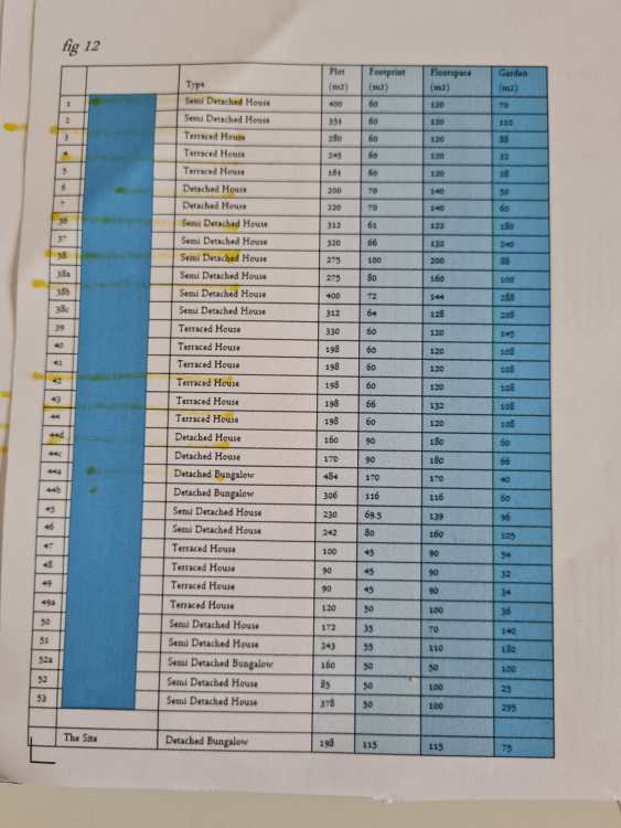

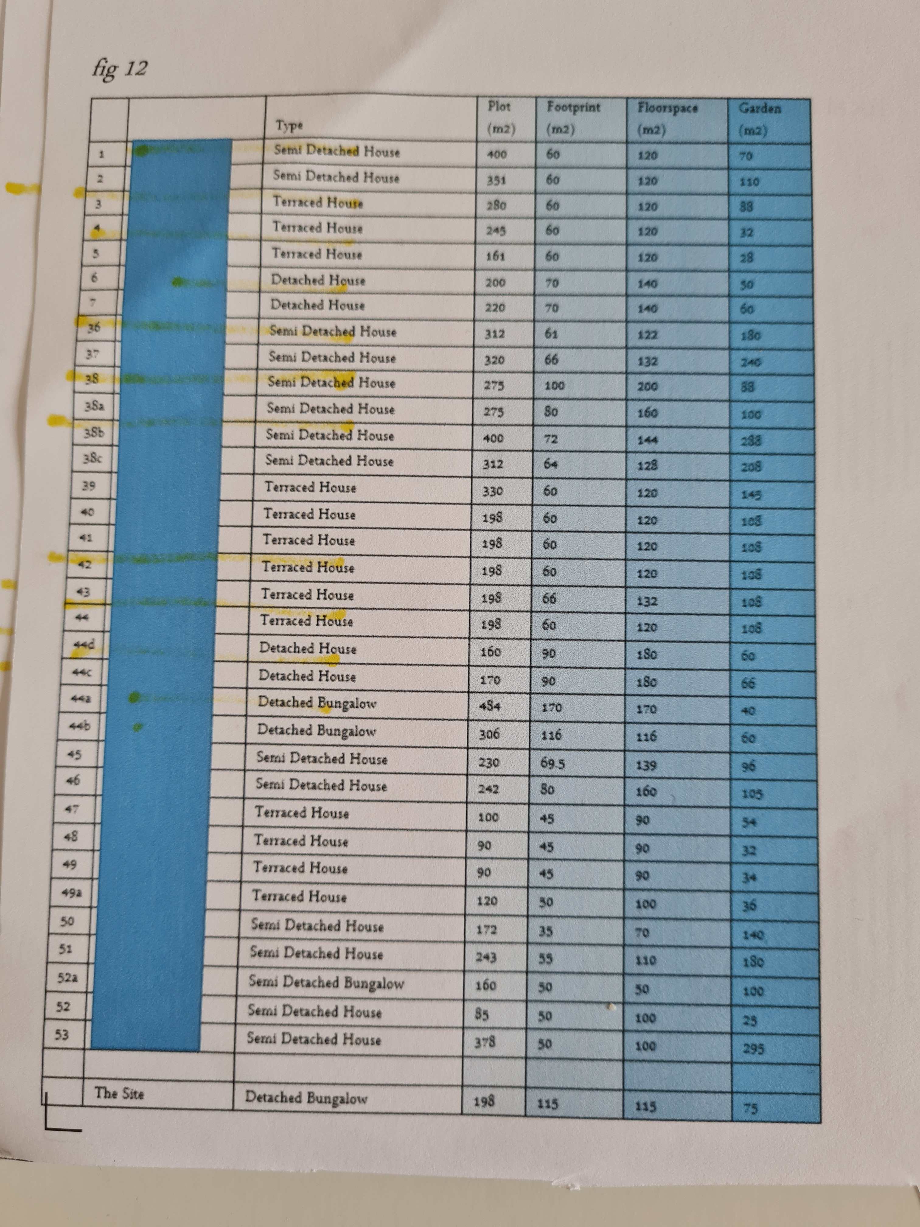

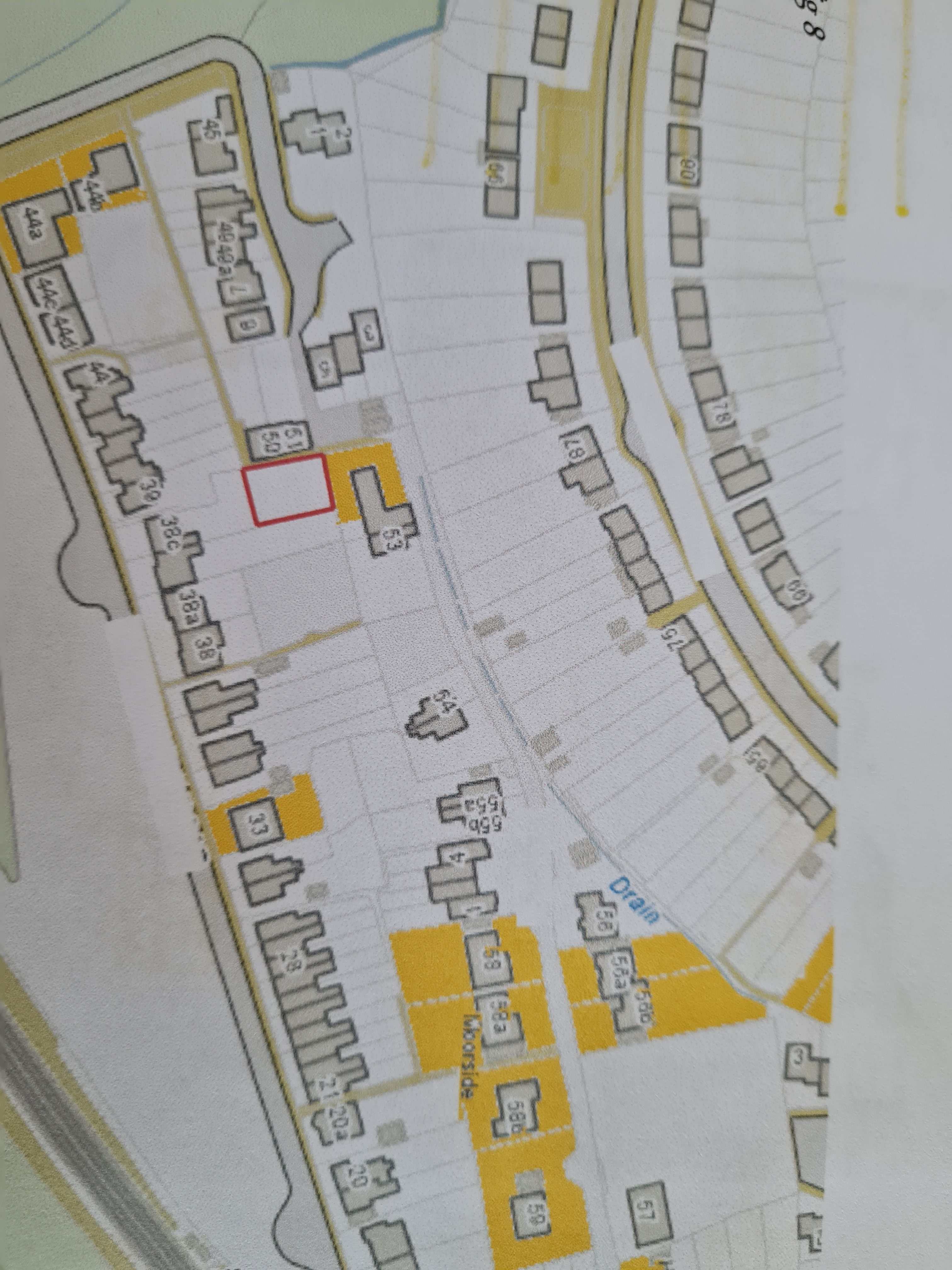

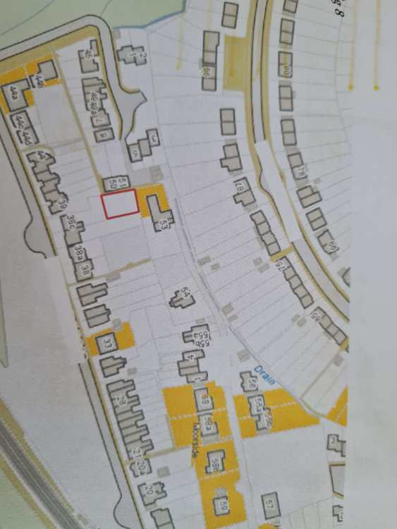

In 2022 a planner posted a design and access statement he wrote for his own plot. It was a fantastic resource for the build hub community and I would like to use the approach he suggests for getting together some evidence for my own plot after a pretty damning pre-app. The upside is that I'm aware of the many issues the planner had at the time of her report, so I can try to address them, with evidence. There was alot of data presented in photos, diagrams and tables and I wondered if anyone knows how this information can be obtained or researched by a lay person. There were street/neighbourhood plans like the one below which enabled drawing over, and information presented in tables; that information relevant to my plot would be very useful. Does anyone know where I can find plot size, footprint, floorspace, garden size, even better if they are all in one place? Thanks
@Tony K Thank you for a great framework and contents from your D&AS. I am a bit of a rookie and wondered if the map you used for Fig 11 & fig 16, plus the information you presented in Fig 12 & Fig 13, was open access/ easily available to research and use?
