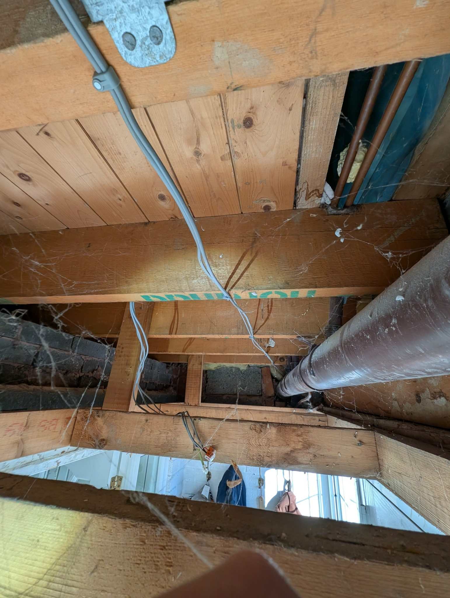

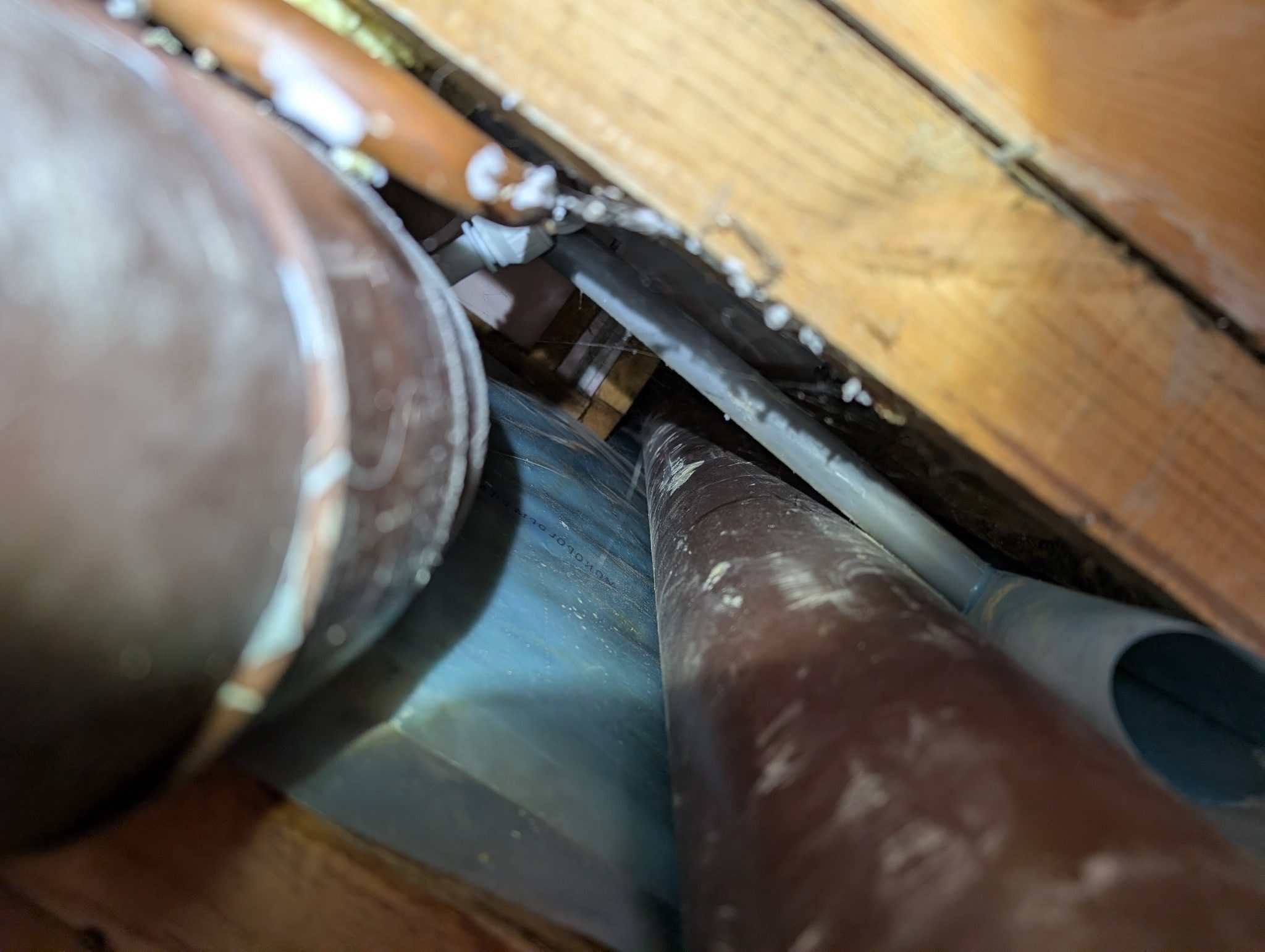

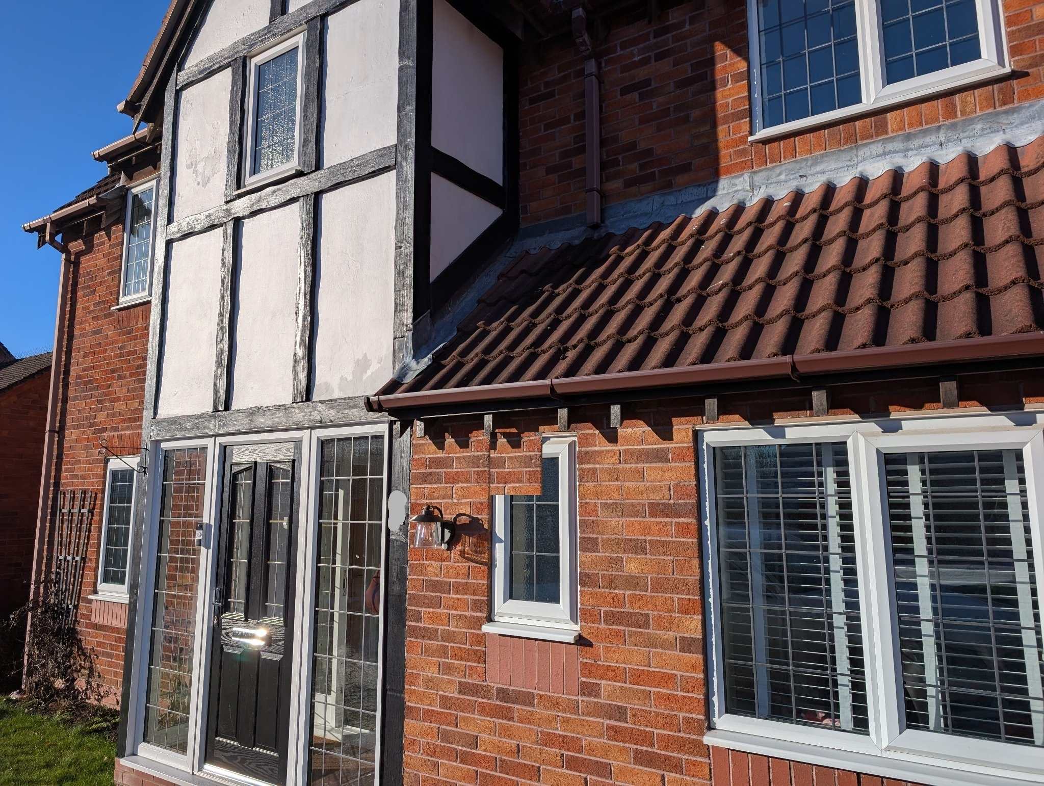

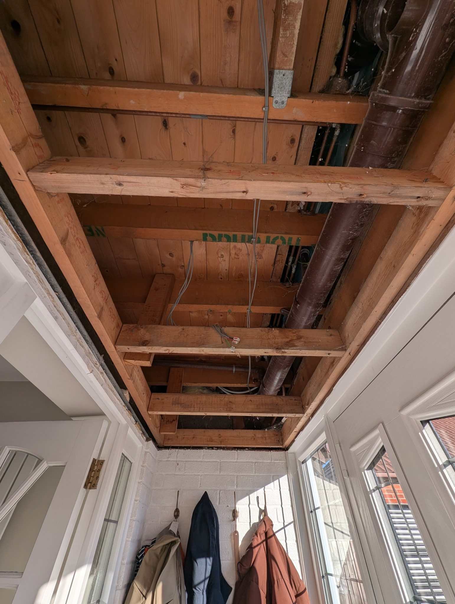

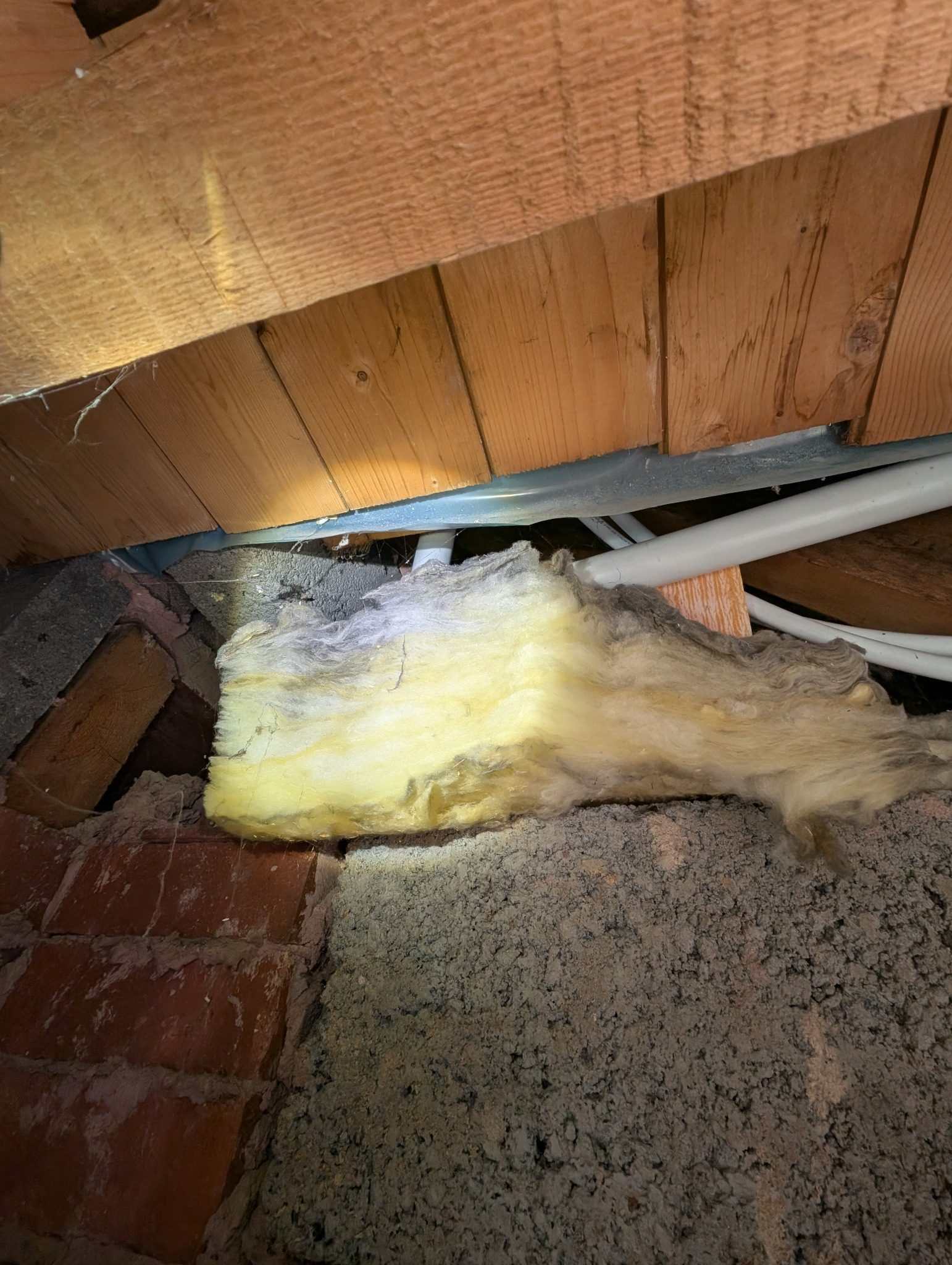

Hi all, I’m after some advice on the best way to insulate a porch at the front of my house. The porch is single storey, with an ensuite bathroom directly above it. I’ve taken the porch ceiling down, which has revealed that a few voids are currently all connected, which doesn’t feel ideal from a thermal or condensation point of view. At the moment: The void above the porch is connected to a cold, ventilated roof void at the front of the house That space is also connected to the sub-floor void under the first floor The soil stack from the ensuite passes through this area and continues up into the main loft, which is also cold and ventilated There’s little to no insulation under the ensuite floor, and services run through the void So there’s a clear path for warm air from the house to reach cold spaces, and I’m concerned this is effectively breaching the thermal envelope and increasing condensation risk around services. I can see two main ways of tackling it: Option 1: Close off the cold roof void where it connects to the porch (it’s actually a fairly small triangular section) and bring the porch and void above it into the thermal envelope. Also worth insulating under ensuite floor? Option 2: Leave the porch cold and insulate at the interface with the house, including insulating under the ensuite floor and carefully sealing around the soil stack and other services. My current thinking is that Option 1 may actually be less work overall, as the warm–cold connection is small and well defined, whereas Option 2 would involve a lot of careful airtight detailing around services. That said, I’m very conscious of condensation risk, particularly with the soil stack passing through into a cold loft, so I don’t want to create new problems. Any advice would be greatly appreciated. This house is the gift that keeps on giving 🙃 Front of house showing porch and ground floor pitched roof with cold roof void Junction between pitched roof and porch roof void (basically open to it) View into house showing 1st floor joists - all open to cold void Soil stack going from ensuite toilet up into loft - another thermal chimney! View of porch void 1 View of porch void 2

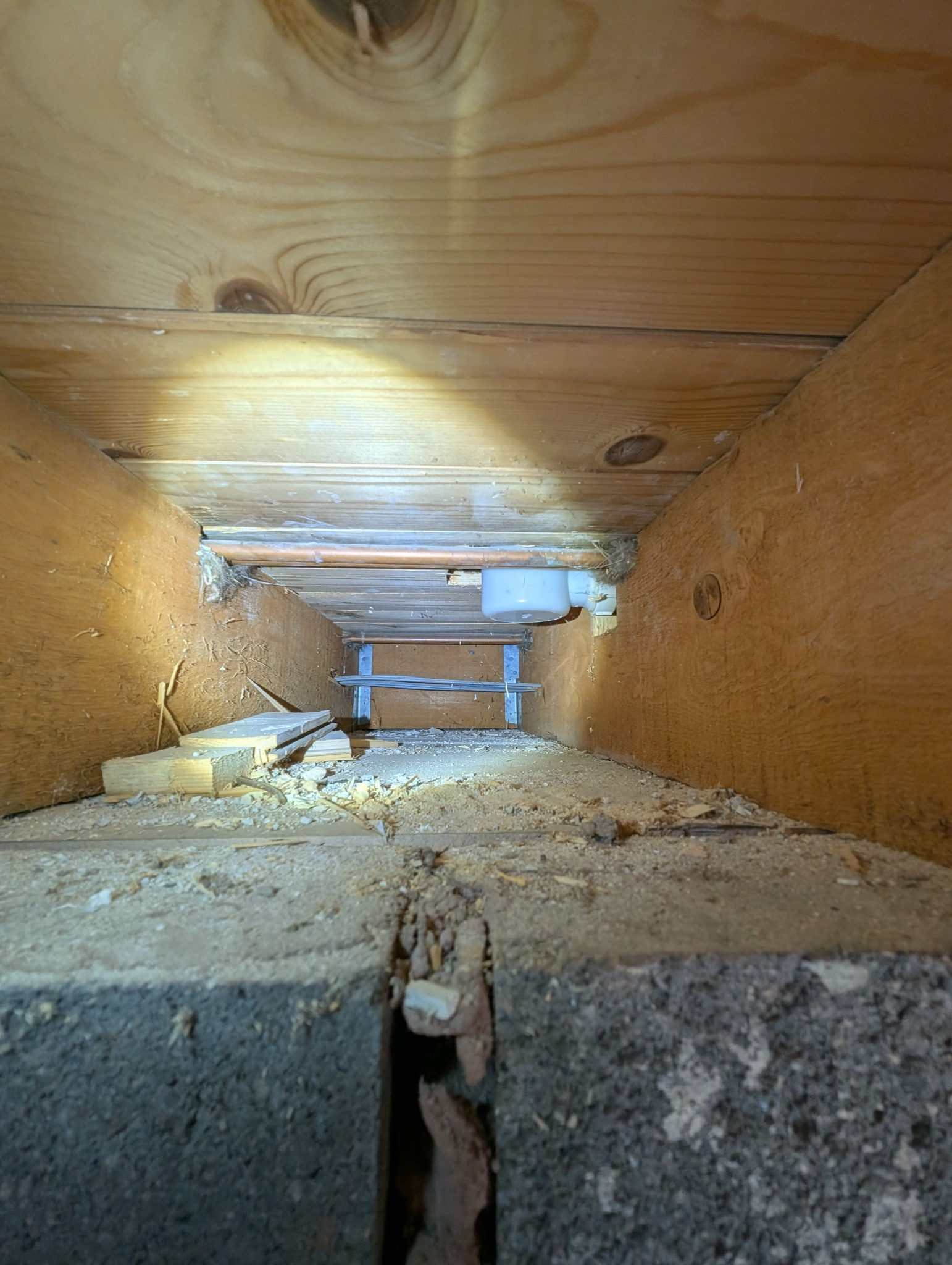

Thanks sparrowhawk. Definitely satisfying fixing a few of the smaller leaks so far! I got a reply from building control inspector along with a photo - it's a warm roof with 150mm PIR above the deck. Interesting you say the leaks may be coming where the joists rest on the walls. I'm prepared to expose these to try and fill them but I suspect there is a bigger draft coming from somewhere to be honest. And on that, my sons bedroom in the corner of the 1st floor is freezing, and there's a draft. We've taken the skirting up and exposed the corner and it looks like a complete dogs dinner (see photos). The cavity is compromised, there's a draft coming in here and you can see down to the steel that was put in as part of the extension. I am wondering if the draft is actually coming from a cold roof, which is adjacent to the extension. Any thoughts/suggestions? I have gone back to building control to see if they can provide details of the tie ins between extension and the property and asked if they would come out and have a look (slim chance but who knows).

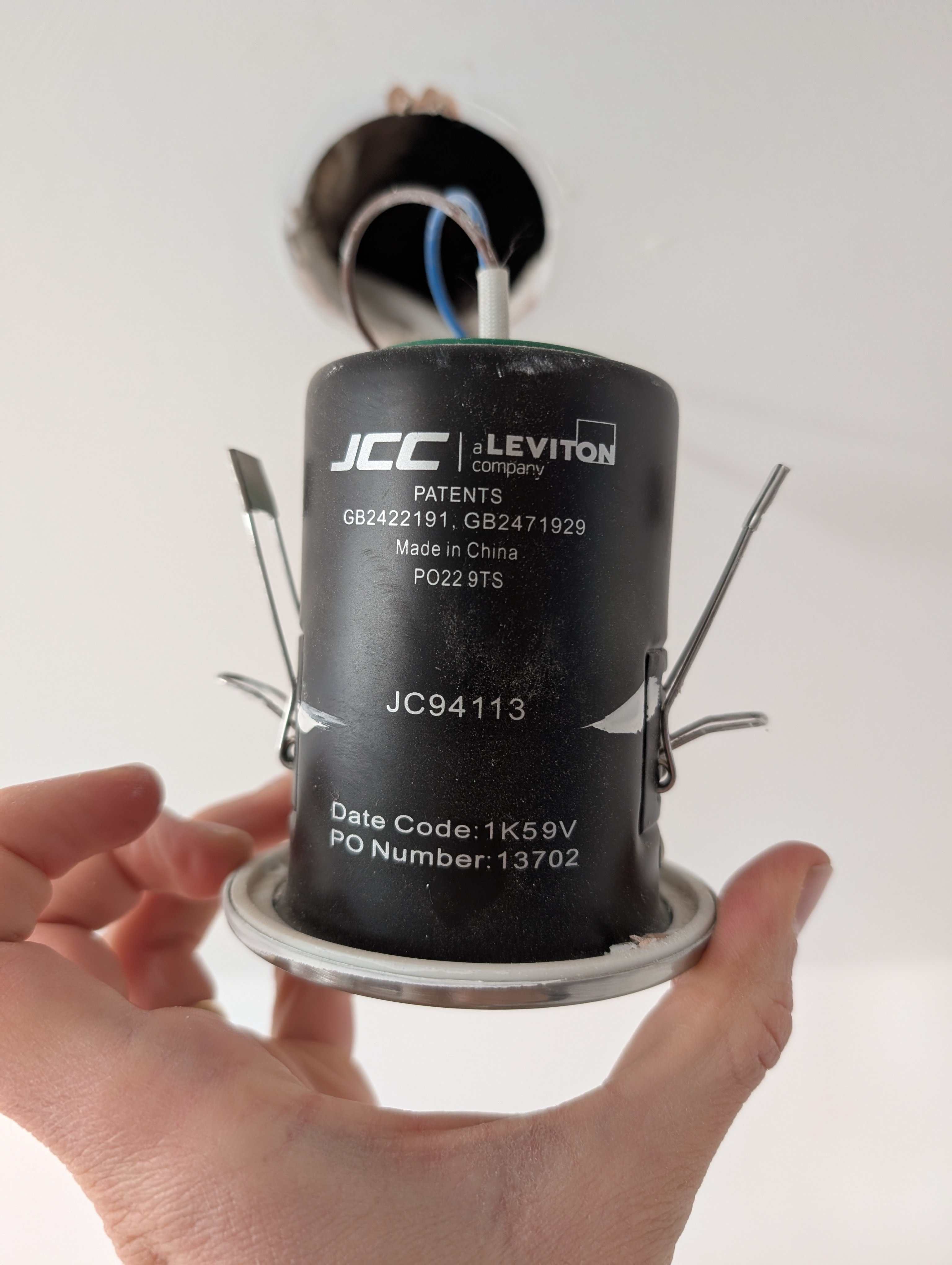

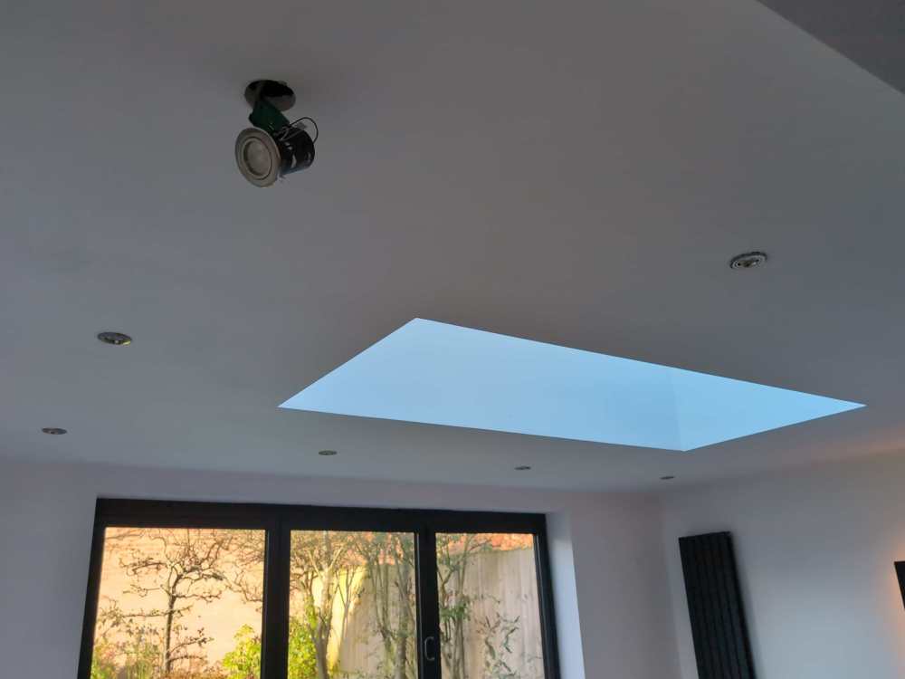

Thanks for the replies. I just pulled a few other downlights and seems the draft is especially bad on one row of lights between a pair of joists. Putting my phone up with camera on I can't seem to find any obvious leak points. Honestly no idea what to do! Ive ordered an IR thermometer today and am thinking of doing some tests to try and verify how bad the current situation actually is. Will take a few data points on an cold day (this weekend): Room temp Ceiling centre temp Ceiling near downlight Ceiling near lantern Void temp Outside temp Worthwhile do you think?
Thanks for that Mr Punter, I will take some measurements over the weekend. Plasterer just been round to quote. £450 labour for 2 days. I've priced 50mm PIR backed plasterboard + extra long drywall screws ~ £360. It's a fair bit but we spend a lot of time in here. Also proposing to move away from downlights and go for 2 surface mounted lights instead, which i guess will help keep a warmer envelope.

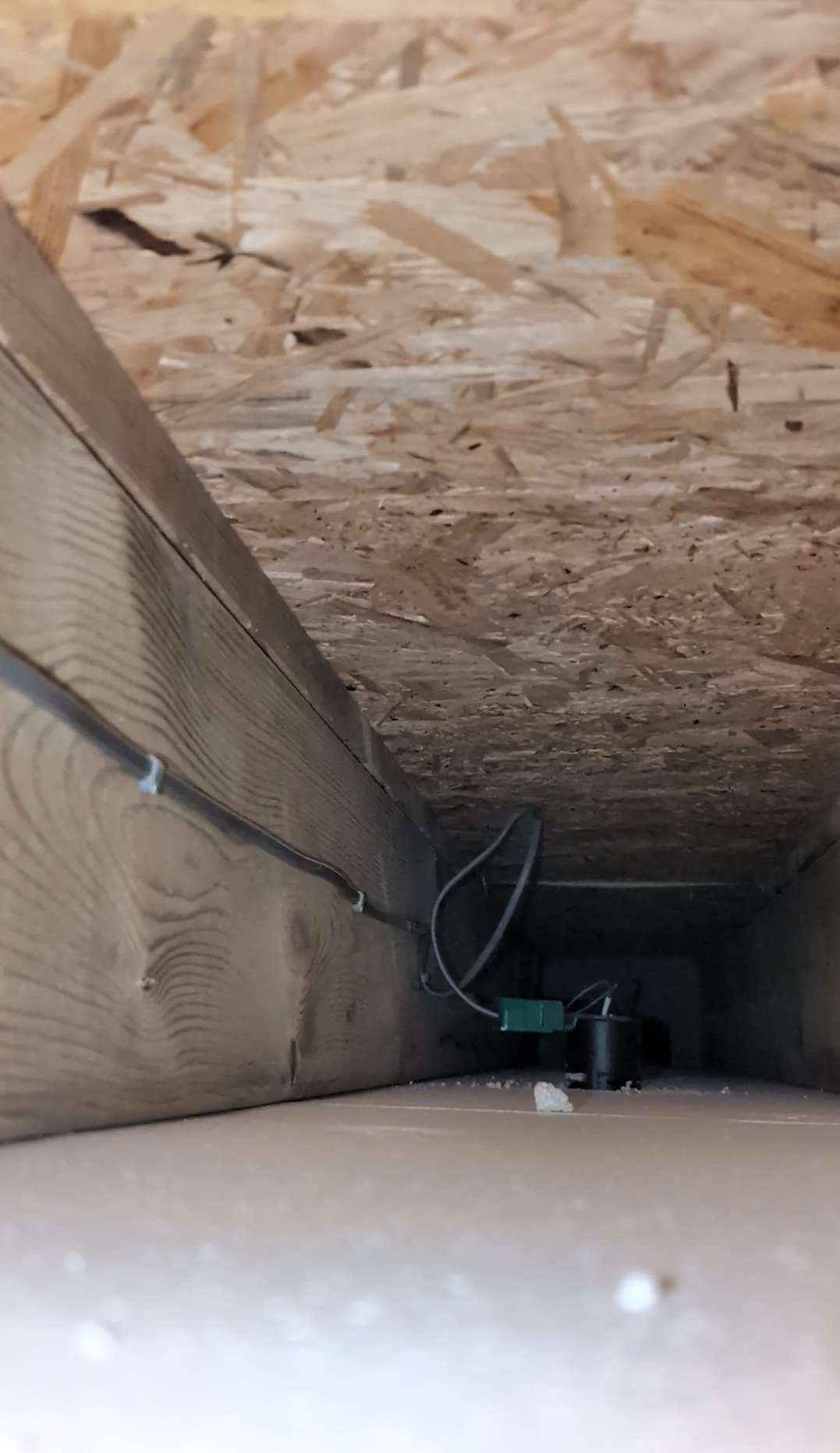

Hi, we moved into our house earlier this year which has a single storey flat roof extension on it. The hope was it would be lovely and warm, unfortunately we're finding it's not. I took a downlight out yesterday to have a look into the ceiling void. From what I can see this appears to be a warm roof. The ceiling is polystyrene backed plasterboard, there's then a void of around 200mm with a wooden deck. I am guessing (hoping) there is insulation laid above this underneath the roof itself. The tiny amount of polystyrene insulation on the back of the plasterboard would not meet modern insulation standards and building control would not have signed it off (I am guessing). This void appears to be pretty drafty and cool, so guessing there's some leaks somewhere. It's very difficult to find out exactly though as there's no access of course. One thing I am considering is overboarding the existing ceiling and lantern vertical sections with 50mm backed PIR insulation and then making it as airtight as possible to minimise moist air reaching the cavity. We have plenty of ceiling height to do this. Any thoughts on this approach?
