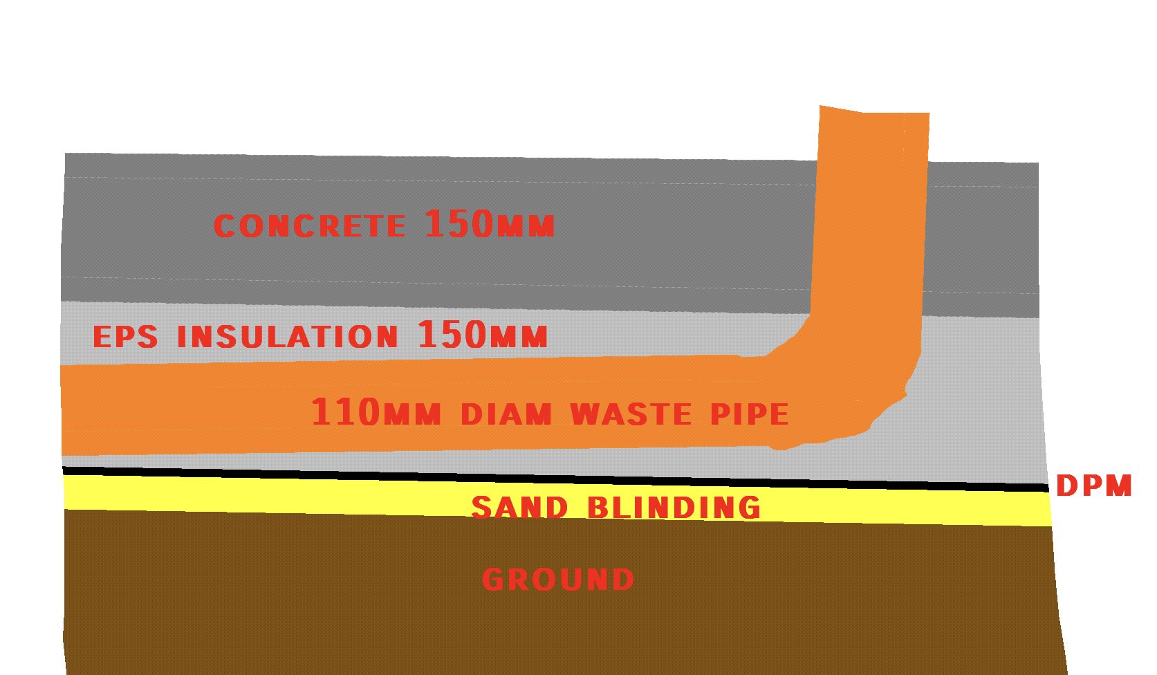

Foul waste through insulation layer
JohnMartin68 replied to JohnMartin68's topic in Waste & Sewerage
Retrofit, there wasn't room for any more without digging below the top of the footing. Single room, small area that needed to be dug up anyway. 150mm vs 300mm won't make a huge difference to total annual running costs even assuming UFH is left on 24/7. The compressive grade is either 100 or 150. It's the premium version which is darker and supposed to have a slightly better U value than standard. -
Out of interest what is the reason for insisting on gravel instead of using for example foam? Is it just for compliance with what BC expect to see? For obvious reasons foam wouldn't work in an unlined earth trench but the insulation shouldn't move significantly when its in place. -
Not without lowering an unknown but at least 10m length of existing pipe. -
Thanks you're probably correct the gravel will provide a bit of insulation. I just wasn't sure if the reasons for using pea gravel to support the pipe were still valid in a channel carved out of EPS instead of a trench dug in the earth. For one thing there must be precaution taken that the gravel won't 'leak' from gaps in the insulation but then if the insulation is laid properly without any voids this shouldn't happen. -
What is the best way to support and protect a 110mm foul waste pipe if it needs to run horizontally through floor insulation? See attached sketch. The elevations cannot be changed for various reasons. I was thinking of cutting a rough channel through the insulation and filling it expanding foam with the pipe in place, instead of pea gravel. Or should it just be pea gravel (this will probably cause heat leakage)?
