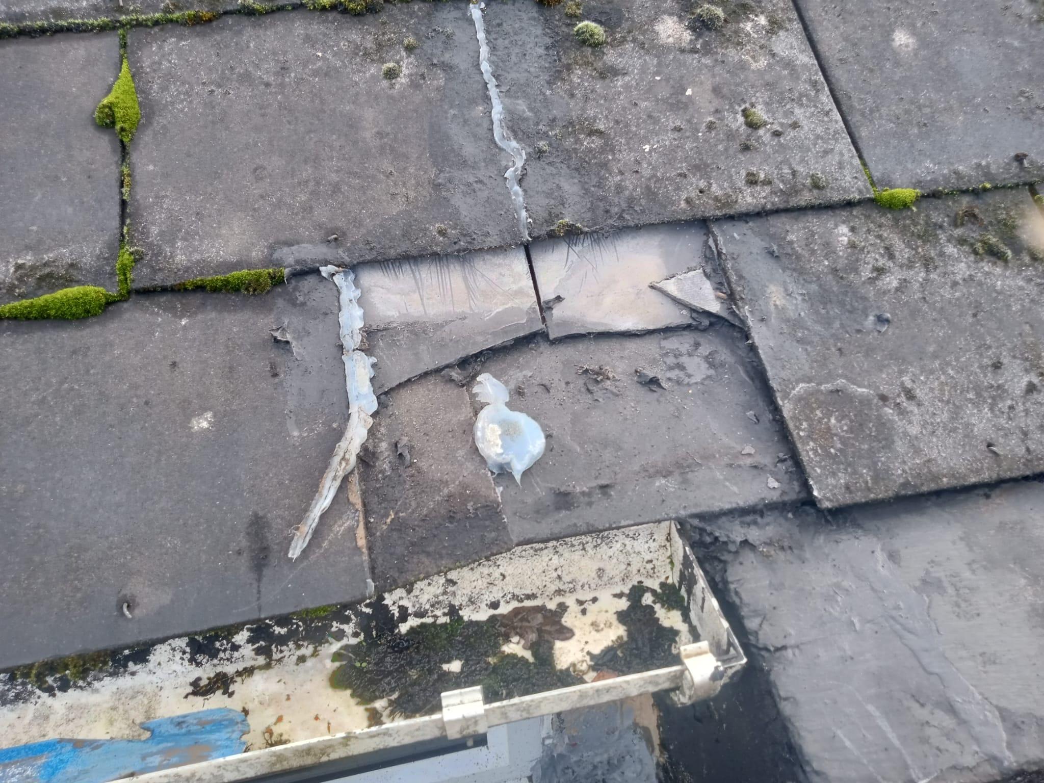

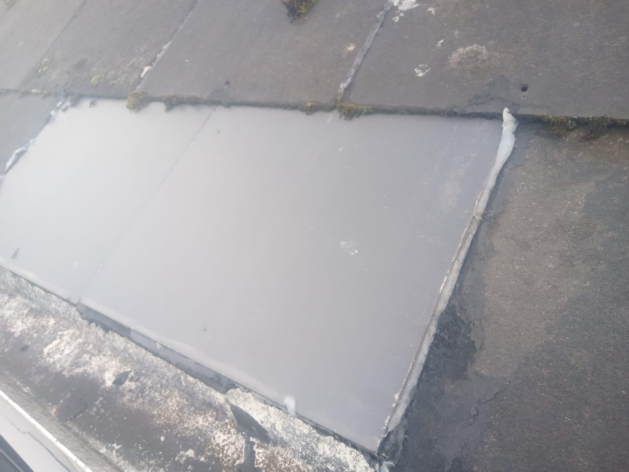

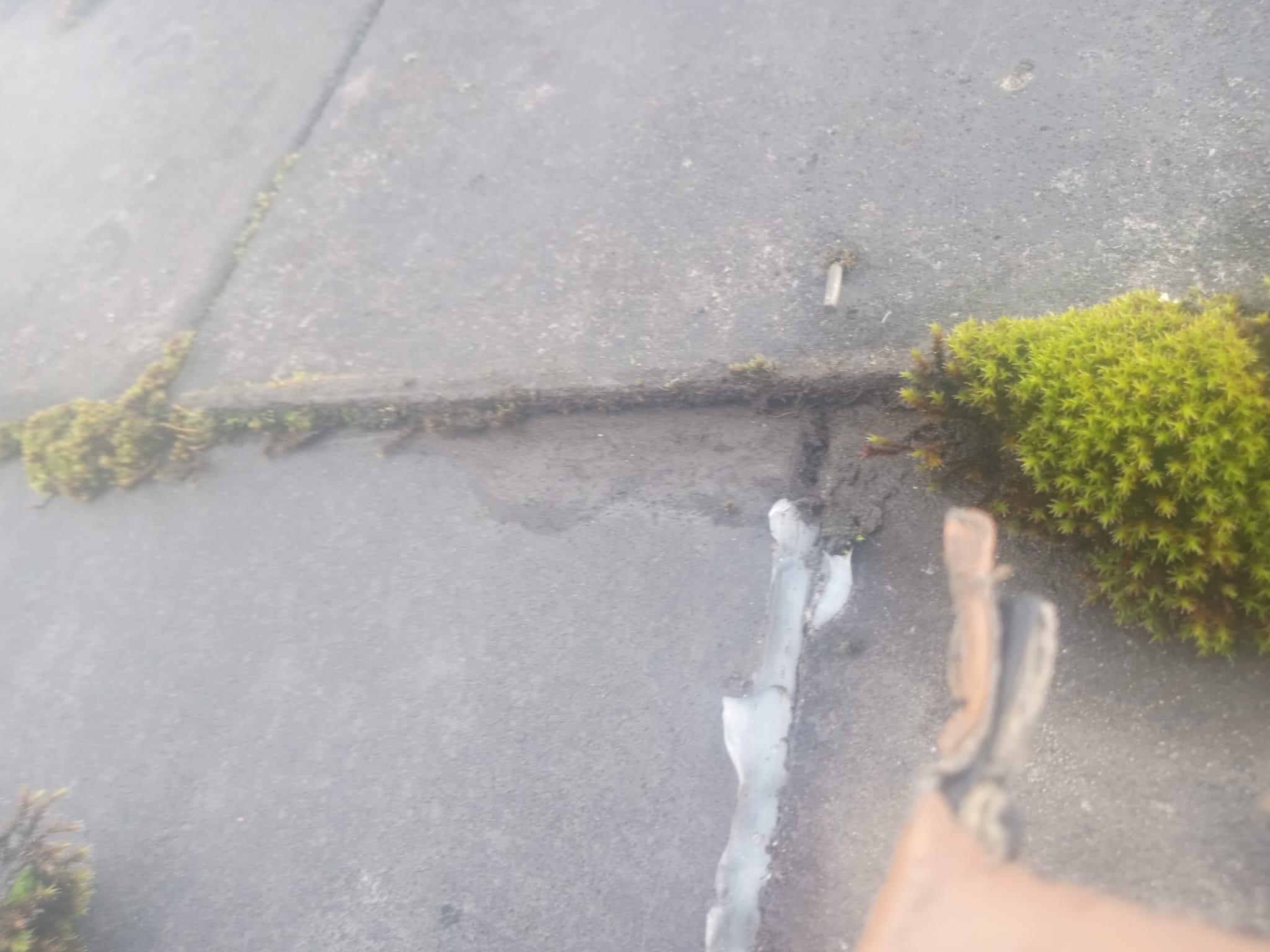

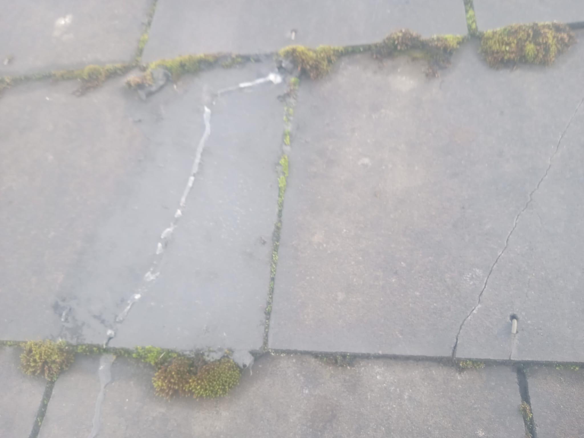

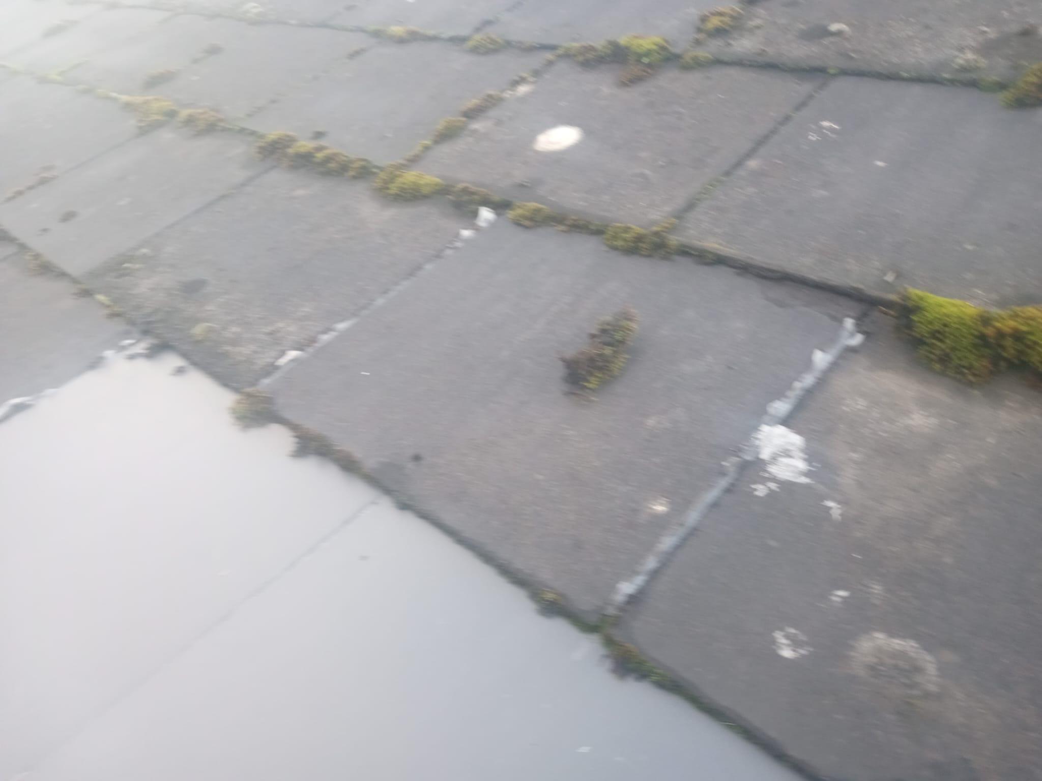

  1. Apologies if this post is not allowed - had a roofer do some work 6 months ago, didn't fix the issues. Hired another roofer to sort the issue and he pointed out the previous roofers bad work. Now in the process of trying to get a refund, he is deflecting after offering me 1/3rd of the price a paid. I’m looking to get some opinions from real roofers about this quality of work. He put fresh tiles over cracked ones he smashed and siliconed other cracked ones. To note he charged me 650 pound. The roofer who fixed his work only charged me 80. He has said that anyone can pick faults.
