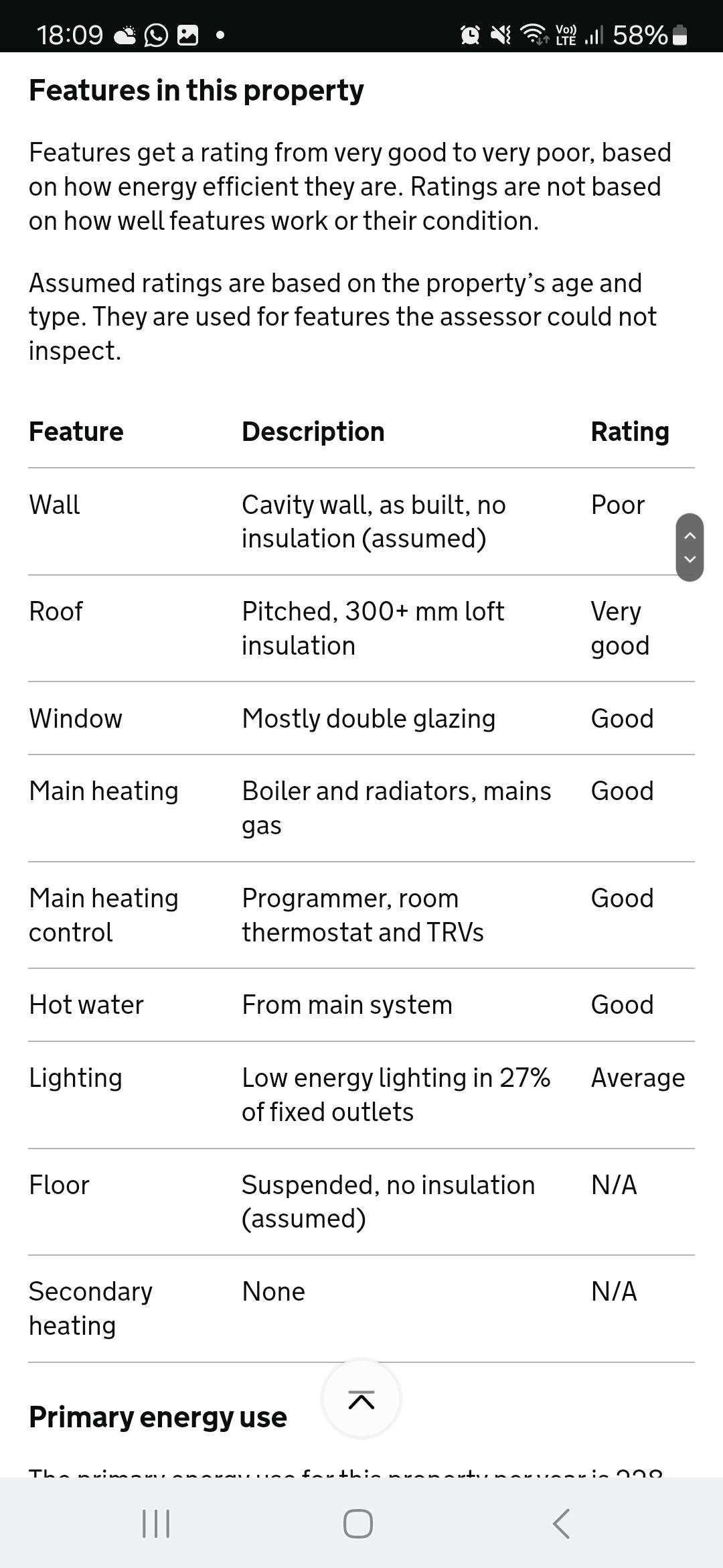

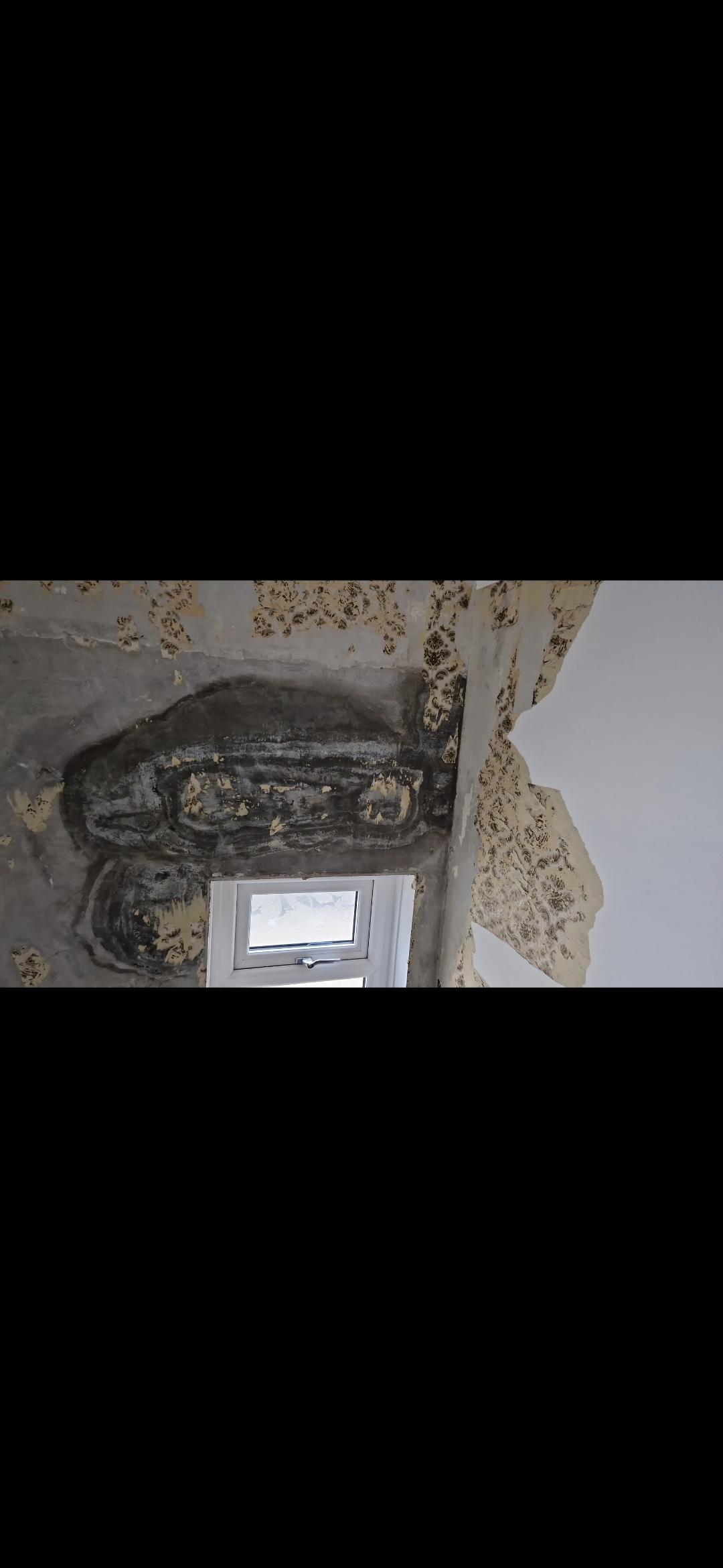

  2. I'm definitely not tempted @Icevergeas it sounds like an expensive work around to me. I've managed to take a video with the phone outside of the window but it won't let me share it here as the file is too big. I can get in the attic at the weekend. I have had someone look at the chimney before on the inside and they never saw any issues. Before we took the paper off we had what we thought was a leaking running down but it was just condensation of some kind, maybe from this underlying issue ( I'll add pictures below) Wall on other side looks fine but there is paper there however feels fine to touch. EPC info online suggests cavity wall

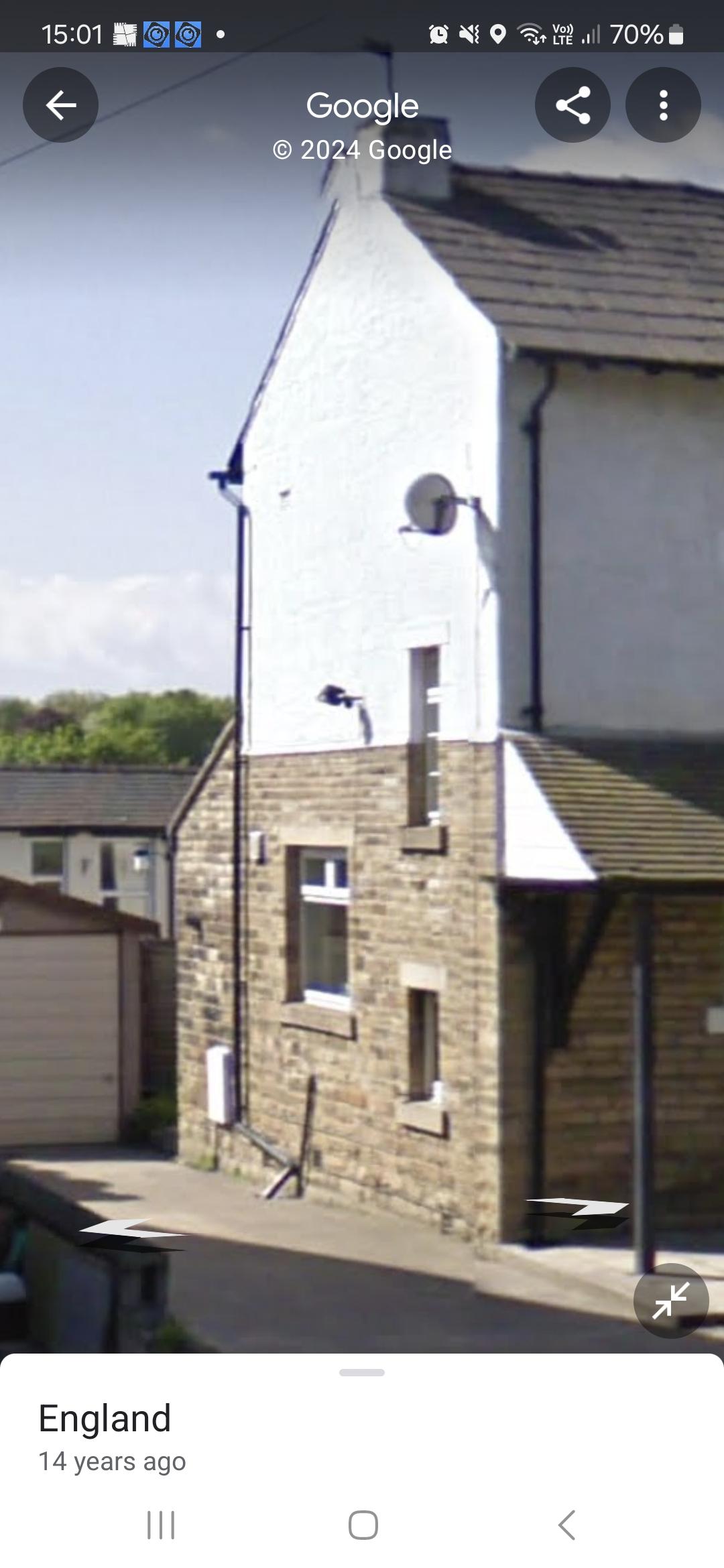

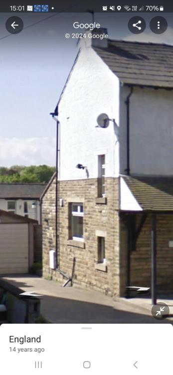

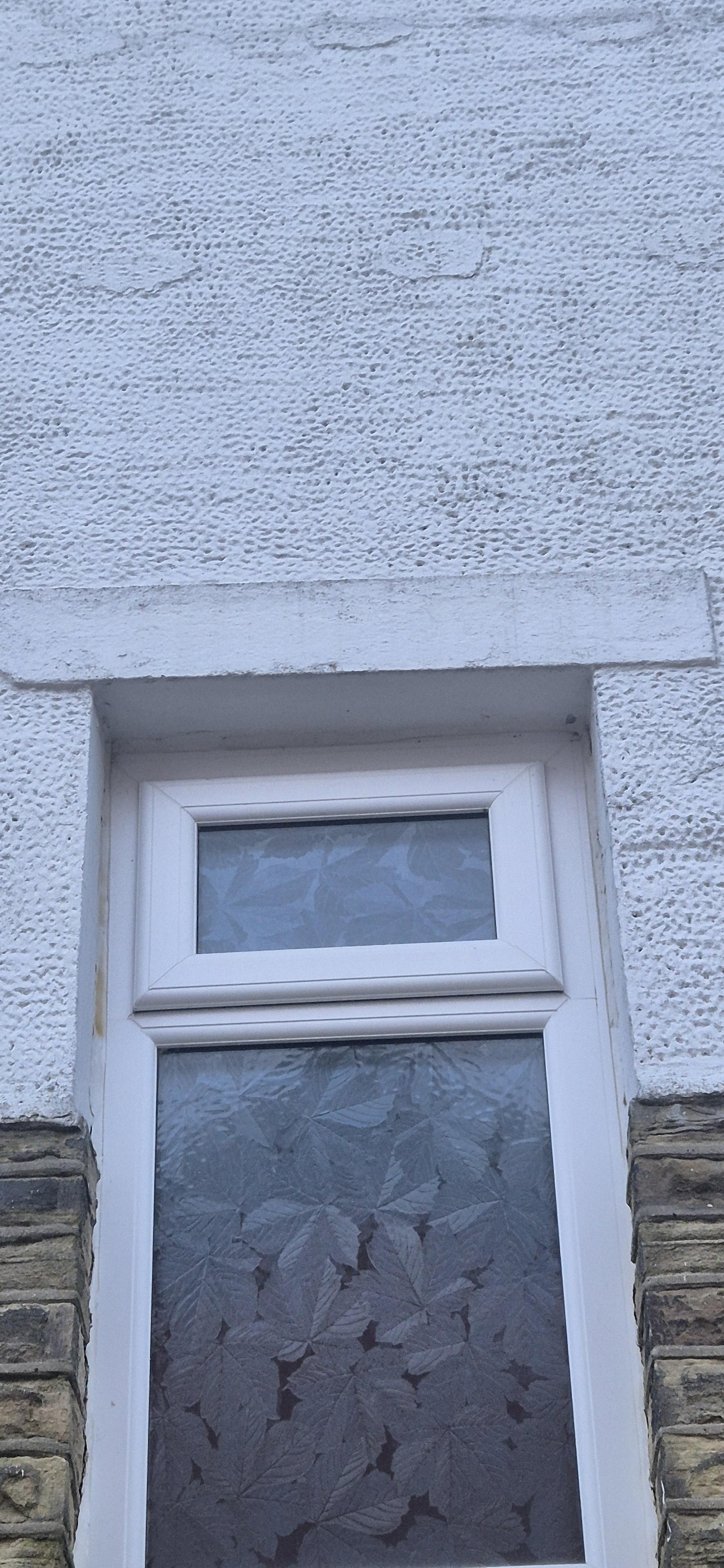

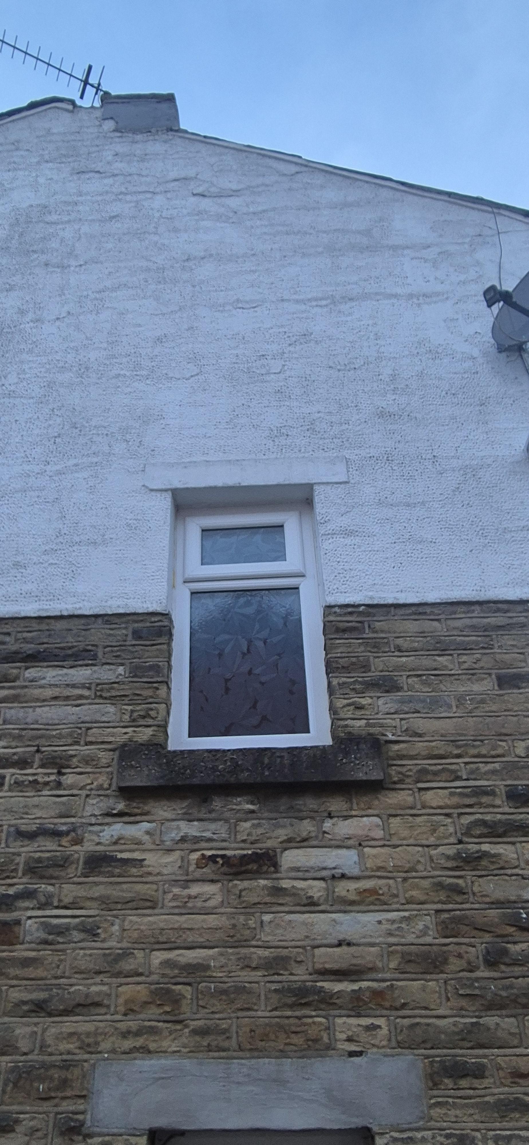

  3. @Blooda Here's pictures of outside . I have a builder suggesting it needs a damp proof tray inserting above the window from the outside and it's a scaffolding job...sounds expensive 😭😅

  5. Yes I noticed this also when we've started taking paper off. I will get a better picture of the window tonight and will try zoom in above the lintel as I don't have ladders tall enough at home to get up there right now. Thank you @Blooda

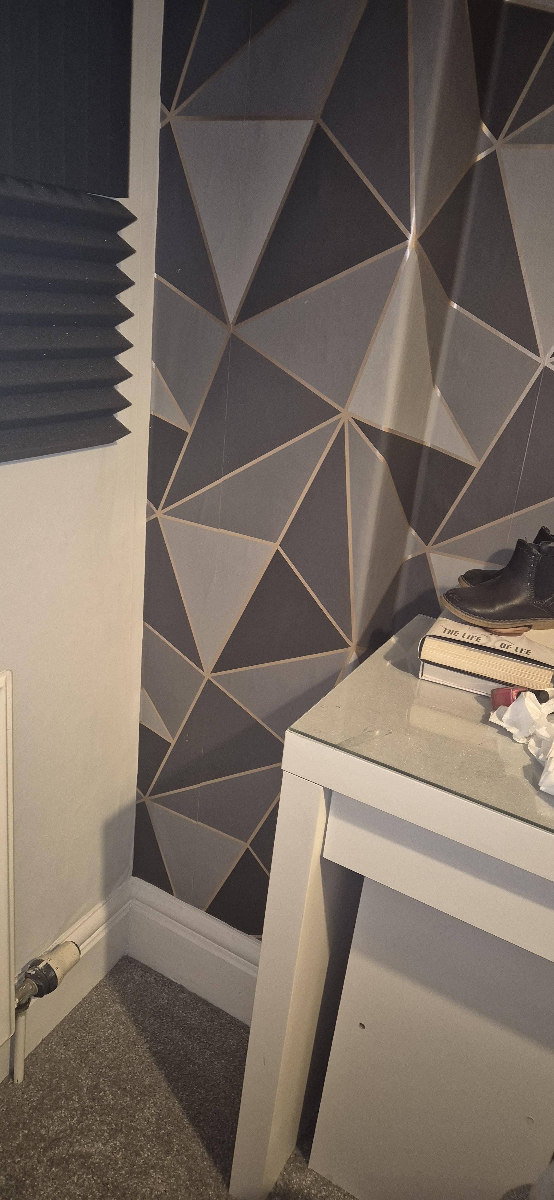

  6. Hi. Yes the chimney is out of use and I've had 2 people look at it. The render was cracked on it when we moved it it was painted with some kind of weather proof lead paint (I'm probably saying the wrong wording but I trust the person who did this) Then when another builder friend looked at it for us, he got up on a ladder and stood on the chimney to show us it had been capped off and covered so nothing should be getting it it. The problem is the darkness if it hasn't changed since we've uncovered it. It hasn't got darker again with the weather we've had is what I mean. @Iceverge
  7. Thank you for your reply. The house is around 1920s. I would imagine the render is cementious but I'm honestly not sure. Was already rendered when we moved in 5 years ago. I can't see anything from the floor but I need to get a ladder to get up and have a closer look at the external wall to check then to see if this is the case.
  8. Thank you for your reply. It is the highest window on the side of the house. The small one at the bottom is under the steps (under this window) We did have this wall coated a few years ago with weather proof paint for external use, but I don't know what the builder used. Will keep this brand in mind.

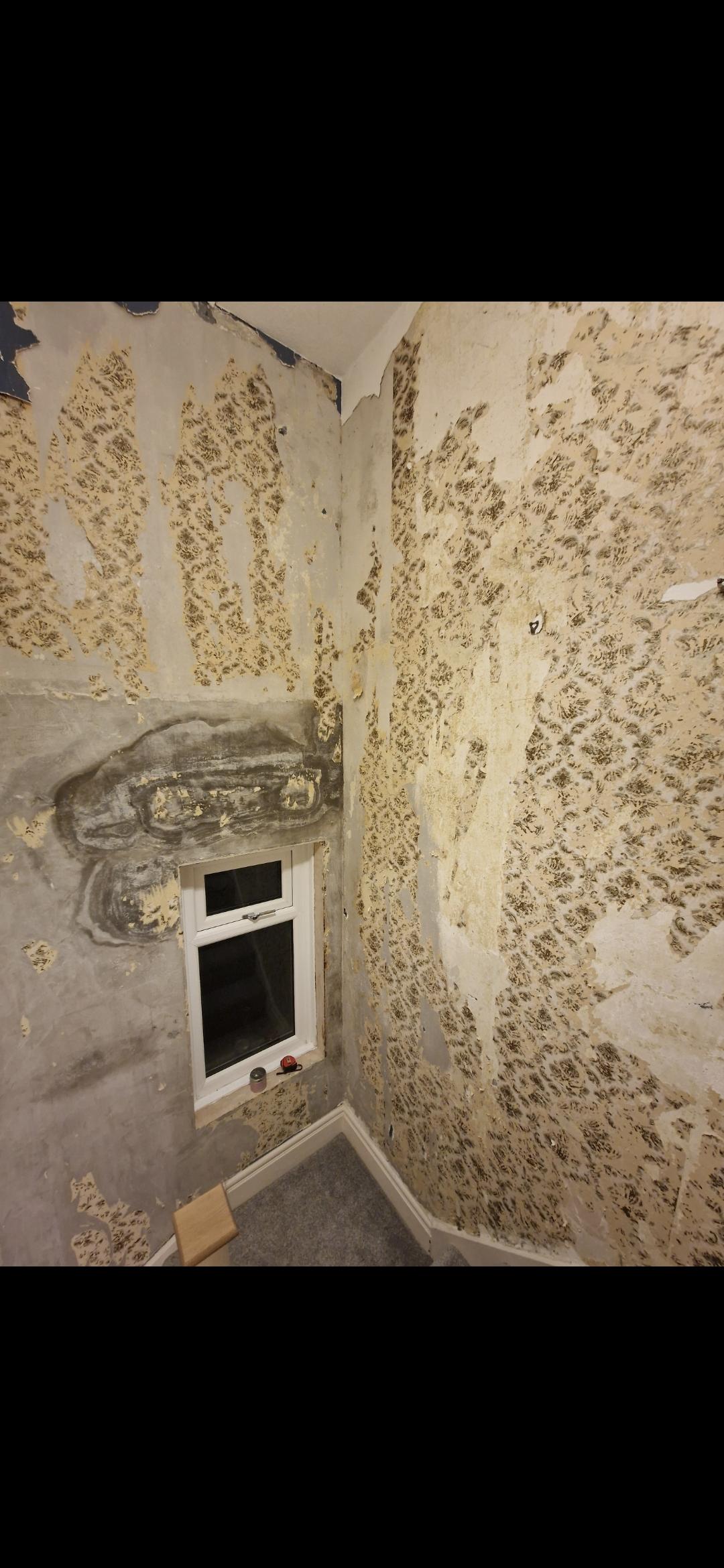

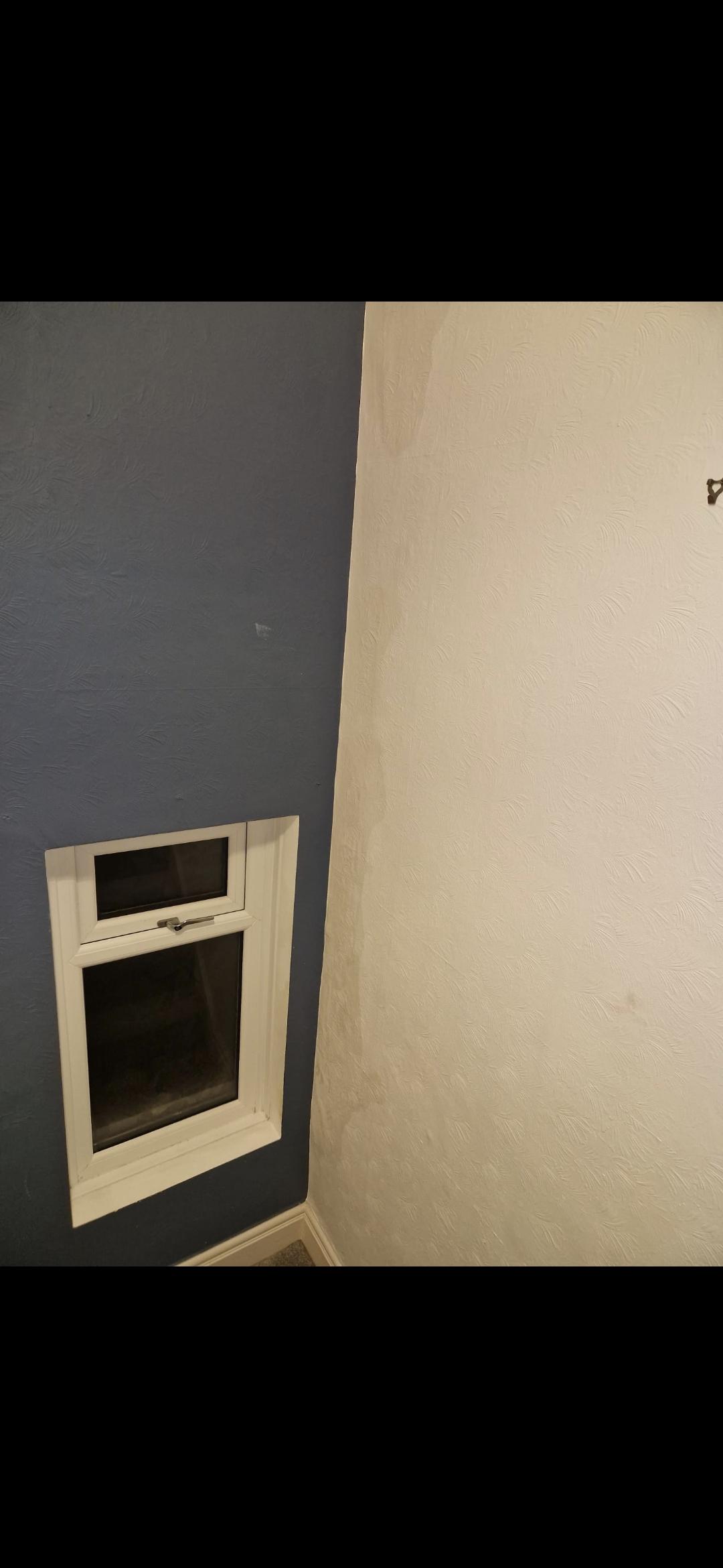

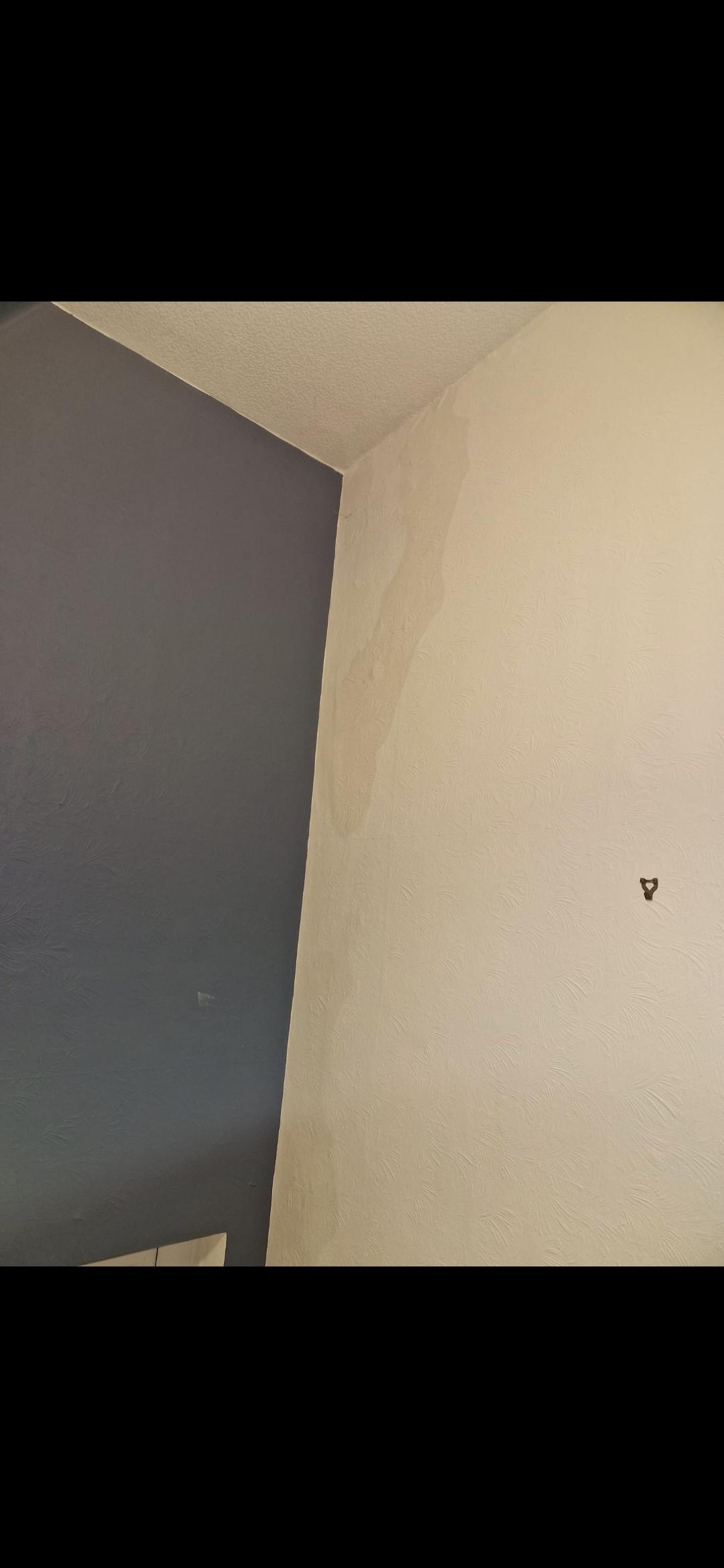

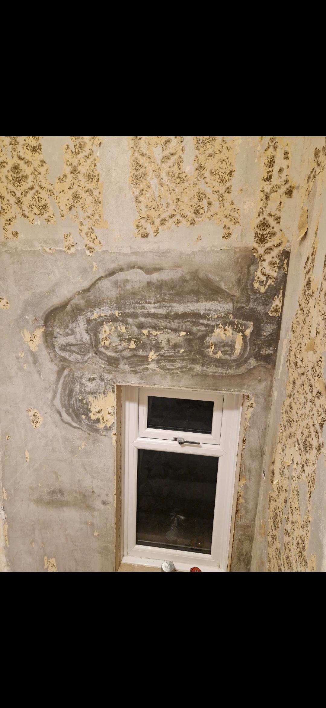

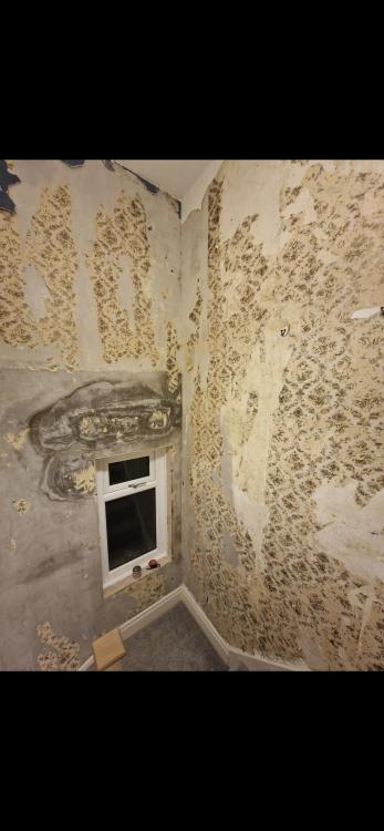

  9. We have a window in our stairwell area and we are redecorating the whole stairs, hall and landing. When we took the paper off we've discovered a dark pattern above the window. There were "salt crystals" on the surface in the days after removing the paper and then I noticed more again after doing some more stripping with the steamer. It does seem to have got lighter ,but hasn't got darker again with rain we've had. I've asked a few damp companies to come take a look for me but noone helping so far. A builder friend said it could just be a cold spot on the lintel? Any ideas or tips please? We are wanting to re-plaster once all paper is off so we can just paint rather than wallpaper. We have a semi and this is the end and it's rendered on the outside of the house from the half way up this window.
