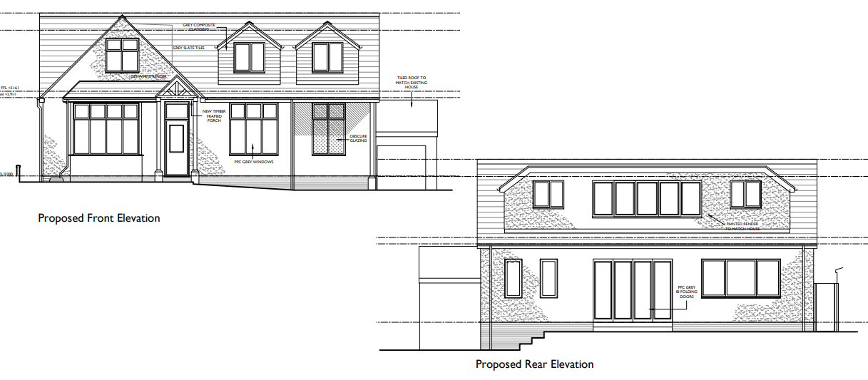

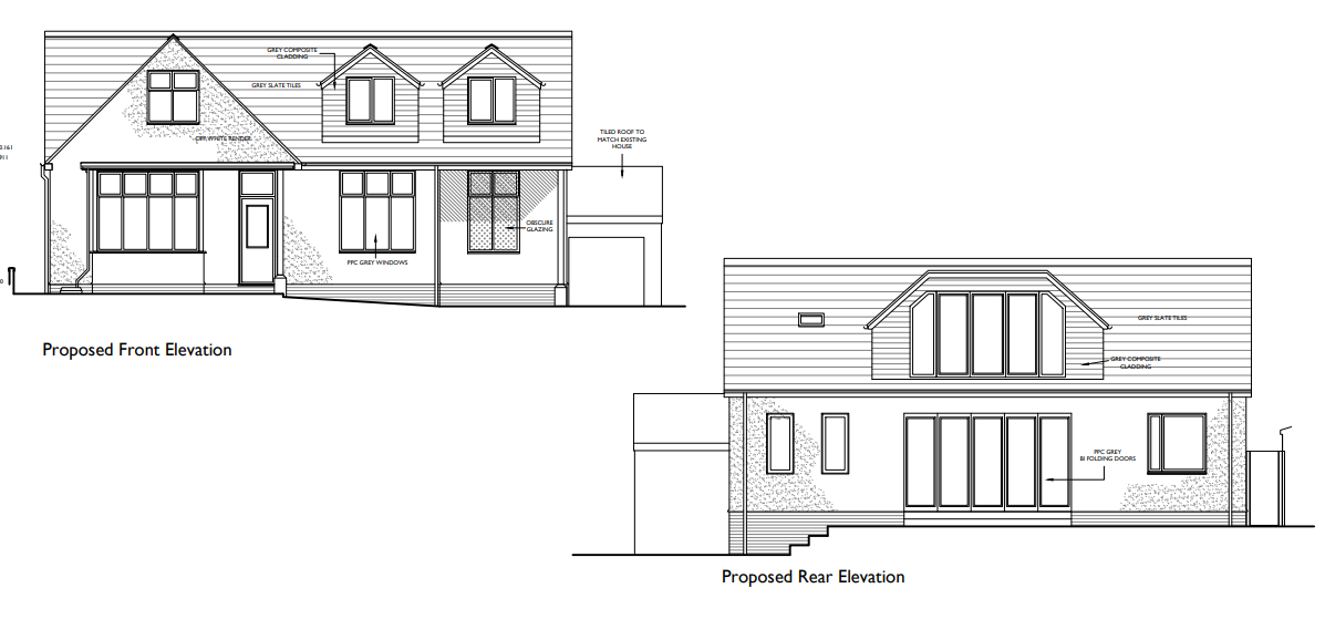

  3. We applied for planning permission for some significant improvements to our 1920s bungalow located in the South West under the jurisdiction of North Somerset Local Authority. Our proposal was to demolish an existing garage and shed along with an rear single storey extension and gable ended loft conversion. we have had a couple of iterations of plans of which were both approved without very many conditions. Our refused plans only contained one difference; which was the size of the rear dormer on the property. All else being the same bar a few cosmetic change re window sizes and materials which we were open to change. [Pictures below] The only reason stated for the refusal is as follows: "The proposed development, by reason of its height, scale, shape, form and design will result in an enlarged and top heavy roof, particularly by virtue of the rear dormer, that will be conspicuous and out of keeping with the existing property and it will be harmful to the street scene. This is contrary to policy CS12 of the North Somerset Core Strategy, policies DM32 and DM38 of the North Somerset Sites and Policies Plan (Part 1) and the North Somerset Residential Design Guide SPD (Section 2: Appearance and Character of house extensions and alterations)." The officers report further states the below: "It is noted that there are a few rear dormers along the street, but none of which (that are of a comparable scale to the proposed) were approved by North Somerset Council. Also, the presence of other dormers is not justification to continue a pattern of unacceptable design. The proposed dormer runs almost the entire length and height of the proposed roof and dominates the roof slope due to its width, height and depth. It is considered out of scale with the buildings’ proposed proportions, giving the building a top-heavy appearance. A dismissed appeal for a similar scheme can be found in Appendix A at the end of this report. Per the below images, the existing property is highly prominent from the adjacent road so the proposed dormer would be a visually intrusive feature in the street scene. The proposal would, therefore, conflict with the requirements on Policy DM38 of the Sites and Policies Plan and the guidance within the RDG2." Approved Elevations: Refused Elevations: We had a new planner appointed as the previous one left during the middle of the consultation period who made no attempt to communicate with our architect despite numerous attempts or give us the opportunity to revise/change the plans to something more acceptable. The decision notice also included in its appendix reference to an appeal at the same LA for a dismissed appeal under similar grounds. Is there any merit in appealing? Does anyone know the cost implications? Is this something that I could submit myself? Thank you in advance!
