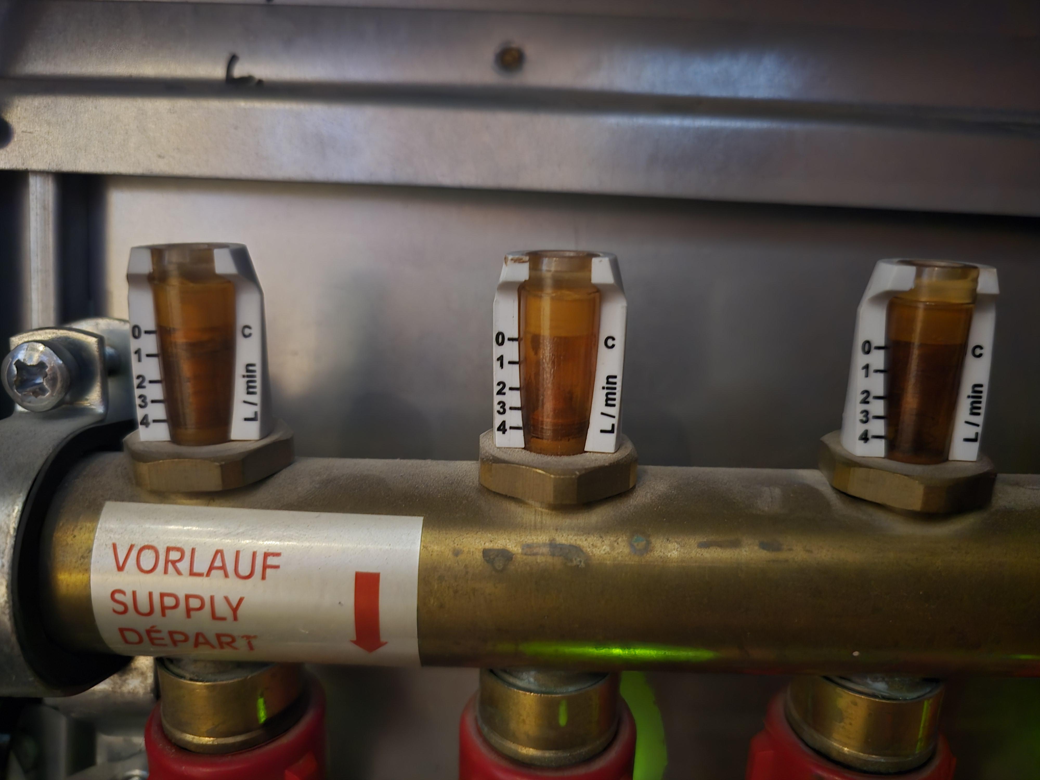

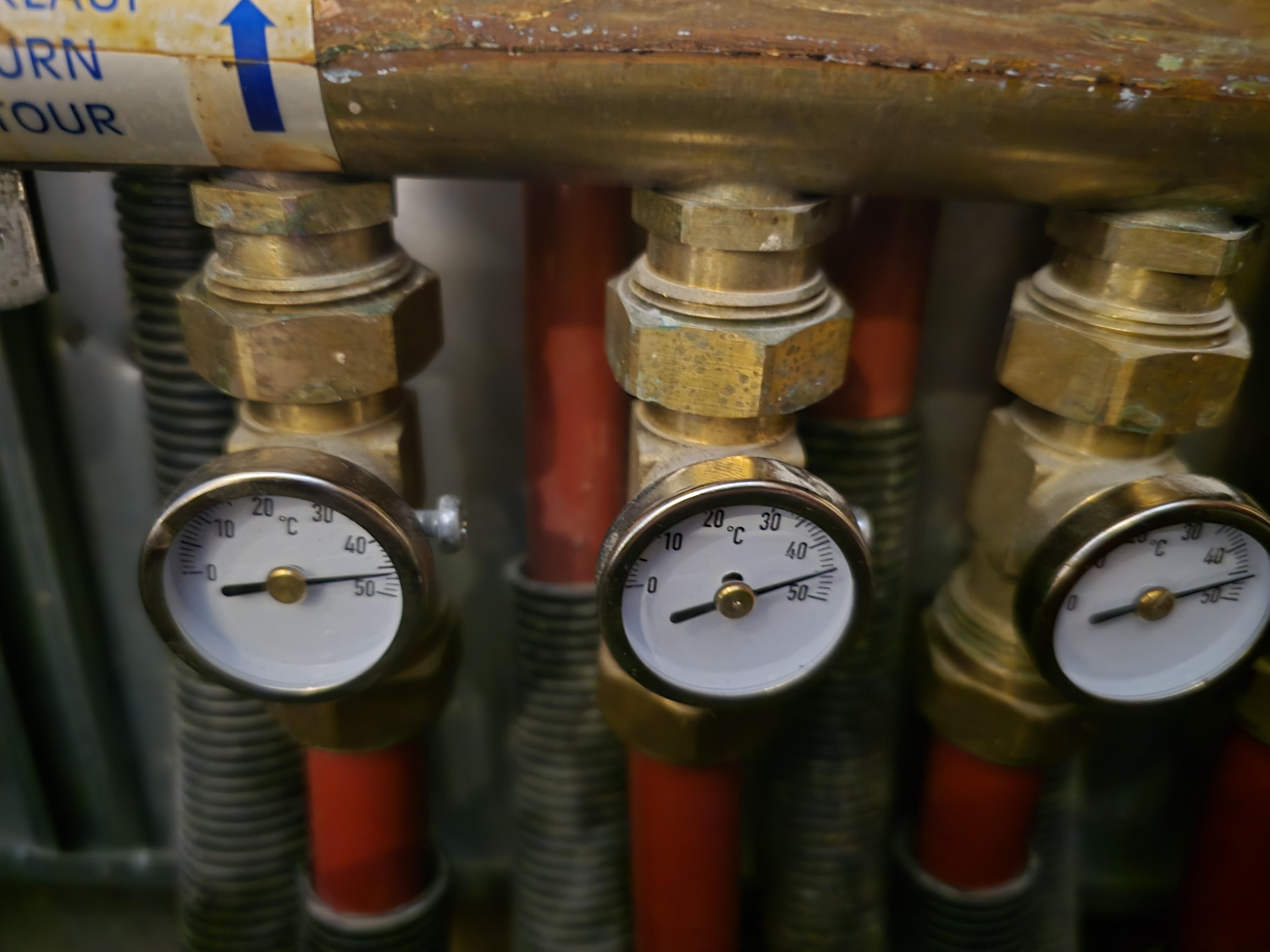

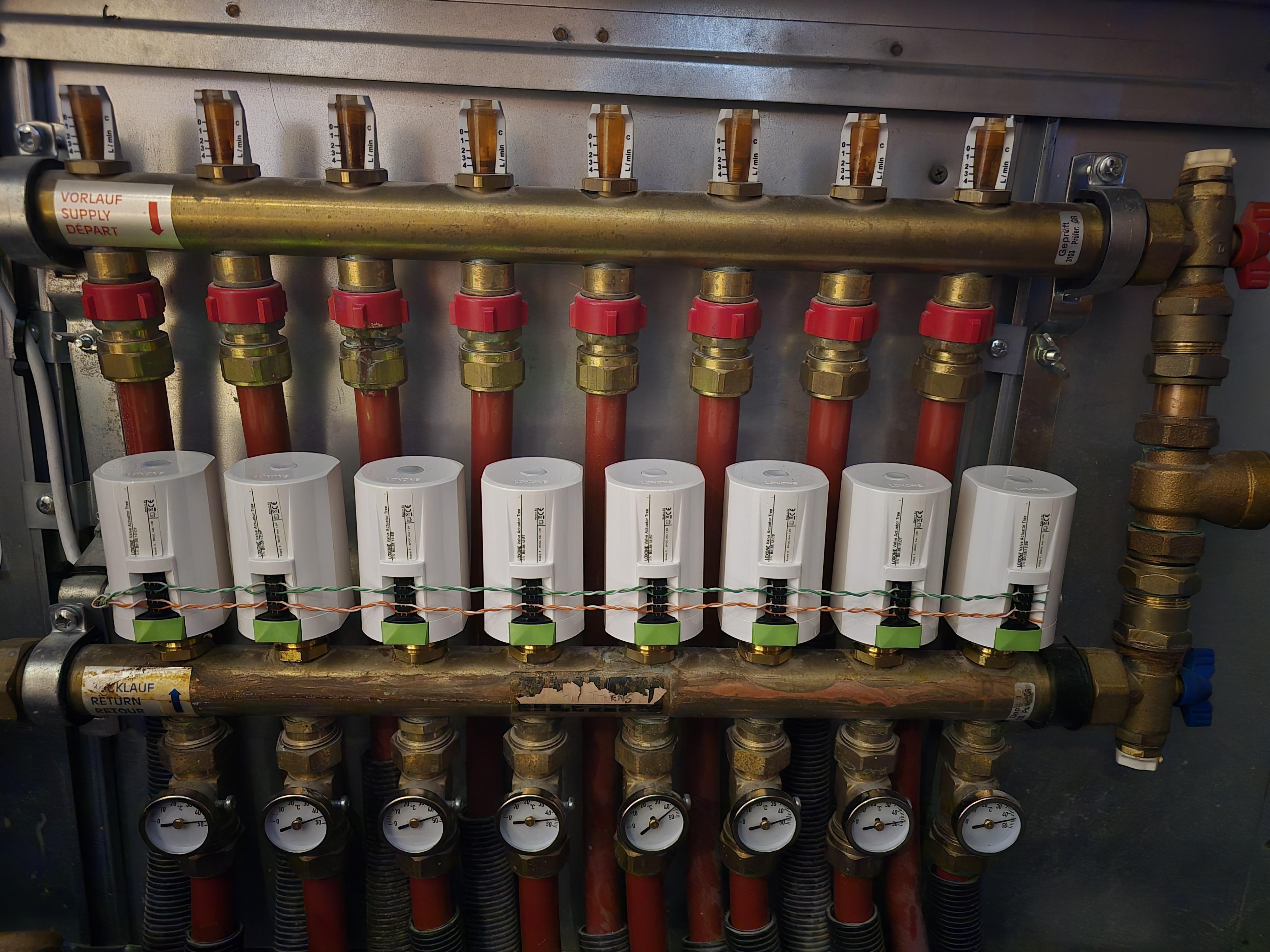

pauld70's Achievements

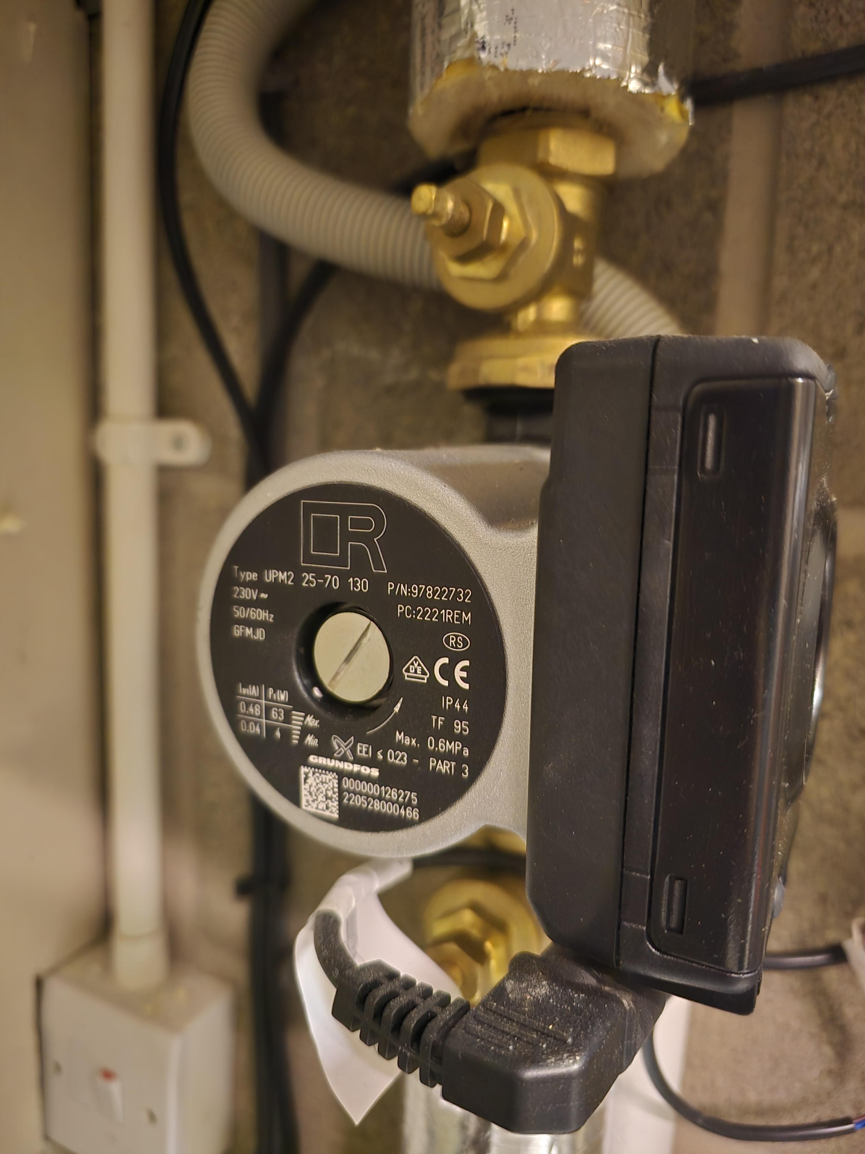

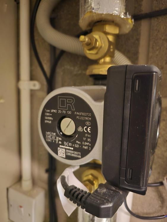

  2. guys some feedback, there is no air in the system and the pump is modulating the boiler

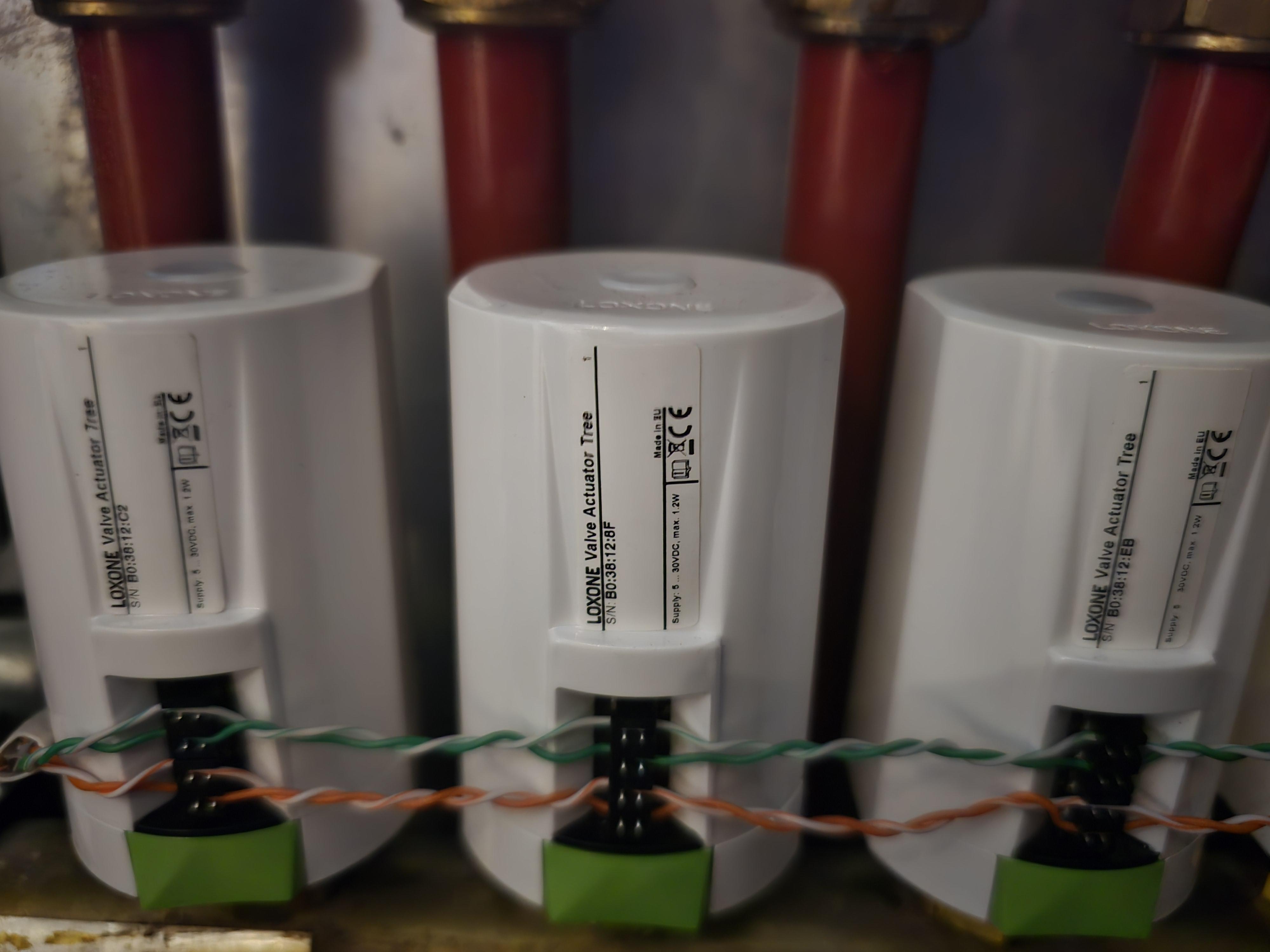

  5. Lights flashing shouldn't be an issue just loxone showing the state of the system. LED states↑ Please note that the status LEDs do not light up while the actuator is moving. LED state Description RED with short interruptions No communication to Miniserver possible. Please check the wiring. ORANGE on with short intervals Tree Device was detected on Tree bus, but is not paired with Miniserver. GREEN 3 short flashes Communication OK, device paired. RED blinking Online, valve open more than 90%. ORANGE blinking Online, valve open between 10% - 90%. GREEN blinking Online, valve less than 10% open. RED rapid flashing The error "valve stuck" or "no valve detected" is present. Please check the valve pin, it should be easily movable.
