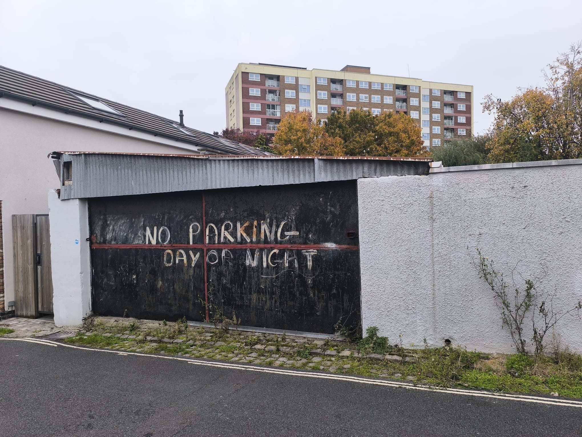

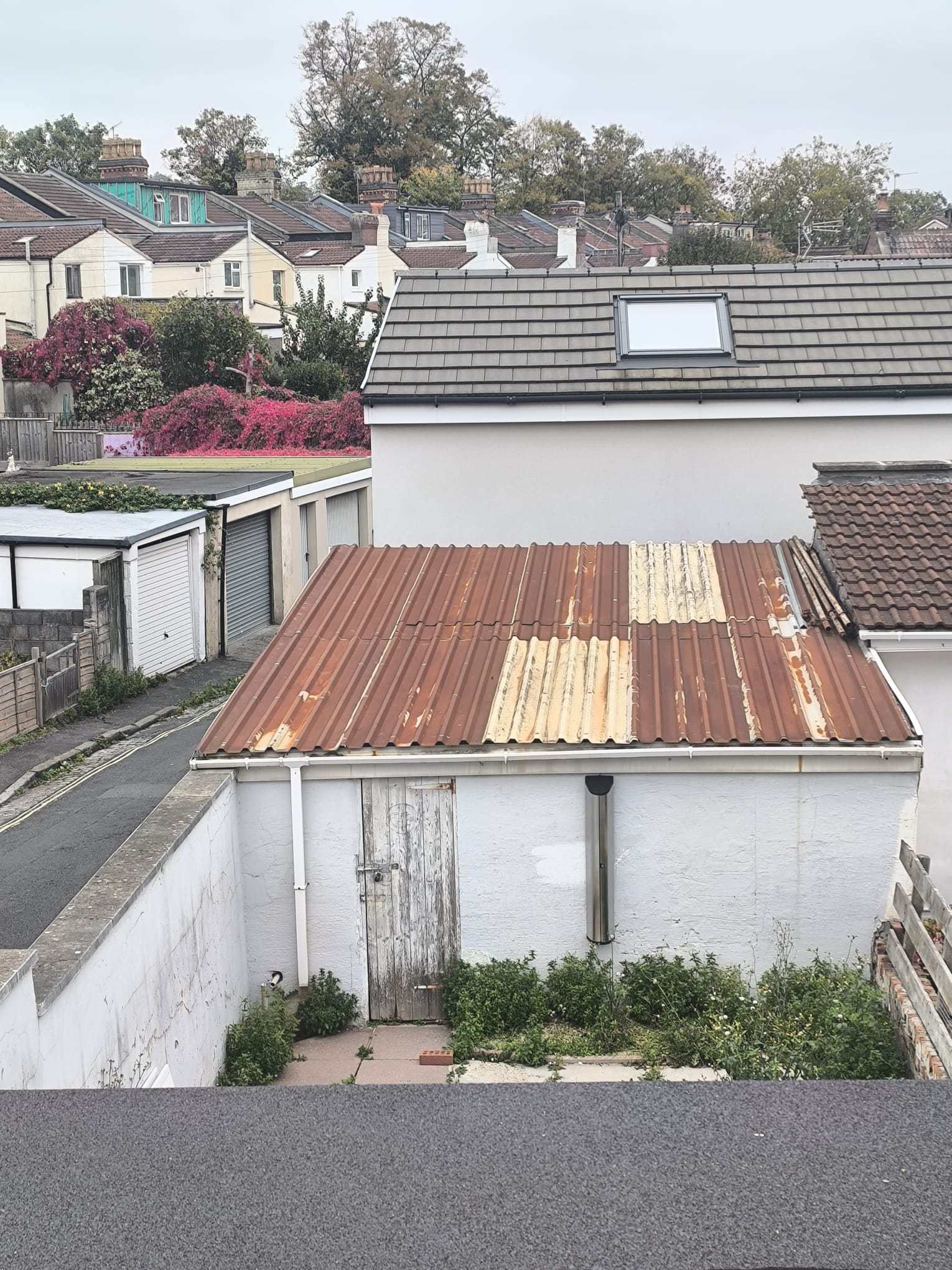

  2. Hello! I have a detached garage with a door and roof that need replacing. The garage was built around 40 years ago without planning permission and became lawful under the discontinued 4 year rule. The garden rests on a boundary wall with the highway on one side elevation, neighbor party wall on the other side elevation, back elevation onto an unclaimed sliver of land and front elevation to my garden. I would like to replace the door for a similar looking motor operated one and the same for the roof, keeping it mono pitched, replacing the structure of the roof and putting metal sheets. My main question is, given that I'd be doing a like for like replacement of a structure that has become lawful, can I undertake my proposed works? Thanks to all in advance.
