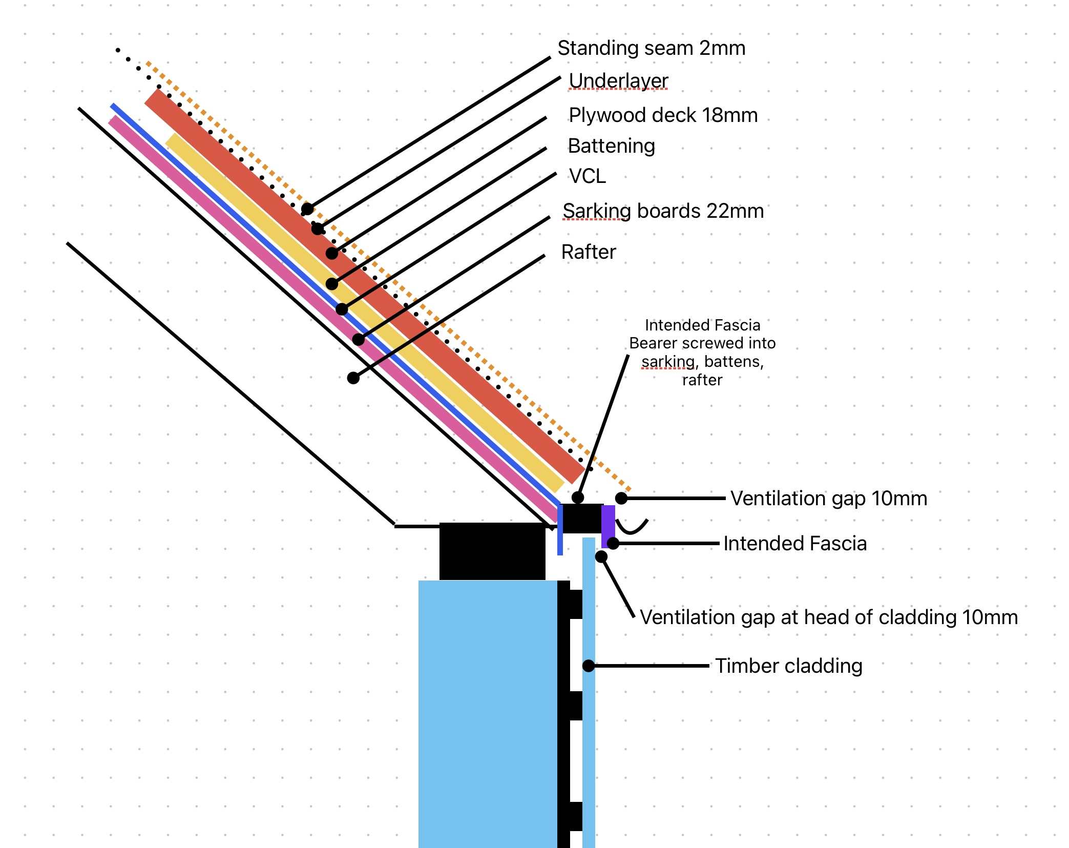

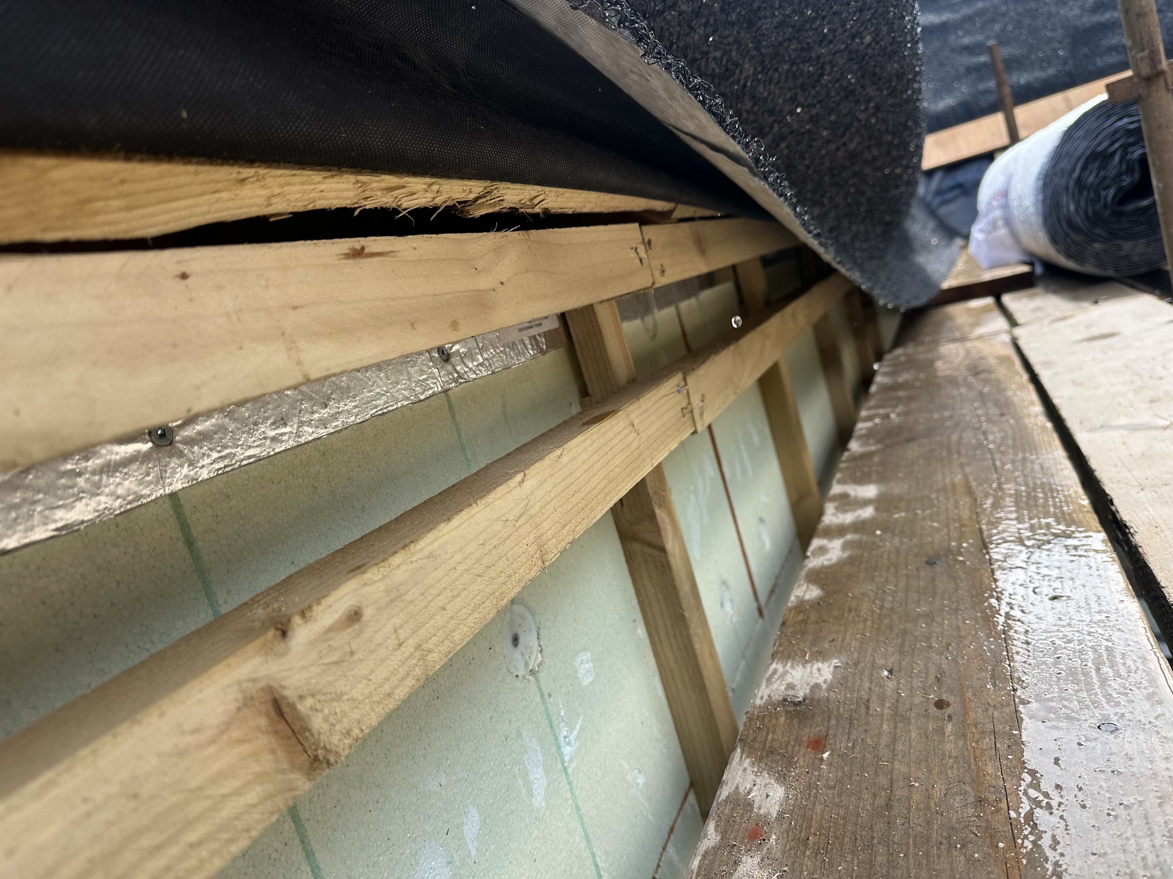

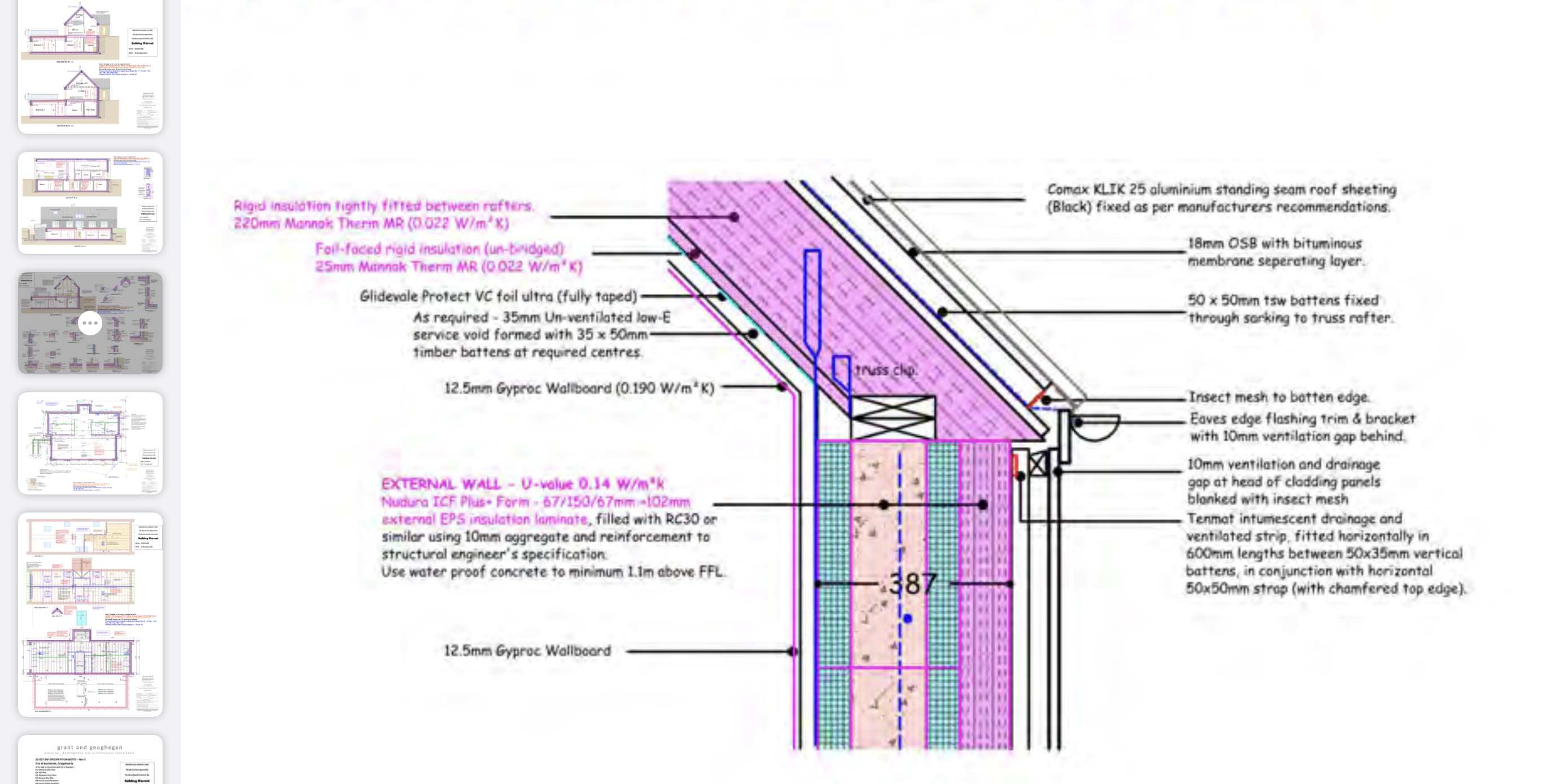

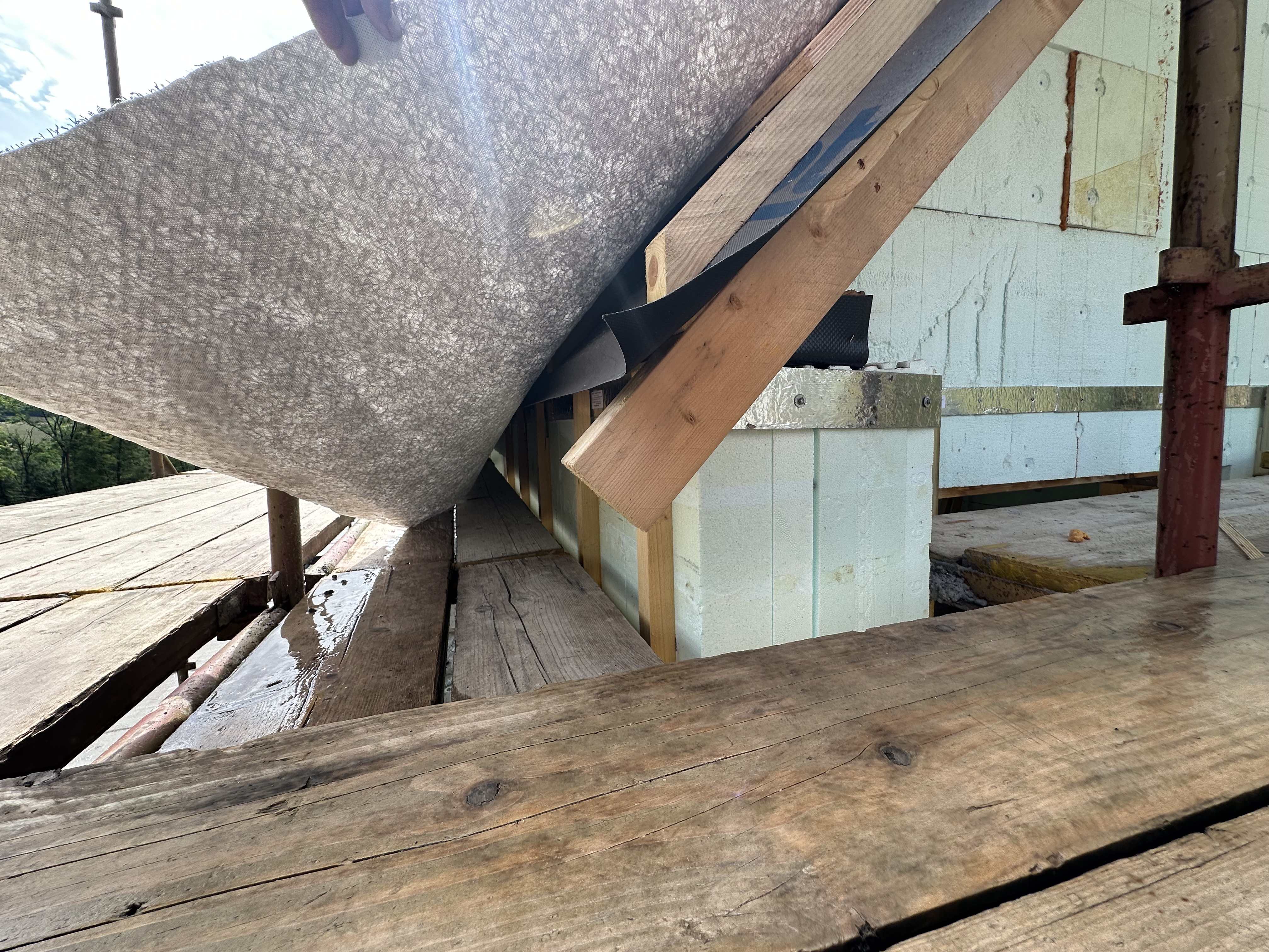

  1. Hi everyone, My joiner/roofer is 90% through installing the timbers in my cut n pitch roof. I have an ICF wall construction with a double wall-plate onto Rafters, timber sarking, VCL, counter battens, plywood deck and a underlayment which will support an aluminium standing seam. My query/question is around the eaves, fascia board detail. As you’ll see my architect has supplied a detail which shows the Fascia board ‘floating’ to the side of the rafter ends. My joiner wants to add a timber strip (fascia bearer) to the ends of the rafters to screw the fascia board to. However I also have timber cladding coming up behind this fascia board… So I believe I need to 10mm ventilation gap at the head of the cladding (behind the fascia board) and also provide a ventilation gap at the fascia board to the battens which goes into the roof layer. My cladding will come up the wall and also tuck behind my fascia board. should the timber fascia bearer be a continual length of timber along the roof edge (I’m worried this will block off the roof ventilation gap) or should it be blocks of timber (that don’t block the 550mm spacing of the battens and maintain the ventilation space between the VCL and plywood deck, which extends under the fascia board/soffit. ive attached pictures of my architects detail and also a site picture of the roof end, as currently constructed, note we’ve changed the 18mm OSB to a 18mm WBP ply. I’d normally ask my architect but they’ve retired now .. How should the roof end be finished? Should the VCL go under the fascia bearer timber or over and into the guttering? Will a continual fascia bearer block my ventilation? Should the standing seam roof extend past the plywood deck to reach the guttering (unsupported for that length)? Should the plywood deck extend past the end of the fascia bearer?
