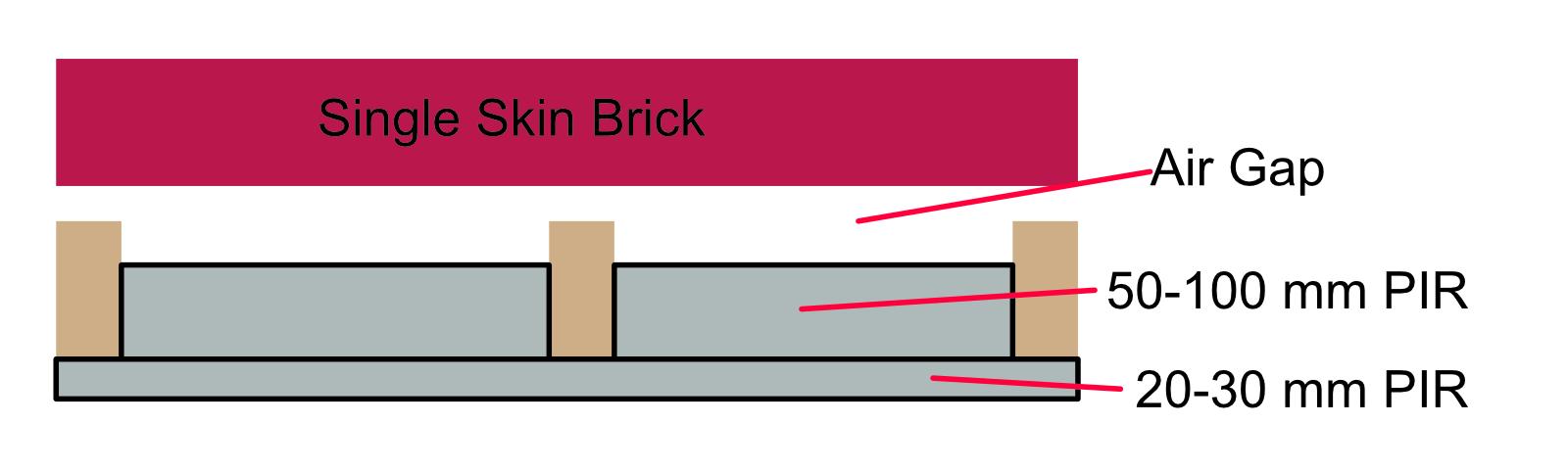

	Hello everyone I am in the middle of a Diy garage conversion - it's not a super high-end conversion, we just want a nice insulated box to use as a workshop/office - The total cost is going to be around 3k, so not high-end in the slightest I've erected stud work all around and on one wall the air gap between the stud work and the single brick wall is pretty large - it's like this wall has some larger brick supports that protrude out to around 100mm into the room. This means my stud work is approx 125mm away from the windows...and that's a pretty big gap My issue really is how best to do those - I could obviously just fill the gap with (insulated) plasterboard, but I do worry about the size that its got to cover and worry about how little support it might have. But perhaps im overthinking it? Anyway, I've attached a diagram of how I might plan todo this, and I just wanted to do to hear some thoughts really. I

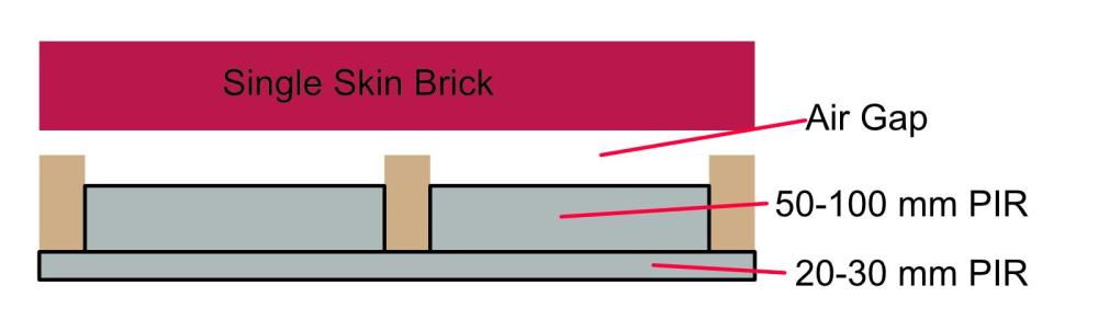

	Hi everyone, Im in the process of converting one-half of a single-skin double garage into an office and workshop. It's all pretty simple (in principle) but where I seem to be perpetually confused is the best way to tackle the insulation install. There seems to be so much info out there and so many ways to do it I'm a little lost in what is the best approach. My plan currently is as follows Build stud wall (easy) Install stud wall with an air gap behind (gap depths? No idea at the moment) Insert 1st layer of insulation board between batons Overlay 2nd insulation board over the previous insulation and batons resulting in one uninterrupted layer of insulation cover all gaps with aluminum tape to create a vapor barrier. Finish with plasterboard or OSB/MDF One thing I have noticed is the garage does have a few weep vents (or in my case just little holes in between the bricks) after the 4 walls are one, Ill be moving onto the floor and ceiling. so with that, can anyone tell me of this is or is not a good approach, or whatever? cheers!
