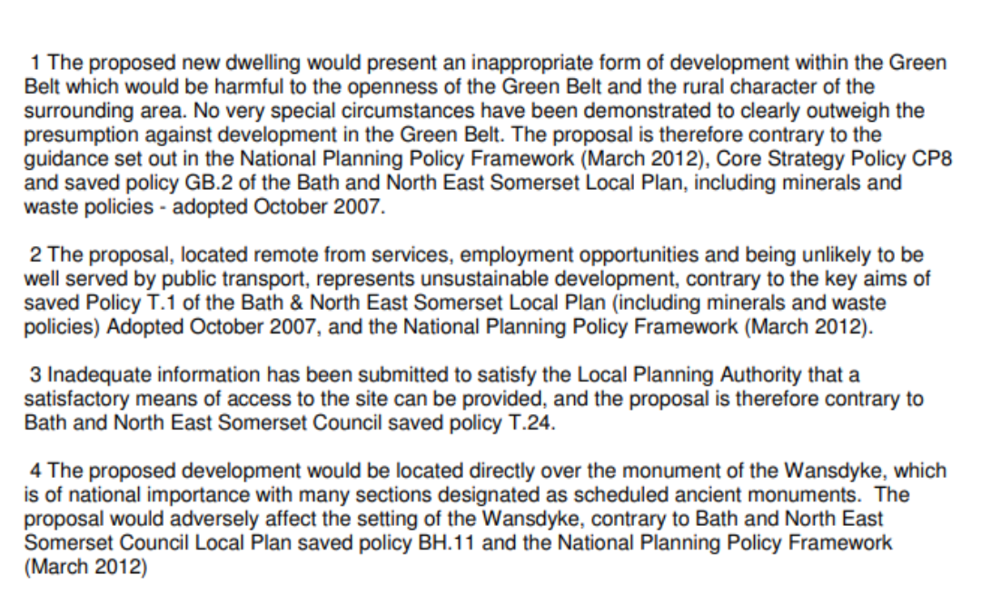

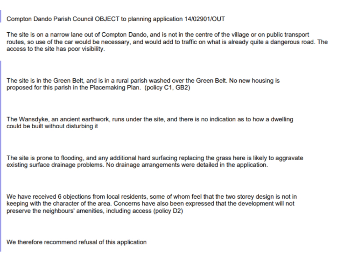

  1. Yeah I would only go for it at a reduced priced than it's currently on for due to the risk. It's currently listed as agricultural. Here are the reasons from the report why it fell through. There is a Roman earthworks that runs through the north of the plot which is what they were refering to this scheduled monument - which is another reason for failure as they were building directly on top of it. I understand that this would require an archaeological banksman most likely on site to mitigate this problem but at least it's not being built on top of it around 50m away - the monument is also not visible it's buried. The aim is not to disturb the monument unless we need access to that water connection. Which could be avoided if it's a deal-breaker. See the attached images for the decision and response.

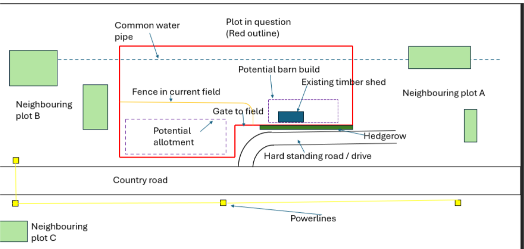

  2. So I've been looking into a plot that sits in a greenbelt but it's located in a village, and the plot sits between two properties to the east and west and one to the north. Previous planning permission was denied but the owner did not plan very well and didn't bother to match the character of buildings around. There already is a small timber shed that sits behind a hedgerow that you can just about see the roof of from the road. I wanted to build a low energy home barn style single story home matching the brickwork of the village buildings. To keep the low profile build so it doesn't disturb over the hedgerow. Now I know the footprint is going to be bigger than the shed so it would probably get denied. I was wondering if adding an allotment that could be adjacent to the property and would be easily accessible and wouldn't not disturb the house count as an exemption. As the village currently has no allotment and is seeking more community activities. See the attached image. I have not purchased the land I am just spitballing ideas before making an offer. Do you think labours new grey belt legislation will aide this case ?
